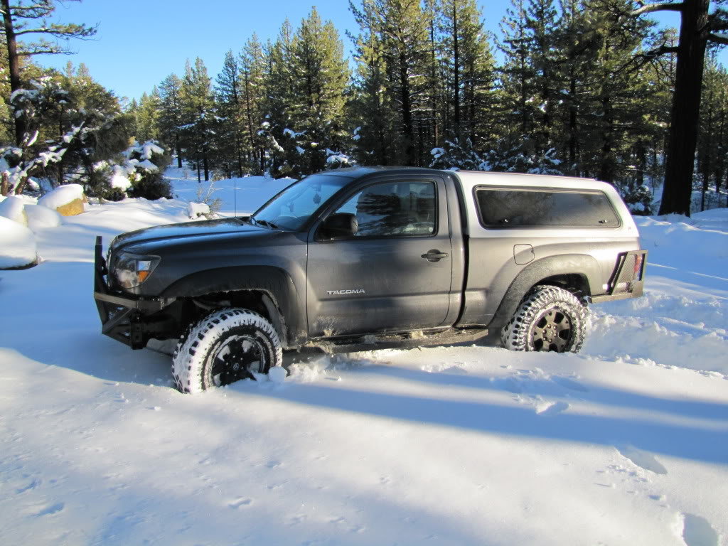

    it also kicks ass in deep snow!
    it will help in those NH winters where 4 lo is needed
    I also notice it helps reg cabs better, maybe since they are lighter it takes less to keep them moving

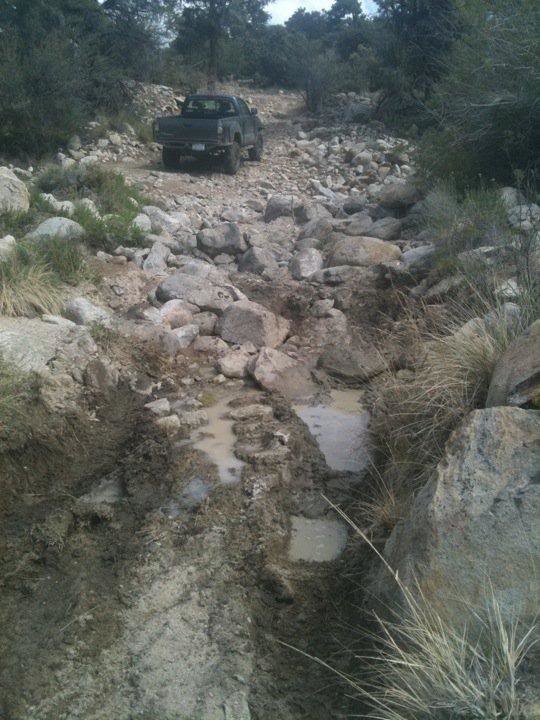

    Ive got a locker now but TRAC in 4lo has taken me so many crazy ass places
    http://www.youtube.com/watch?v=vu7Z3XNt5UQ
    http://www.youtube.com/watch?v=PV27EQMDfDY&feature=mfu_in_order&list=UL
    video is of this!
