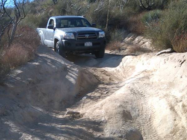

    never would have made it up this without the yellow wire mod

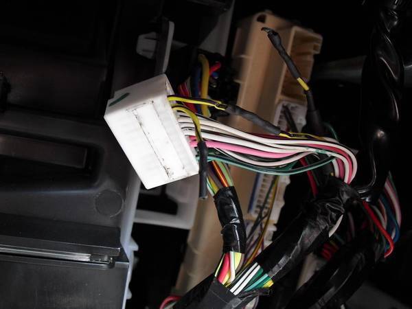

    This mod applies to 2009/10 non- ATRAC 4x4 tacomas.
    Behind the glove box is a computer module with five white plugs.
    The top of the top connector there are 2 yellow wires with black tracers. All tyou have to do is:
    1. Disconnect the Battery
    2. Un-plug the top connector and cut the secong wire down. The second wire is yellow with a thinner tracer than the top wire.
    3. Plug the connector back in and reconnect the battery
    4. now you have TRAC in 4lo.
    The way it works is it tricks your truck into thinking it is still in 4hi. The 4lo light blinks, however it is in 4lo. If the vehicle does not engage in 4lo the Buzzer will still chime.
    All the credit on this goes to ISTHATAHEMI for the original post. Im so exstatic about this i decided to take the pics and post them

    As you can see in my pictures i cut the top wire (not it) then repaired and heat shrink like new. the second wire down i cut then used heat shrink to insulate the wire ends

    I went off roading with a fj cruiser with ATRAC and we had similar results on the same hill. I slipped a little bit more than he did and i have stock dunlops vs. his BFG a/t kos. With this you just have to rev it a little bit more but not much.
