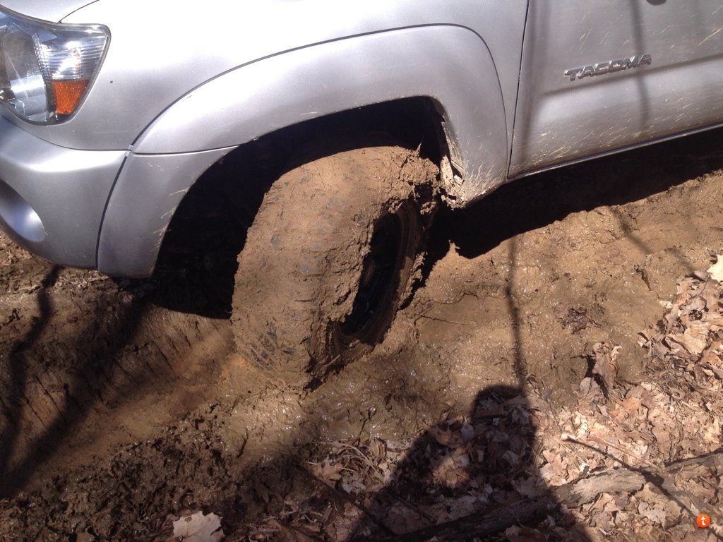

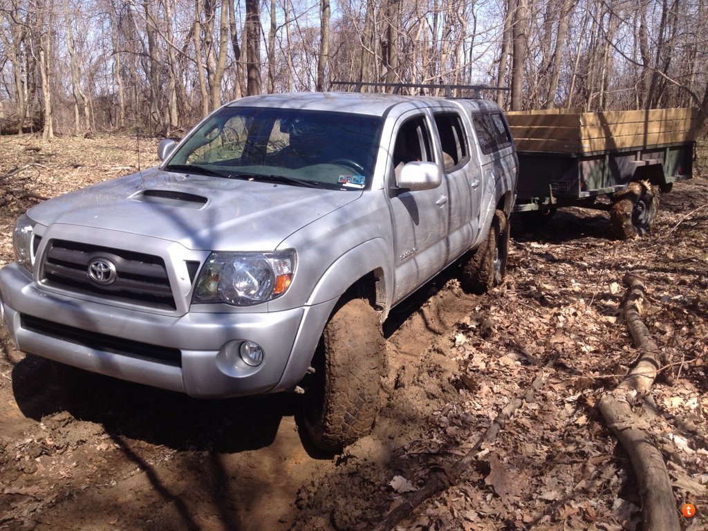

    Just curious, what are your experiences with the YWM in snow? I did the YWM yesterday and took it out to try in the snow. Four different times I tried starting in VERY limited traction situations and it did NOT get me out. Two times in 8-10" all 4 just dug myself deeper, then had to shovel my way out. Then twice on hard snow packed/icy hills. I would stop in the middle of the hill try to start from a stop. I would either just sit and spin or wheels would spin while I would slide backwards.
    I am pretty sure that I did the YWM correctly. When I was stuck in deep snow, the 4Lo light would blink, and I would watch the left rear tire spin, then stop and I could hear the right rear spin and it would go back and forth.
    Now, I am assuming my BFG AT's with 4/32's tread left didn't help the situation. I am long overdue for new tires. But that is a subject for another thread. :)
    So, two questions:
    1. What are your experiences in snow, either deep or hard packed?
    2. I am assuming I did it correct (I have limited mechanical experience)? Since in 4lo I saw the tire spin alternating from side to side. In the past, while I was in 4lo the tires would just spin.
    Just for the record. Disconnected battery. Pulled out first white clip of wires. I cut the second yellow wire (with the thin black line), and installed a switch that I attached to the inside of the glove box. My truck is 5+ years old and paid off so I am not worried about dealer and warranty. When I switch it off, the 4lo goes solid and tire just spins.

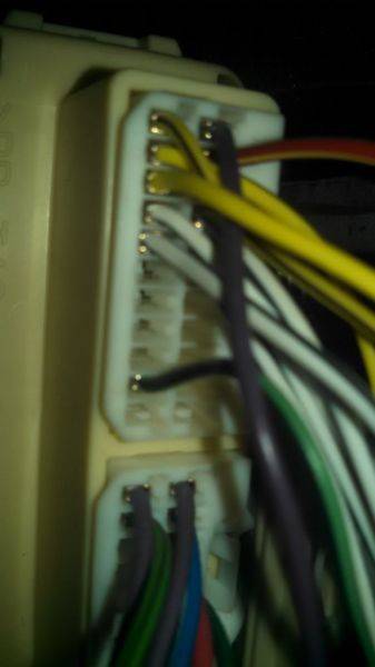

    Hey guys, I had the yellow wire mod done and working great but I just twin sticked my truck.
    Anyone have a wiring diagram to of where the yellow wire comes from before going into the computer? Also is the computer it goes into the traction control computer? Thanks in advance!
  12. May 31, 2014 at 7:26 PM
    #592
    Taco'09
    Taco'09 Well-Known Member
    Dec 31, 2008
    #12073
    1,877
    ^^Hard copies of the Electrical Wiring Diagram may still be available for earlier models with the 09+ wiring otherwise they have to be printed from Toy's TIS system. Otherwise, I have seen snipits of the page titled Multi Mode 4WD and Rear Differential Lock (4WD) have been printed several times here and there on TW.
    FWIW, I have systematically attempted many of the wiring hacks for L4 several years back and reattempted all them again recently. I have always wanted to get the VSC out as it would make the truck more capable in L4 (by eliminating the lurking VSC) but it always whacks the system when I have tried. I pretty much have given up on this as I suspect it is a programming matter that can't be hacked on our end.
    The yellow wire is a ground loop signal wire. From the point where it is being disconnected or "clipped" the wire continues directly to the 4WD ECU where it connects to Terminal 17 of the F13 Connector.
    On the other end of the disconnect it continues via several internal junctions to the T3 Transfer Indicator Switch (L4 Position). When this switch is engaged it then ground connects to 2 engine grounds.

    Where you cut the yellow wire (as shown in post 1) isn't the 4wd ecu though... Is it the traction control ecu? He 4wd ecu is above those, directly above the latch for the glovebox. I'm trying to figure out how that wire terminates, guess I'll have to bust out the multimeter :notsure:
  14. Jun 1, 2014 at 10:08 AM
    #594
    Taco'09
    Dec 31, 2008
    #12073
    1,877
    avw4X4, the Skid Control/Traction Control/ABS Control are part of a single module located inside the engine compartment.
    The pic you referenced is of Junction Box No. 2 and the topmost connector shown is the 22-pin PA connector.
    Terminal 22 of the PA connector connects with the same yellow/black wire to the 4WD ECU at terminal 17 of the F13 connector on the ECU. The F13 is the largest of the two connectors on the 4WD ECU.
    If you probe terminal 17 of the F13 connector on the 4WD ECU you should get continuity with both terminals 21, 22 of the PA connector, if not, the terminals are bridged underneath by a junction so make sure to account whether the yellow wire has been clipped or just disconnected.

    I am thinking of doing this. It sounds awesome and easy!
    Anyone have any problems afterwards?
    I looked behind the glove box and found the second yellow wire down. It has the black stripe. However, it is not thinner than the top one. Is this the correct wire?
    My plug looks different than the one shown in this thread. I have 2 columns of wires in this plug. Is it the second yellow wire down in the left collumn on this plug?
    I just want to be 100% sure before I go in there and cut. I have an 09 4x4 dcsb with the V6. No TRD or SR5.
    Thanks everyone!

    Yeah, second one down.
    Atleast for 2010...
    I also don't have that third yellow wire. Just cut it and see if it works, easy enough to put it back together.
