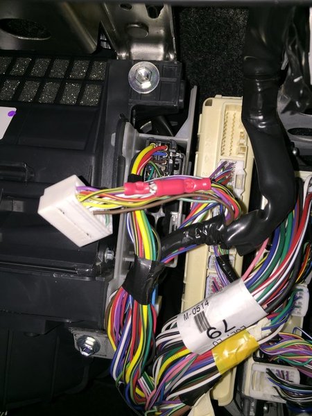

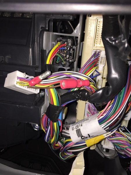

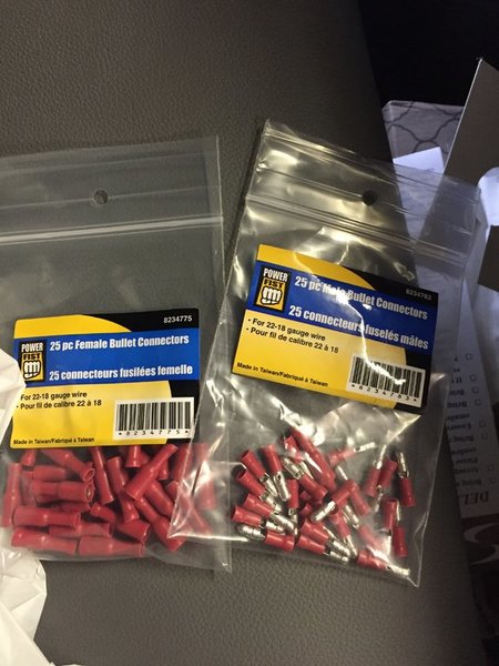

    Picked up some bullet connectors..
    Put a male connector on one end and a female on the other.. Then I put a dummy female end over the open connection (no pic showing that) to seal the open metal contact while its disconnected.
    If I need to restore it to the way it was I can just plug the wire back in..

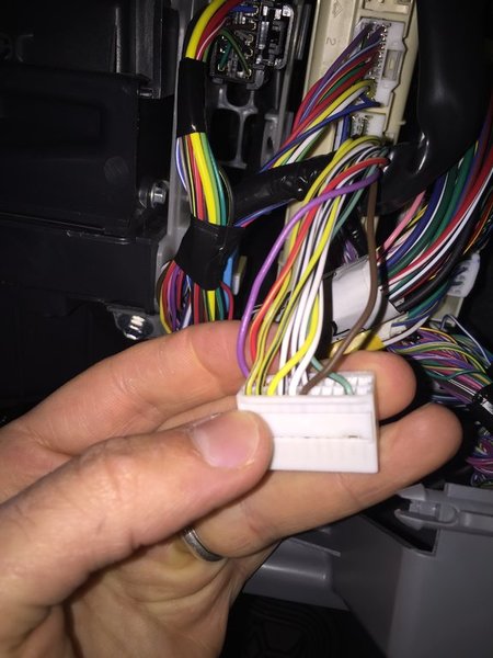

    heres a pic for reference from a 2015. The plug is the one on the very top (see where it pulled out from in the pic). Wire is the second yellow wire from the top..in my picture it has a thicker black tracer line but in earlier model year tacomas it could have the thin black tracer line. Either way it has always been the second yellow wire from the top.
    Does the yellow wire you cut have a black tracer line? If it's soild yellow, you may have pulled out the wrong plug to begin with.
