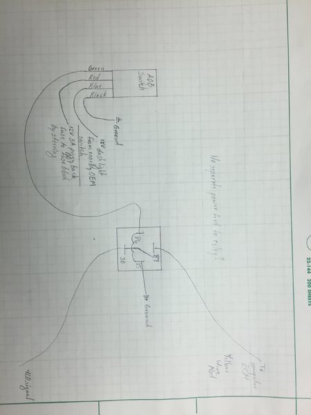

    Similar question - I got an AOB switch and a relay to perform this function, but am lost on how to wire it up for a simple open/close circuit. Do I even need a relay for this? Any input is greatly appreciated!

    Can you electrical guru's take a look at this schematic that I drew up to add an AOB switch for the yellow wire mod? I think it will work, but I'm not sure if I need dedicated power to the relay or if the 3 amp power to the switch through the green wire to relay is sufficient to activate the coil....
    IronPeak and hmsailor like this.

    its a nice added feature but doesnt this make it complicated since you can turn the trac on and off using the regular trac/alsd/vsc switch after the ywm?

    It might be, but I was thinking I would operate more often than not with 4low operating normally and wanted the signal intact with no flashing light.

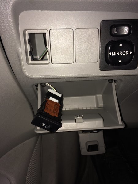

    will 2013 corolla LE trac switch serve as a 4lo atrac button?
    edit: its a 4 wire illuminated switch
    G.T. likes this.
