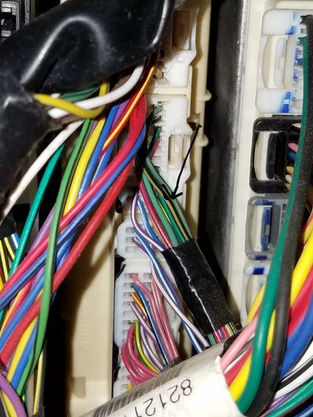

    See attached, yellow wire with black trace, snip from connector then run tap into a 12 v source and run to that wire. There are screenshots of which wire that feeds 12v in previous posts.

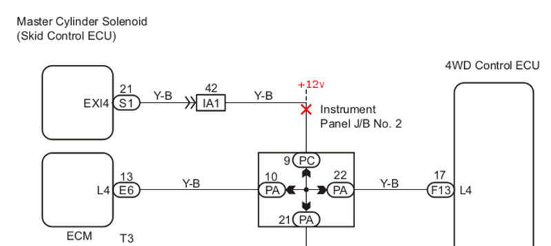

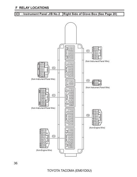

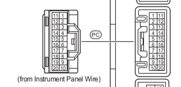

    I just want to add a little extra clarity to this method.
    Here's a full image of the PA-PF connector showing PC connector
    A close up of PC connector showing pin 9
    A Wiring diagram showing the interactions with 4wd and PC connector
    A closeup of the mod cut the wire going to PC-9 and tap the wire side to +12v Ign keyed power.
