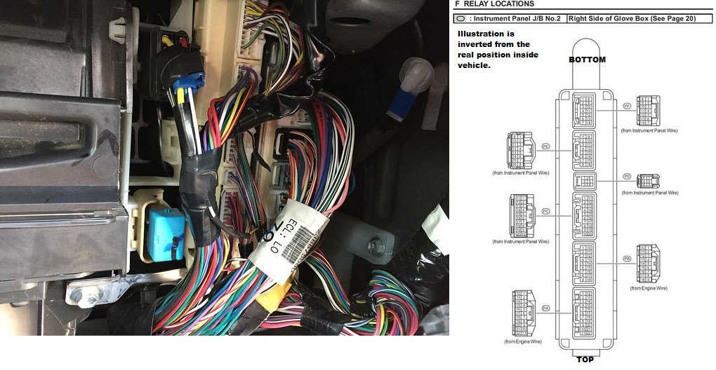

    Is that blue plastic clip on the top left a piercing wire tap?
    Is that where the pc-9 wire is running into the 12v source?

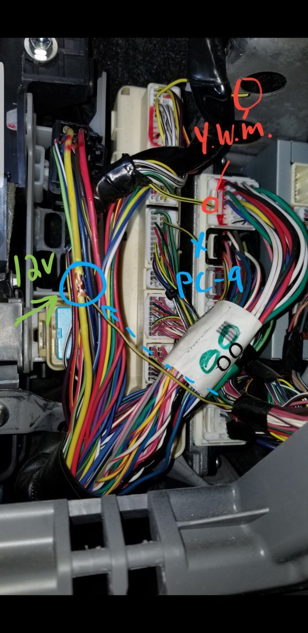

    Attempted the modified version of the
    yellow wire mod tonight. My 4lo light still flashes at me as if I had only done the original ywm. Can anyone tell from my attached photo what I did wrong here?? Thanks guys.
    jp_flynavy likes this.

    Since your doing the new mod, you need to reconnect the old mod you have marked as ywm. Make sure pc-9 is connected to a switched +12 source, and a 100 ohm resistor is recommended.
