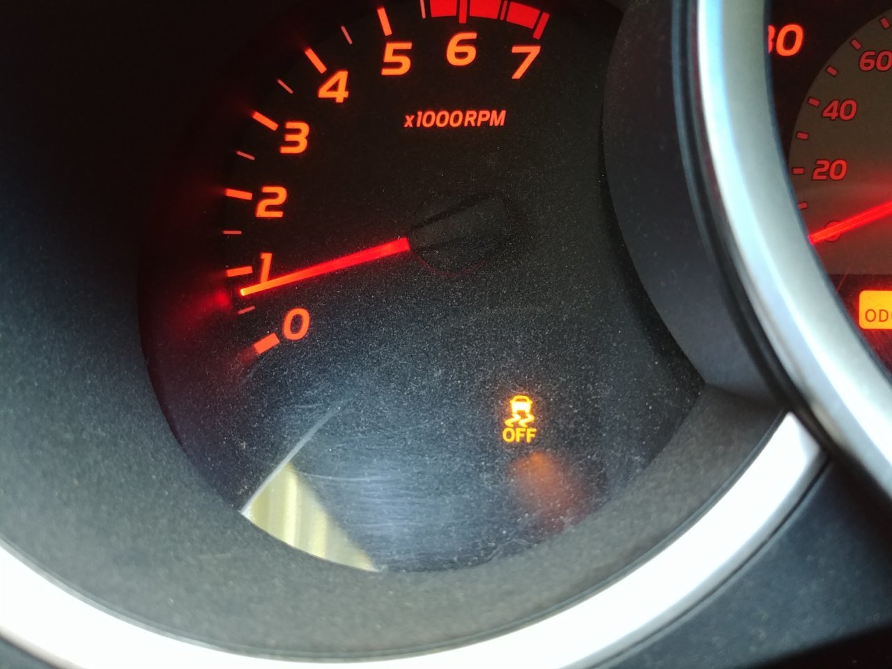

    I can see all the lights silhouettes while they're off. I don't even have a spot for TRAC OFF.
    No change after quick press in 4hi and 4lo
    Hold and I get what's in the picture in all modes.
    Quick press gives auto lsd in 2wd.

    My mistake, sorry. You do not get a "TRAC OFF" light, but according to your model year's manual (pages 191-193), you do indeed have TRAC and of course VSC, and the mod you've done also allows them to work in L4. When you do a quick press, you do turn off TRAC (which then allows brake modulation on slipping wheels only - engine regulation is disabled) even though there is no indicator. When the TRAC/VSC/DAC are actively working (you'd have to apply quite a bit of throttle in a low traction scenario to notice), you'll see the VSC light flash and I think the system will buzz at you.
    2011 Manual located here, as of 07/2019: https://www.toyota.com/t3Portal/document/om-s/OM35A34U/pdf/OM35A34U.pdf or https://www.toyota.com/t3Portal/document/om-s/OM35A58U/pdf/OM35A58U.pdf
    The TRAC OFF light apparently only started showing up in model year 2012, but the traction control modes behave the same.
    2012 Manual located here, as of 07/2019: https://www.toyota.com/t3Portal/document/om-s/OM35A48U/pdf/OM35A48U.pdf
