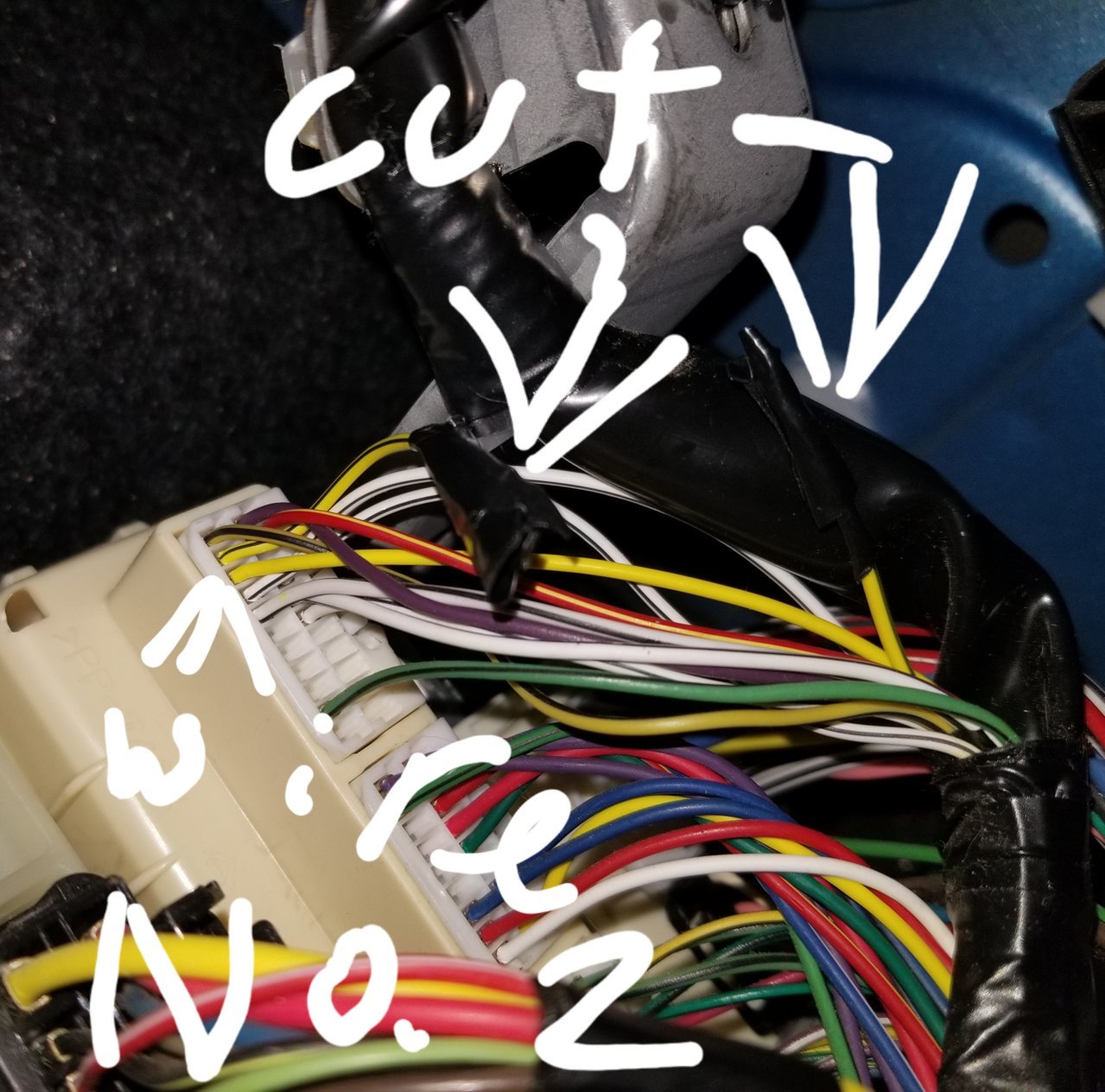

    Tried this mod today with a resistor & spdt switch and burned a ign fuse shifter locked out airbag and abs light came on here's a picture of how i wired it up thinking that's how it went did i miss something?

    I have a manual trans so I am not concerned with shifting patterns. Would there be any reason to do the more complicated version with 12v other than to not have a blinking 4lo light? Clipping one wire and cleaning it up with heat shrink sounds way more appealing.

    I think there's a special screwdriver you can use to just unplug the wire. Maybe find one of those and just pull it from the connector. If you have to reverse it for any reason you won't have to splice/solder

    Yeah that’s a good idea. I’ll try with a jeweler flathead

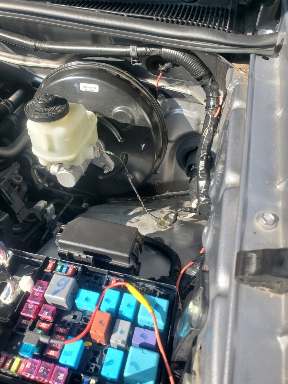

    Just did original YWM today and it went uneventful. First I disconnected the negative lead then the positive lead. Pulled the glove box off and unplugged the connector and tried to take the wire out with a glasses repair kit screw driver with no luck so I just went and cut it and taped the wire ends. I then went and plugged it back in, connected the positive then negative, went and started the truck, shifted it into neutral then 4low and the 4low indicator flashed with no beeping so I know I did it right. Heres a picture of my work. 20211207_170902.jpg
    I have not needed to use 4low since I got the truck in June of 2020 but I would rather have it and never need it than need it and not have it. Besides it is easy so I thought why not. I might need to find a hill this winter and give it a try:D

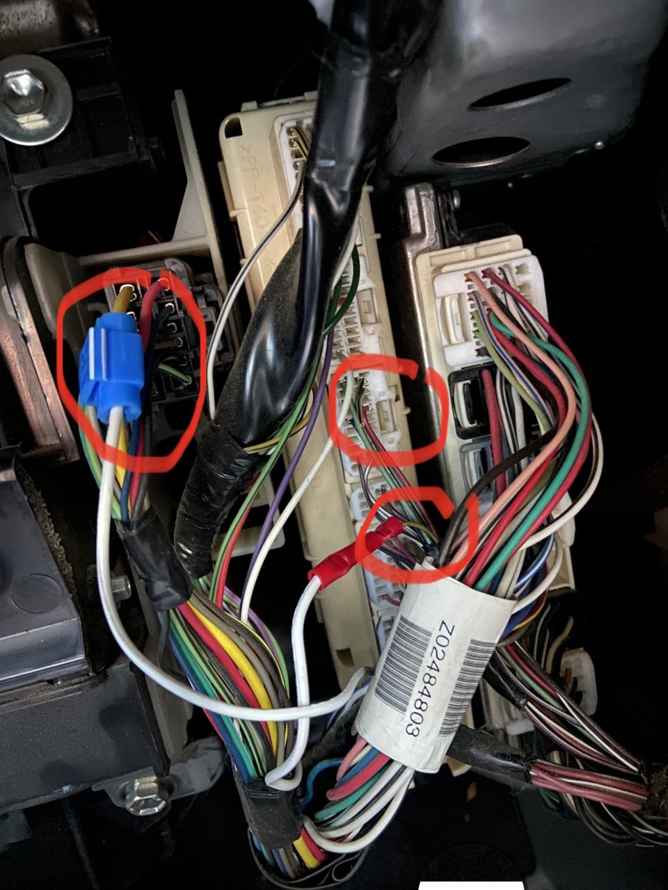

    I just did the updated yellow wire mod, and my ABS and VSC lights are now on all the time.
    Wire to pin 9 on connector three was cut, and I connected the non-connector side of that cut yellow and black wire to the 12v yellow wire with a quick splice and 10ohm (all I had) resistor. Any ideas what went wrong?

    It sounds like you're PC9 wire isn't getting the proper 12v feed. Almost like it's unplugged. Did you try it without the resistor? I spliced PC9 to a new wire all the way to the fuse box via add a fuse. Mine works fine.

    @Sonofliberty92 Thanks for answering before I even went inside to defrost! It was definitely a 12v supply issue. Seems my wire tap didn’t make proper contact.
