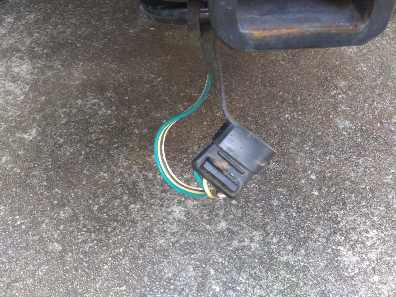

    Hey guys,
    Need your help. My wife and I bought a 21' ecopro travel trailer and need help in how to make the 4pin connector work with the 7 pin hookup on the camper. People are telling me conflicting information. The dealer wants to change us $1800 to make it work ( also with a friction brake installed) but that seems REALLY HIGH. My truck is a 2007 Tacoma SR5 forerunner V6 automatic 2 wheel drive crew cab. I live in flowery branch GA and if you know a good place to get the work done many thanks in advance.

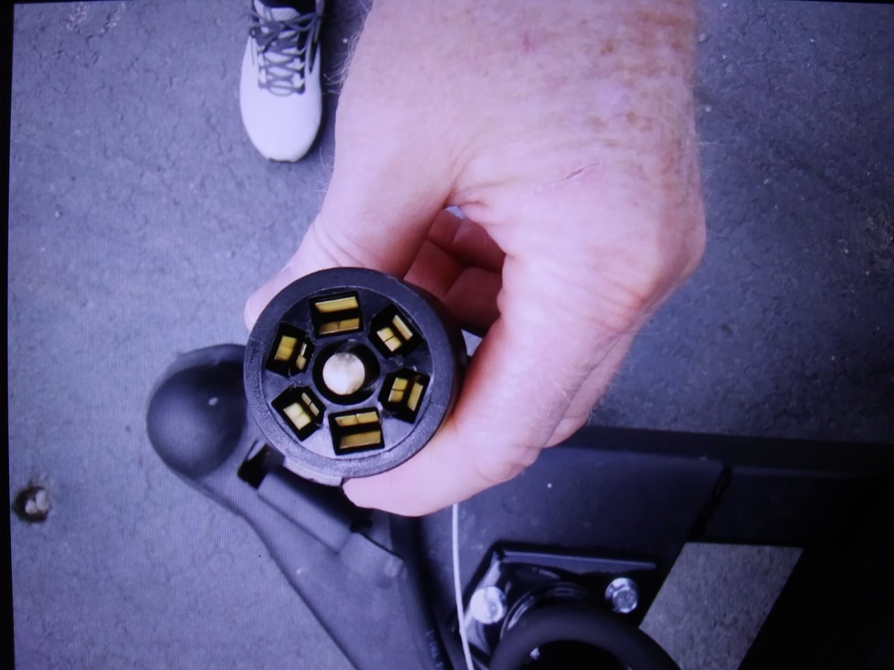

    Oh, and this can be really stupid - but brands MATTER! Pin differences in mating and such. 4pin pretty much all the same except the housing, but look at the pins on your trailer pic, and my sample. Find a brand if you can on your trailer, and go for the match.

    The dealer told me that in order to replace the 4pin with the 7pin adapter 7 wires had to be spliced in. How hard could that be ?

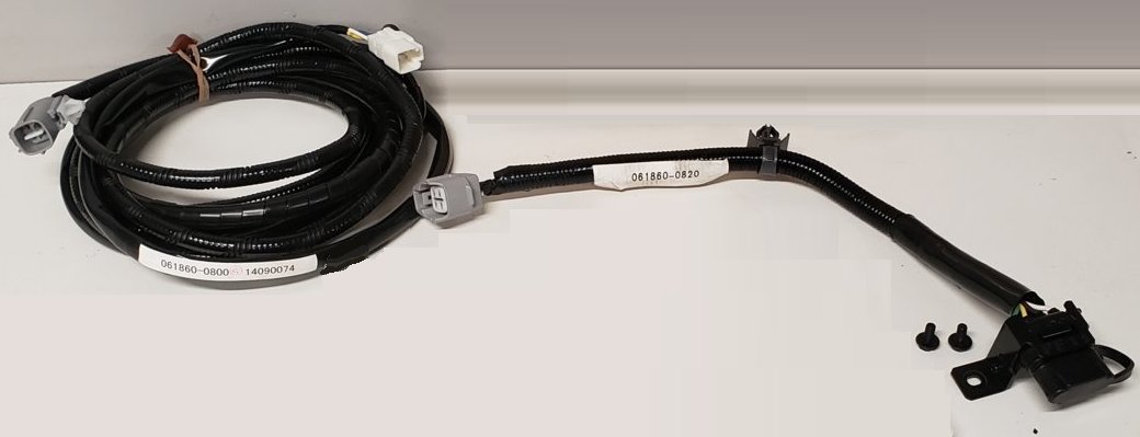

    This may be what your TACO has:
    It has combined turn & stop on left and right, tails circuit and ground.
    You could remove the portion to the 4 pin connector and add an assembled 7 pin with matching connector to remainder of harness.
    You would then need to add the 3 missing circuits:
    Battery Charging
    Electric Towing Brake
    Reverse

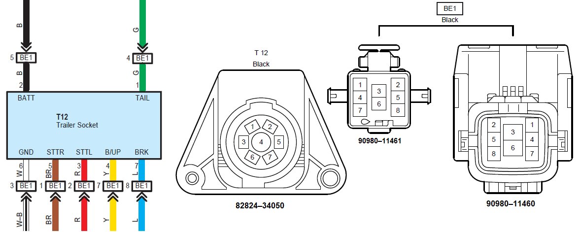

    Hood Struts, My version Fogs always ON, Map & Overhead Light Mod,
    Missing circuits would be added to connector 90980-11461 which mates to -11460 then added wires and terminals to mate to 82824-34050.
    Very doable with patience and proper tools.
