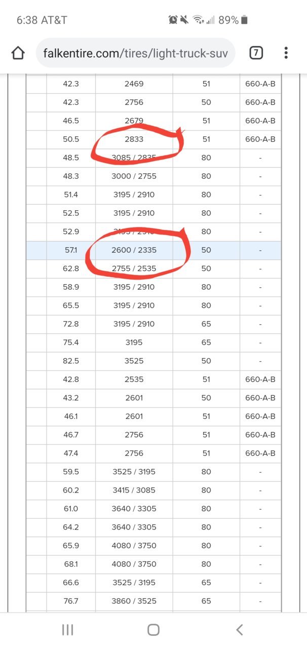

    Quick question. Im debating if I should get a P 4 ply Wildpeak tire weighting 50lbs or a C 6 ply tire weighting 57lbs.

    Which E rated size did they accidentally install? I'm about to purchase some Wildpeaks and cant decide between a P285/70/17 4 ply at 50lbs or their LT275/70/17 C range 6 ply at 57lbs.

    I do not advise "C" rated tires on a truck. Look at the specs carefully. The "C" rated tires are rated to carry LESS weight than factory "P" series tires in the same size. They are designed for lightweight SUV's like Jeep Wranglers that are not rated to haul or tow loads that you would in a Tacoma.

    Wow. Check this out regarding Wildpeaks from Falken's website. The top circle one is the P285/70/r17 4 ply and the bottom circled is their LT275/70/r17 C rating 6 ply. So strange. I dont tow or haul anything really. Just some light trails here and there when we go camping.
