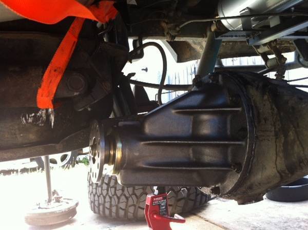

    how many pinion teeth are there? i personally would set the pinion depth a little more to get a more of a mesh, but hey the pattern looks good.

    It may just be the picture, in person it looks almost centered, Just slightly to the outside of the gear.
    The gear ratio is 5.29 and I don't have the tools or experience to adjust the pattern.

    you got the tools its pretty easy actually lol, and alright i was just going off the pics

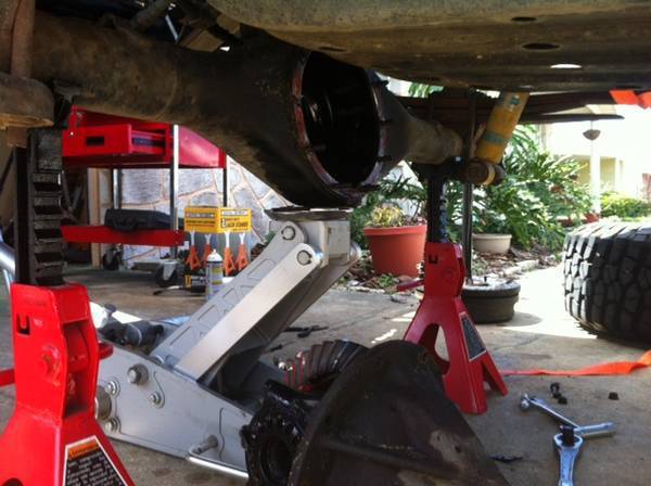

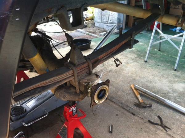

    Got started about noon today. Spent most of the morning tracking down a fitting, it seems ARB uses a solenoid with British threads. Found an Autometer adapter that will work, it's a compromise though, it will take two fittings put together. Viair makes a fitting that will do it in one, i'll order it and just use the other one in the meantime.
    I was really surprised no broken bolts, good stuff for a 23 year old truck.
    As soon as the RTV sets i'll snug it all down and plug the axles back in.
    I also just got a text back about an 85 front axle, it comes with a bunch of new parts and a new lunch box locker. If I can make the time I'm going to pick it up next week.
    I'm really leaning toward a 3 link front at this point. This is meant to be a never ending project, so plenty of time to decide.

    So bad luck this week. The deal on the front axle feel through and I'm having issues with the new 3rd. I'm getting a lot of gear whine, the company I bought it from has been great so far. I'll need to pull the 3rd and ship it back to them. They'll inspect and adjust or replace it.

    Yeah they looked like the pinion depth isn't in far enough. so its riding on the teeth edge. also im pretty sure i know where u got this from
