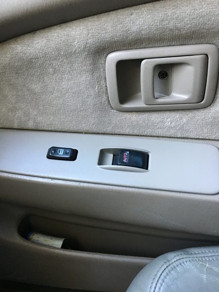

    Painted the passenger side trim (Valspar from Lowes)
    Comparison with the Tacoma passenger lock switch
    Finished Door Panels minus the passenger inside handle

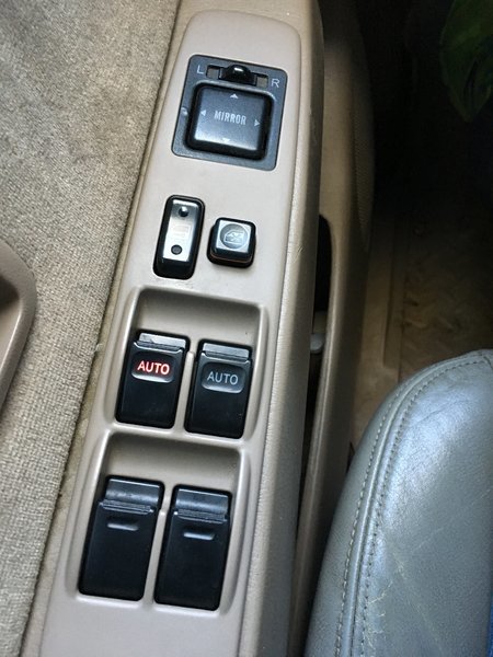

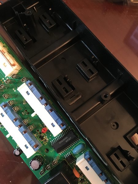

    So I took apart my master switch and put in a red LED instead of the green. I was also trying to see if I could get the passenger button to illuminate but there is no provision in the switch case to allow light through. The actual button is the same as the driver, but there is no passthrough. You can see the rectangle just below the driver switch bottom on the black part. That is actually clear plastic that carries the light up to illuminate the switch. I was hoping to find a spot to add an LED but it seems much more complicated that I wanted it to be. I may add something in the future, but for now I'll just leave it with one switch illuminated.
    I also opened up the passenger switch (the one on the passenger door) and replaced the SMD LED with a regular 3mm diode. I guess the SMD LED was burnt out. The regular LED fit just fine and I just used what I had on hand.
    EDIT: I believe a master switch from a 01-06 Sequoia has the driver and passenger switch "AUTO" illuminated, but I have not seen one in person to verify.

    Here are some photos with the red LEDs lit up.
    Jaysjammin likes this.
