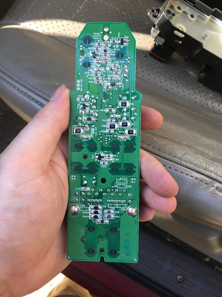

    So I actually scored a pretty cheap master window switch from an 01 Sequoia on eBay. I was hoping that I could just swap the switch tops (not the internals) to allow light for passenger auto switch. I discovered that the switch is completely different internally. There are pressure contact switches that activate the windows instead of the sliders in the 4runner. It also uses SMD LEDs instead of regular 3mm diodes.
    If someone wanted to do this swap you could probably make it work with the sequoia switches, but you would need both driver and passenger switches as well as a good wiring diagram. The sequoia master has 2 more contacts than the master on the 4runner.

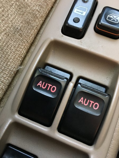

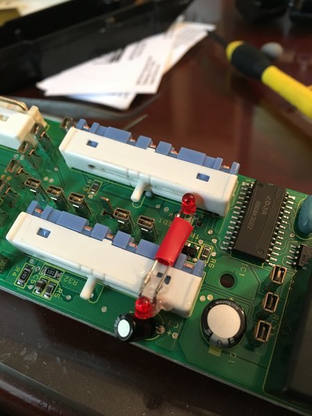

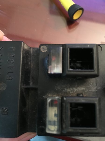

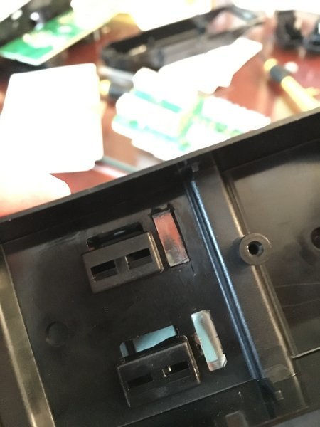

    So I got it done.
    I cut a hole that matched the driver one, then cut a piece of acrylic on the laser cutter at work that matched as well. I painted the outside black to help keep the light from bouncing around below the switch. That got superglued in place. Then the hard part was cramming an LED in there for the passenger switch. Toyota decided to put a capacitor right where the LED would go. There was less than 4mm of clearance above the switch slider btw. I was able to bend the capacitor just enough and wedge the LED next to it. I also added some electrical tape to keep the LED leads from hitting one of the pins sticking out of the board. I finished it by epoxying the LED to the switch slider to keep it from moving around.
    hole cut with acrylic piece inserted
    acrylic piece in place
    here you can see the red LEDs through the acrylic
    how I jumped the LED wires over to the passenger side
    installed
