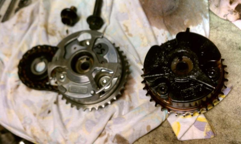

    For the record as well, the 4Runners which have the 1GR w/single VVTi, are different in one area. I cannot remember the years, in which the 1GR was first introduced into the 4Runner, so someone please add.
    Any way, that T4R 1GR has a different intake cam actuator, than the intake cam actuator on the '05 + Tacoma with a 1GR.
    Here is a pic of the difference.
    The one on the right, with the burnt oil is out of the 4Runner (T4R). Left is an '06 Tacoma.
    The sensors used to read the pick-up on each is different, so if for some odd reason you have to do an engine swap, you MUST SWAP the intake cam gears over as well.

    The difference in the VVTi actuators is the year of the engines.
    2003-2004 had the VVTi actuators on the right in the picture above.
    All the 1GRs from 2005+ use the VVTi actuator on the left.

    Well, there you go. I was unsure if they changed or not, so that info helps as well. Thanks Gadget.

    I'm having this problem right now I need to know if by just swapping the actuators will eliminate my check engine light?

    Yes, it will solve the issue. I thought I had already responded to this.
