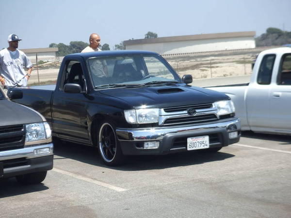

    my buddy Al from the CustomTacos forum days did this back in the early 2000's...
    i think he is here on TW as Fabtaco...

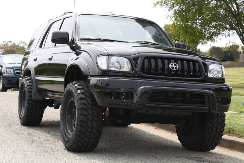

    Not a fan of 4runners, but I like and I mean REALLY like that black one! Aside from the scion emblem, of course.

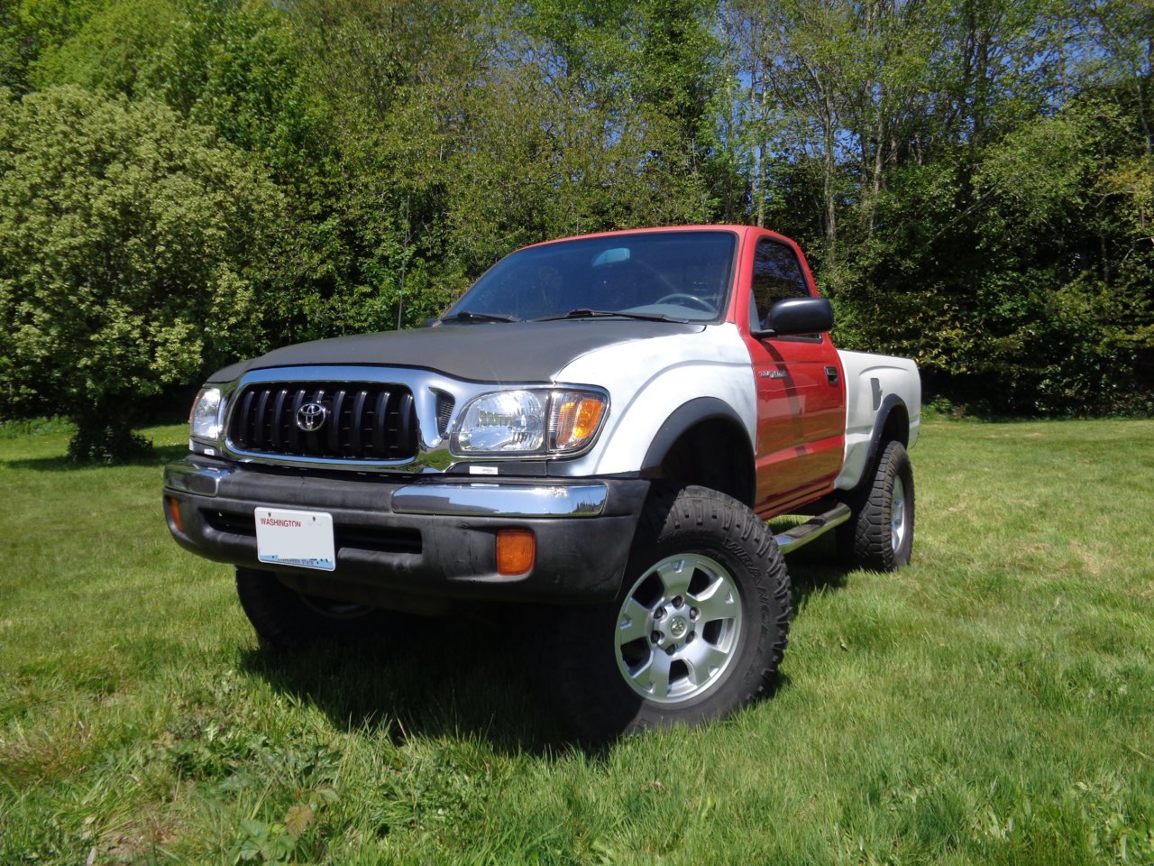

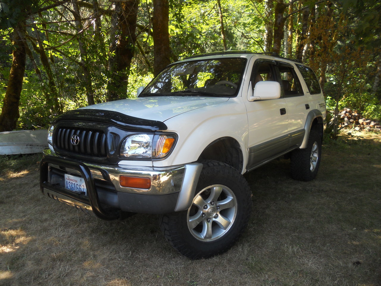

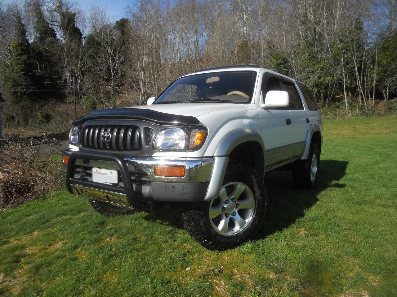

    yours is the first one ive seen that actually used the 4runner front flares. i assume they fit on the tacoma fenders fine? looks better than having the taco fenders up front and 4runner ones out back.

    460
    I had the limited option on it. The fender line was a little off, but the size of the flare ate up the difference. It attached really nice. I used metal clips on the flare and 10mm bolts from the inside of the fender into the flair. When I ordered the fenders, I got fenders without flair clip holes on purpose because I was not yet sure how it was going to go.006.jpgHere is a side by side of sorts, a kind of before and after in real time. 016 (2).jpg
