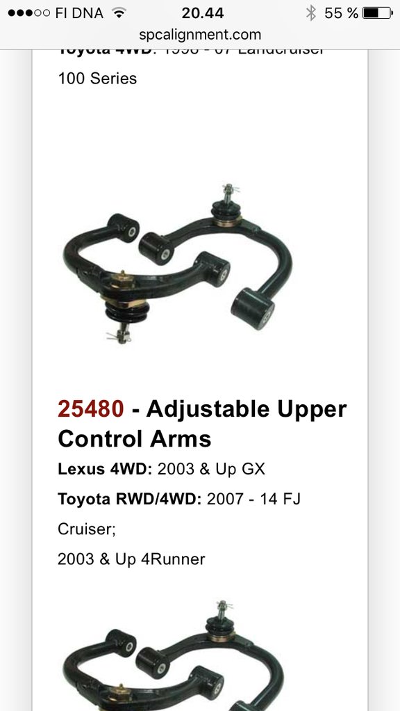

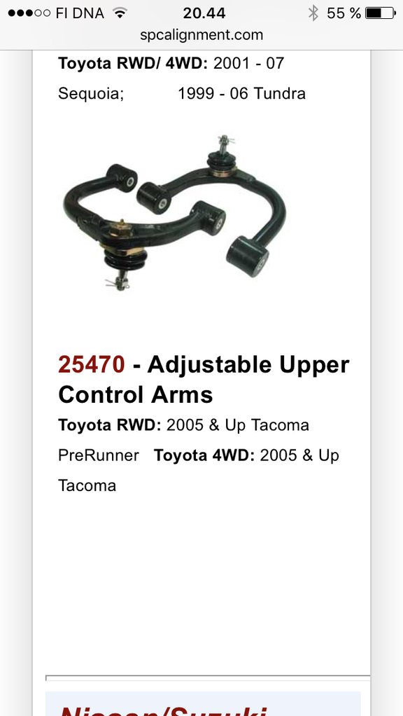

    2007 FJ Cruiser 6M/T
    TRD SC, UCON, CNG conversion, RC 6" (lifted 4"/3" air suspension) w/FOX 2.5, 315/70R17 Duratracs, RECARO seats, etc.
    It's because the cone is bigger in 4Runner/FJ. That's what I've understood.
