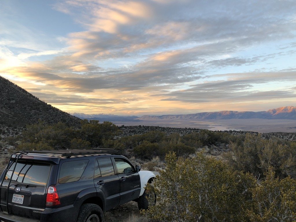

    Looks great on your 4runner! No problem with the back hatch and ladder hitting when it is opened?

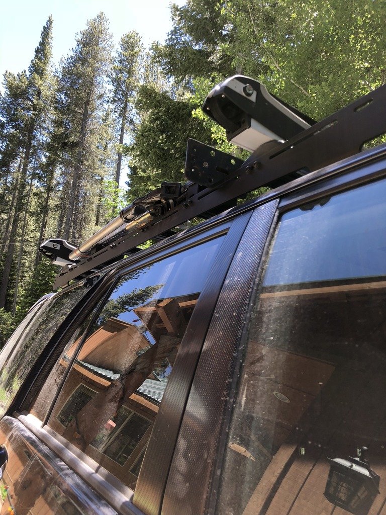

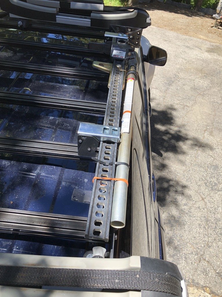

    nope. I do have the rear bar pushed forward a little to clear, but just a tad.
    Added a few items to the rack.
    Paddle board rack- Thule

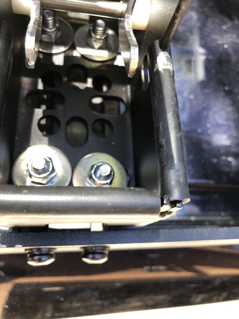

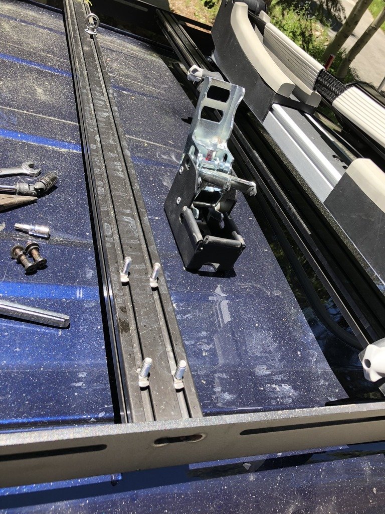

    Using Warrior Products Hi Lift mount. VERY solid mount and it locks. Fits great using 1/4-20 carriage bolts
    Mounted up my TredPro mats using simple carriage bolts (1/4-20 at 2.5"long) and some rubber pads, bought some SS loop nuts off Amazon(like the ones Prinsu sells) so it can be removed easily.
    All is secure and solid. Have something somewhere up there rattling like hell on washboard that is driving me crazy! I "think" its the HiLift jack mechanism shaking around, but it "looks" like the rack itself is wobbling L/R thru my sunroof, and that could be the noise. Maybe it cant handle weight? Noise disappears with no hiLift. Don't hear it with 2 paddle boards and the Treds?
    More investigation required!

    What was up there rattling?
  11. Jan 10, 2019 at 3:42 PM
    zidaro
    zidaro Well-Known Member
    Jul 30, 2009
    #20369
    74
    mammoth lakes, ca
    4x4
    87runner with some mods, 08 V8runner ready to rock
    twas the High lift. used some bicycle inner tube to insulate in key areas now its quiet as a mouse
