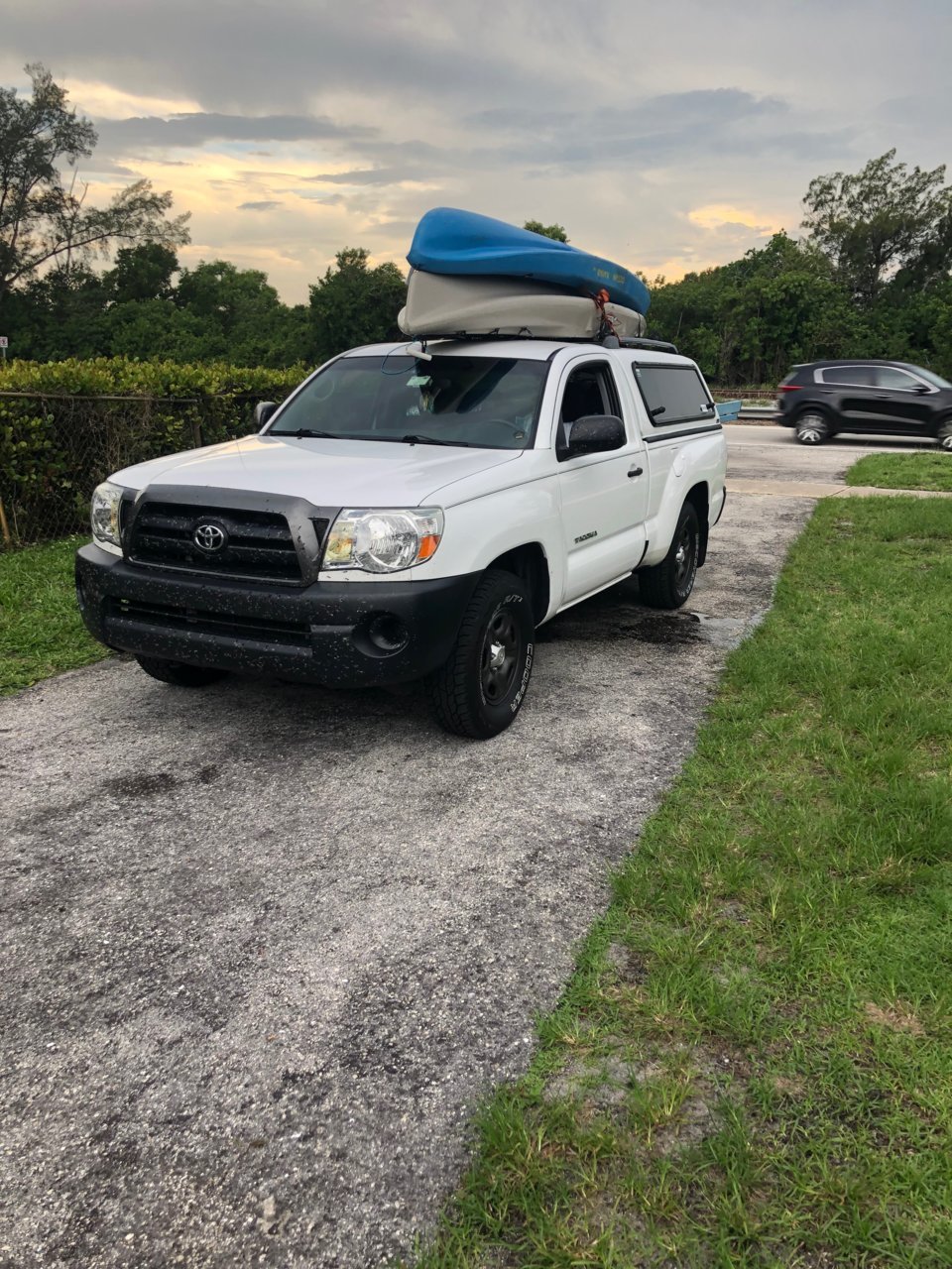

    Hey man I’m new to this page and I made an account just for this post. I’m getting a cap for my regular cab tomorrow and will be picking up 4Runner rail system from an 18 model. I’ll keep you posted and do some pictures of the build.

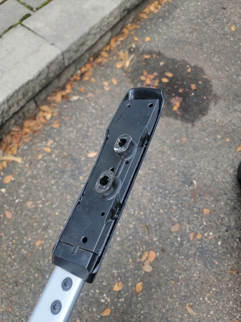

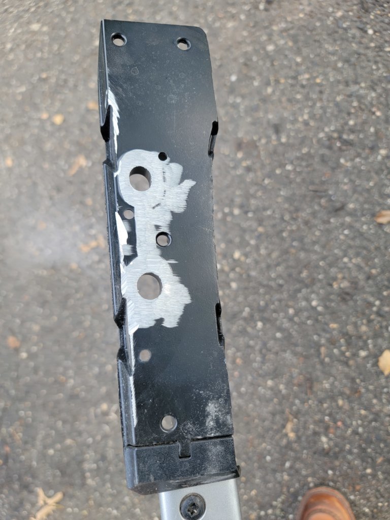

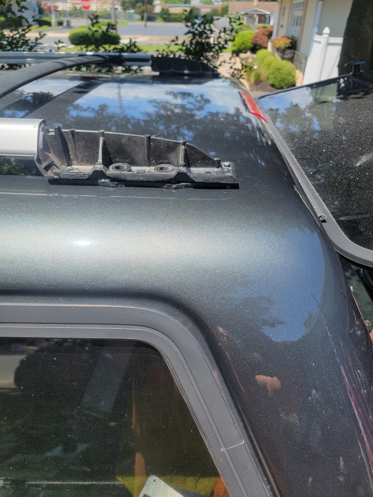

    I mounted 4runner roof rails to my camper shell. It took a little modification but it can be done.

    Looking to do the same to my long bed camper. As for modifications, was it flattening the bottom of the mounting foot? Were you able to reuse the rubber pads?

    I flattened the bottom. Not sure what rubber pad you are talking about. I got the side rails used. Ordered rubber from Amazon and cut to size (poorly lol).

    if you zoom in you can see the 3/8" rubber pad i used.
