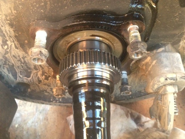

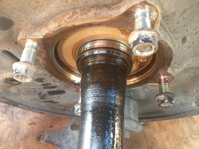

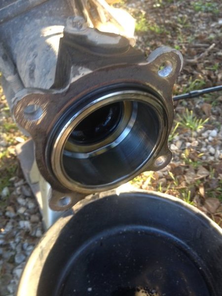

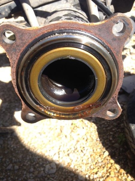

    photo 1 (14).jpg Non-Abs housing from JYphoto 2 (16).jpg Mine w/ Abs housingphoto 3 (12).jpg My ABS axlephoto 4 (7).jpg Non ABS axle from JY

    It worked. Came out of a 96 4Runner with ABS, no Locker. Direct replacement just bolt it on. I replaced the seal in the hub.
    Only trouble was 4Runner backing plate parking brake is clocked 90 degrees CCW from Tacoma. Just had to flip parking brake cable where it comes from the front and find a ~1" bracket to span the gap between brake arm on the backing plate and the cable. Cable now threads the needle between strut and leaf spring...about 1" clearance to each. I also relocated the bracket that holds cable right by the diff to the lower mount.
    Best part....donor axle had date of seal replacement on it...2011. I'll take it. I figure I saved a few hundred. Plus don't have replace brake shoes or clean up any nastiness that was inside the drum. New drum is nice and dry.
