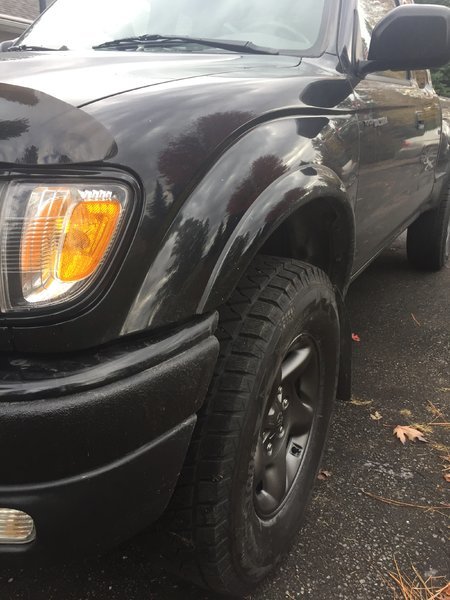

    I used Rustoleum Flat Soft Iron on mine. Similar color to the post mentioned above. As far as durability, it's all in the prep work!

    So true. And I think that really applies to anything you spray on your truck if you want good adhesion.

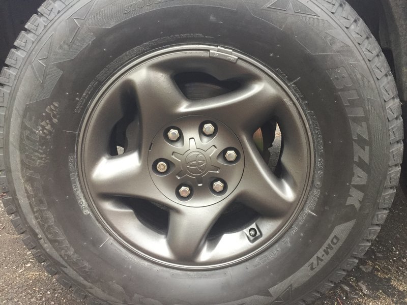

    I just finished my Tundra wheels. I used Duplicilor wheel paint, graphite with mattte clear coat. Take your time, 2 wheels at a time when painting. Sand and prep as needed, remove wheel weights, use acetone to remove grease & use primer! Make sure the temp and humidity are good for painting or you'll end up with a bad finish. Good luck.
    (Color is darker in person)

    Those look sweet! Nice work...

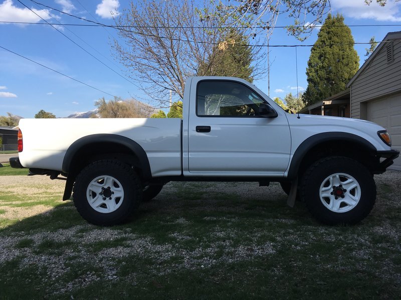

    Me too! They only weigh 21 lbs. each. I have 2 sets.

    Nice. I don't know what it is about the design, but it just works with first gens.
    That's it. I'm selling my stock alloys and getting some of these.
