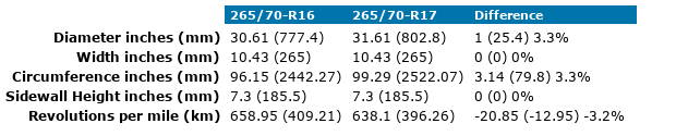

    Why only two rims? And why would you want to mix and match sizes. I hope you realize that a 265/70-16 (typical stock size on a 1st gen 4x4) is not the same overal diameter as a 265/70-17.
    from the online tire size calculator

    I'm sorry just re-read my post. I meant to say a set, not a pair. I didn't realize that the does not have the same diameter, that chart is very helpful. I don't have the rims, but I'm going to be looking at them soon, so ill have to see what is stamped on the rim.
