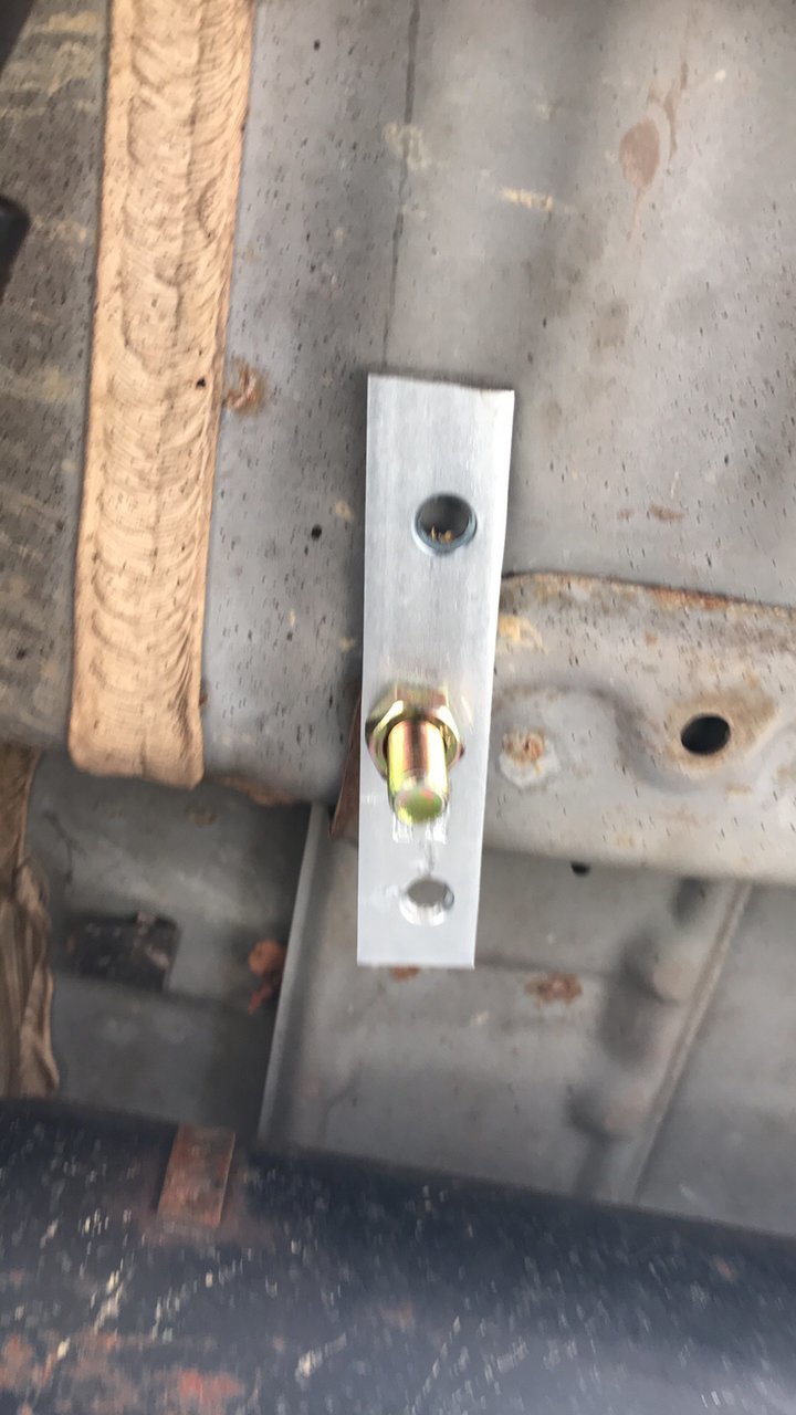

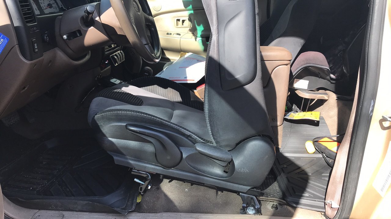

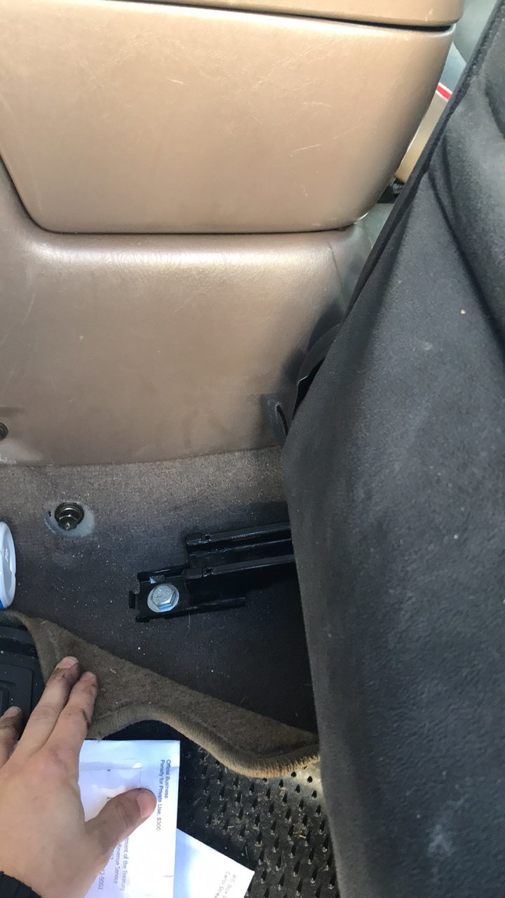

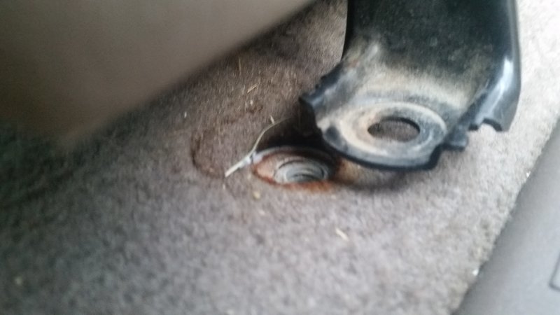

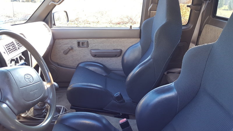

    I just did this recently on my 99. Seats from 98 limited. Sport and limited have lumbar and butt height adjustment i think, other models may not. Go for the leather if you can find them. All holes on driver side lined up, just had to hammer the front mounts closer to 90 degrees to make them fit the rail on the Taco. Pass side outboard rear hole did not line up, you need to drill or fab a bracket like the poster above did. Here is a pic with them installed and one showing how far off the 1 hole is. Also got the console because it was nearly the same height as the top of the shifter because the stupid 60/40 bench armrest was garbage. tmp_26548-20161219_1644171484477493.jpg tmp_26548-20161013_173709-1672442345.jpg

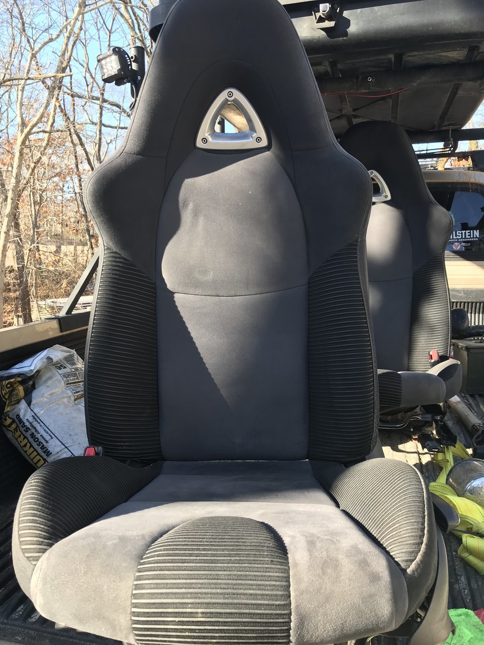

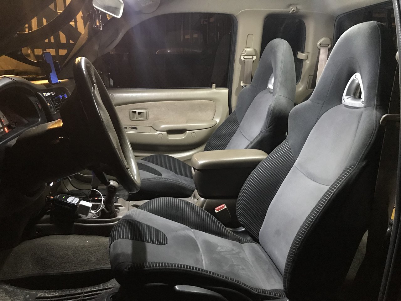

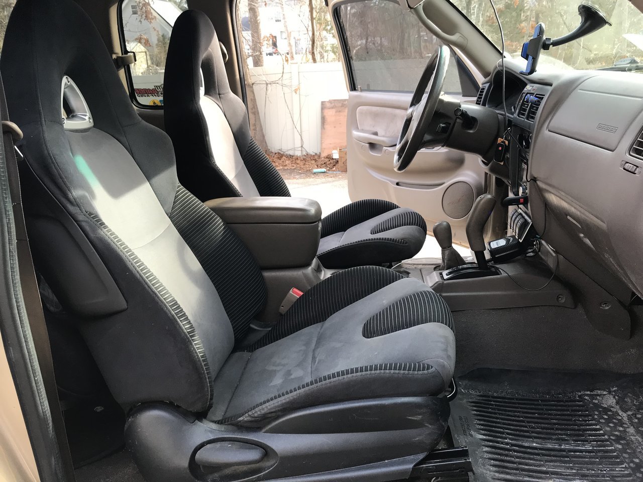

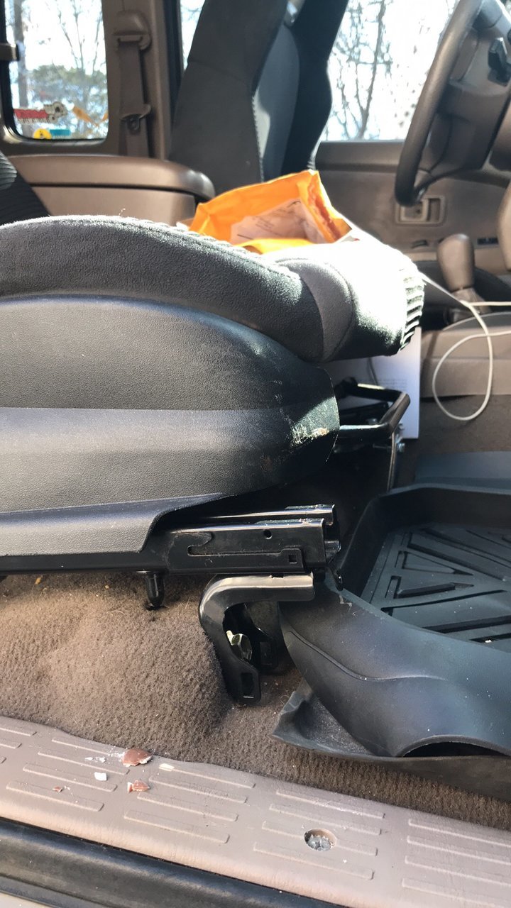

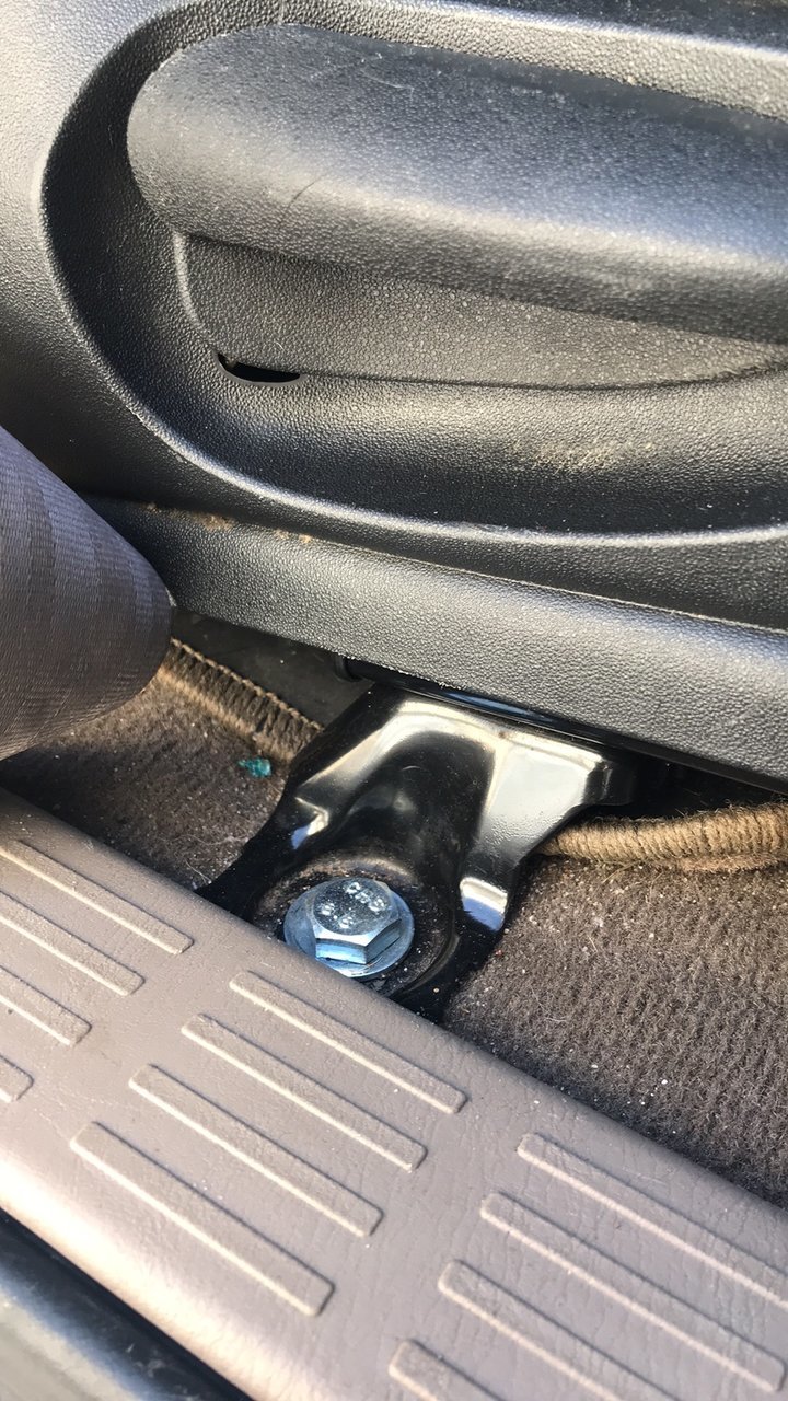

    I was available to install mazda RX8 seats. You only need to fab 1 bracket on each seat...
    Planning to get 8 grade bolts this weekend and bigger back plate...
    Best mod in my truck now...
