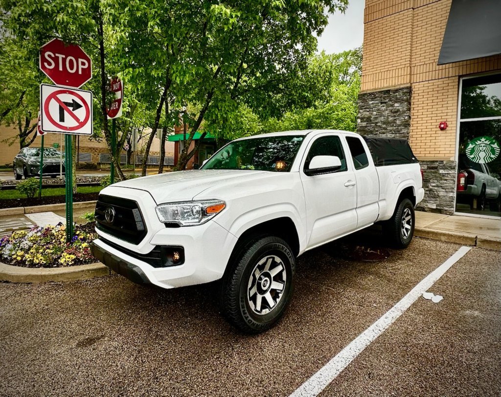

    I recently bought these awesome 2023 4runner limited wheels, with very little use. Mounted them on my tacoma, 2023 sr, hit the TPMS button, and they work! I haven't checked part numbers but just wanted to let you guys know.
    ***my tpms sensors have the metal valve, these wheels had the rubber valve stem versions. They look different.

    3rd Gen Tacoma sensor ID numbers have to be programmed into the trucks ECU and it only sees 4 ID numbers.
    Could you have stumbled on four identical sensor numbers off the 4R wheels? Maybe.
