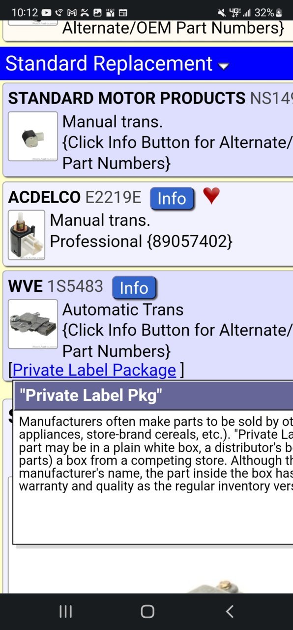

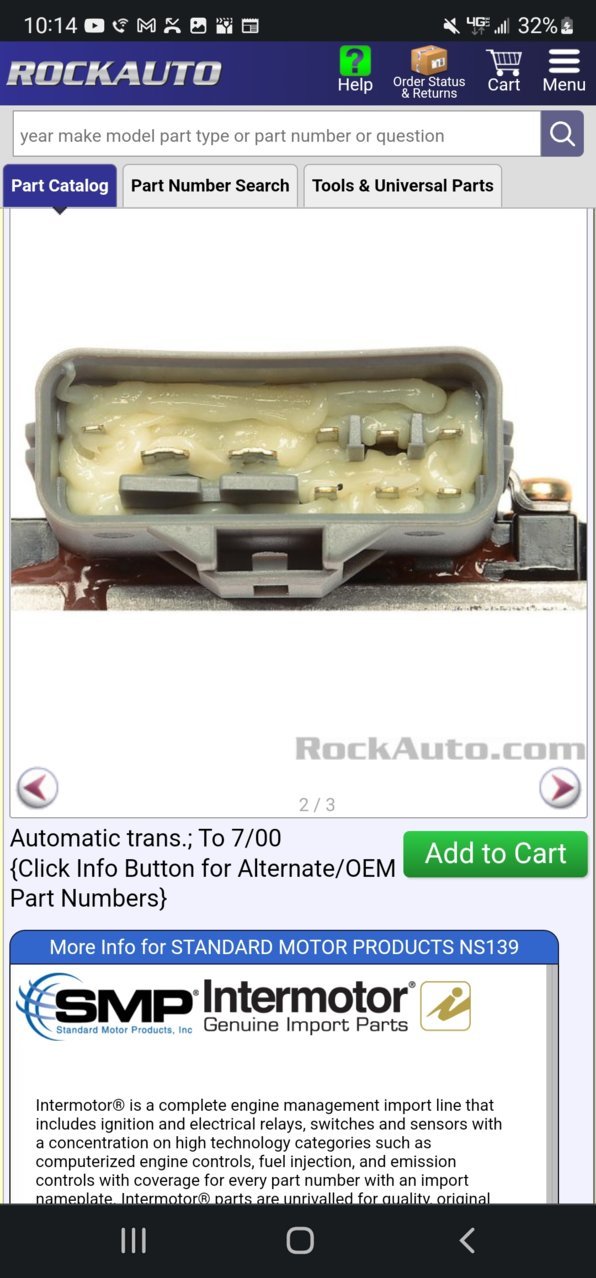

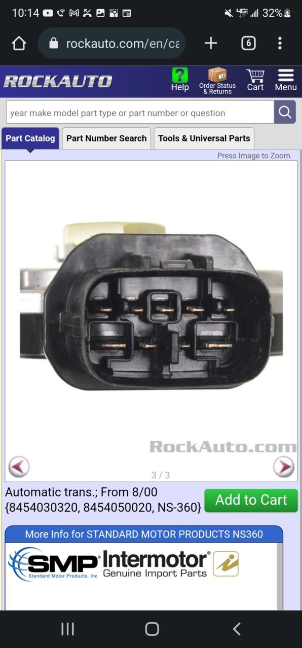

  6. Oct 3, 2022 at 7:20 PM
    Cryptictoy
    Cryptictoy Well-Known Member
    Oct 12, 2021
    #379443
    115
    Esperance, N.Y
    Pic from rock auto. Looks like there is a difference in the plugs . Change was upto 7/2000 then the radiused corner plug 8/2000 on.
