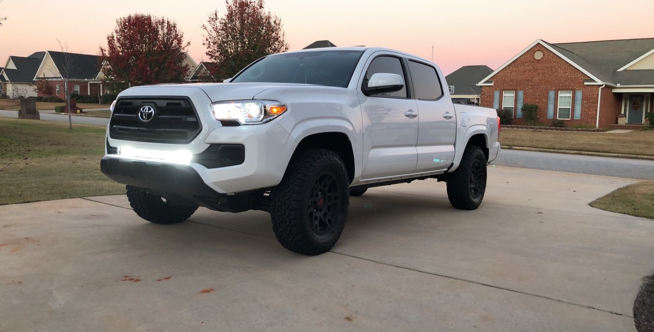

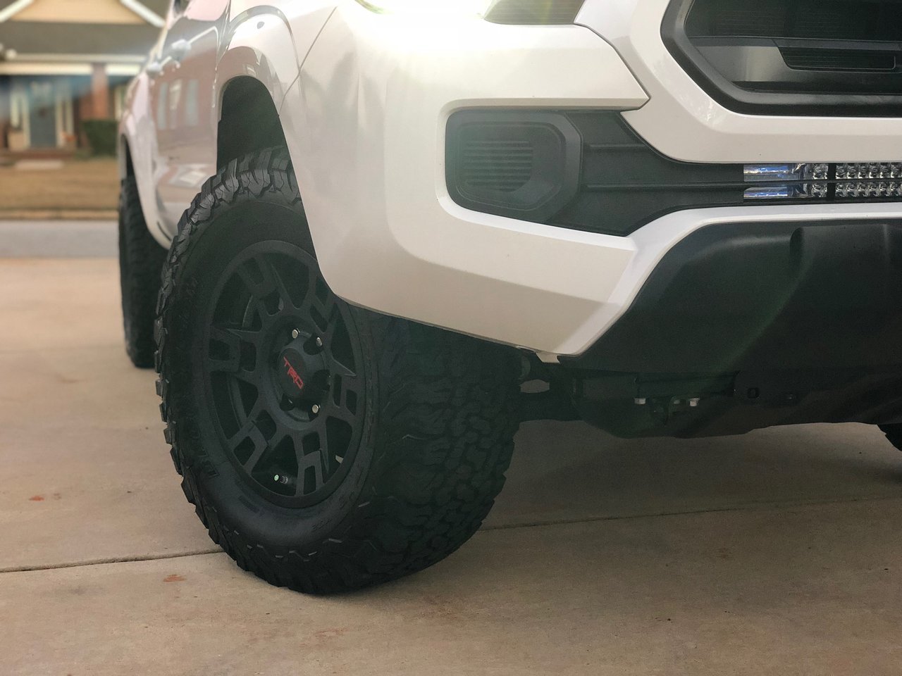

    Here my truck with 17 4runner wheels and 265/70/17 BFG ko2.. I believe thats the biggest without a lift.

    Looks great! Love the light bar!

    Damn, those rims look good on the Taco. :thumbsup:
