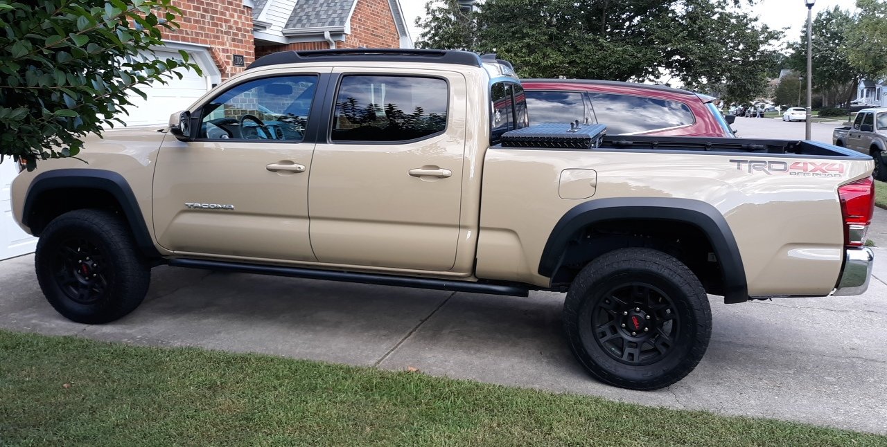

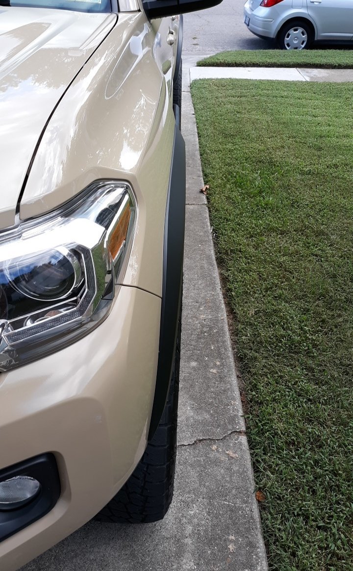

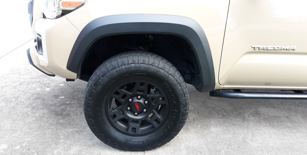

    They should fit but you might need different lug nuts. I'm not sure what style lugnuts come with the SR5 but my OR alloy wheel lug nuts were a direct swap. If you have steel or acorn style lug nuts you'll need to change them out.
    My truck with the 4runner Pro wheels and 265/70/17 Nitto TG..20180929_165615.jpg 20180929_165526.jpg
    If you have the fender trim moldings like I do the tires will be flush with them.
    The only other variable would be the front air valence, my truck never came with one but some trucks with a 265/70/17 tire MIGHT rub on that.

    Hey, thanks man! I really appreciate the help. That's a sharp looking truck you've got there, and that's good info on the lug nuts. I'm pretty sure mine are the same as yours, so they oughta work. Mine has the fender trim moldings as well. That's good to know they'll be flush, and that gives me a good frame of reference for what to expect. My truck did come with the front air dam, but I removed that pretty quickly after purchasing the truck. I'm a function-over-form man most of the time, but I just didn't like the look of that thing.
    Those wheels and tires looks sweet. I'm stoked. I'll be getting mine on tomorrow. I know a lot of people apparently have those wheels, and although there is something to be said for originality, at the end of the day if I think some looks cool, I think something looks cool. I'm not going to base my taste on whether other people do or do not share the same aesthetic. A lot of people choose to go with that look for a reason: it's a good look.
