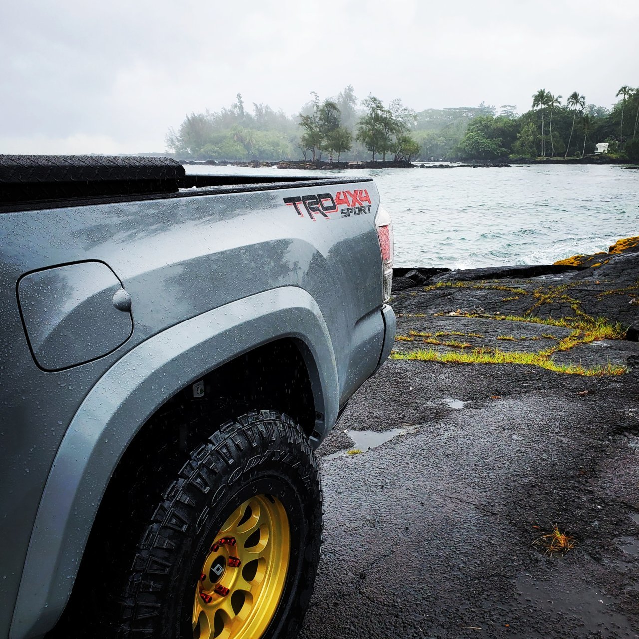

    probably gonna sit straight up with the fender since the wheel spec is 17x7 et:4. definately not the same wheel, but the wheel specs is almost similar to what you would be with your spacers equipped. im also running 265/70/17 with no lift and dont rub. you should be more than fine tbh. i would just get the wheels if you really like it.

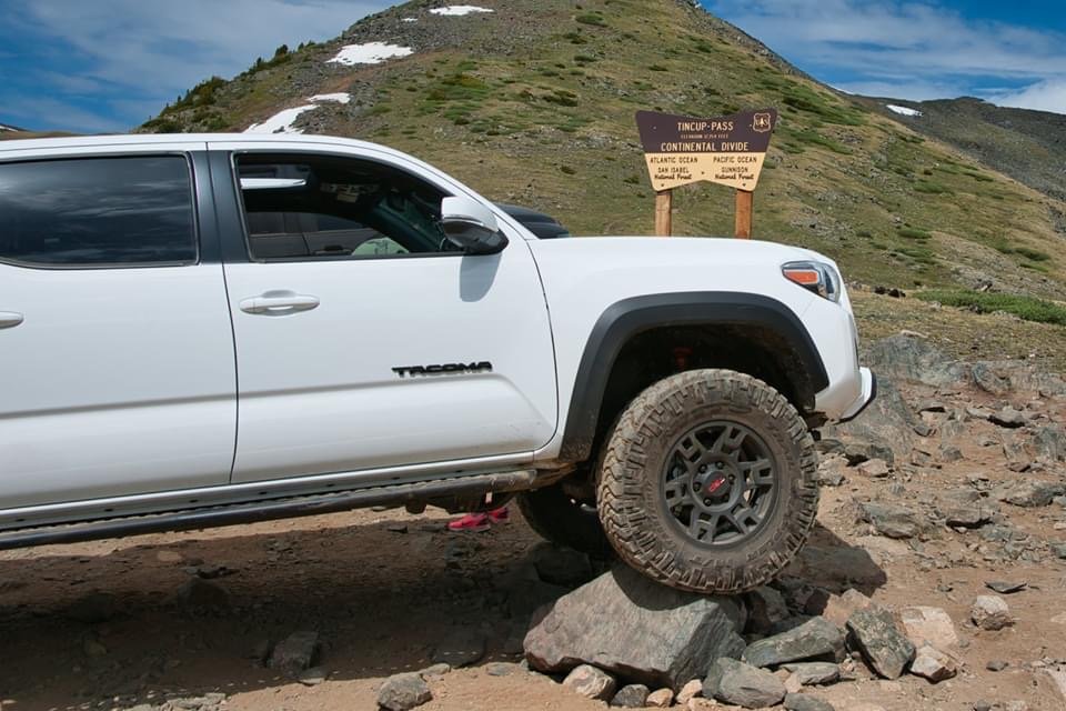

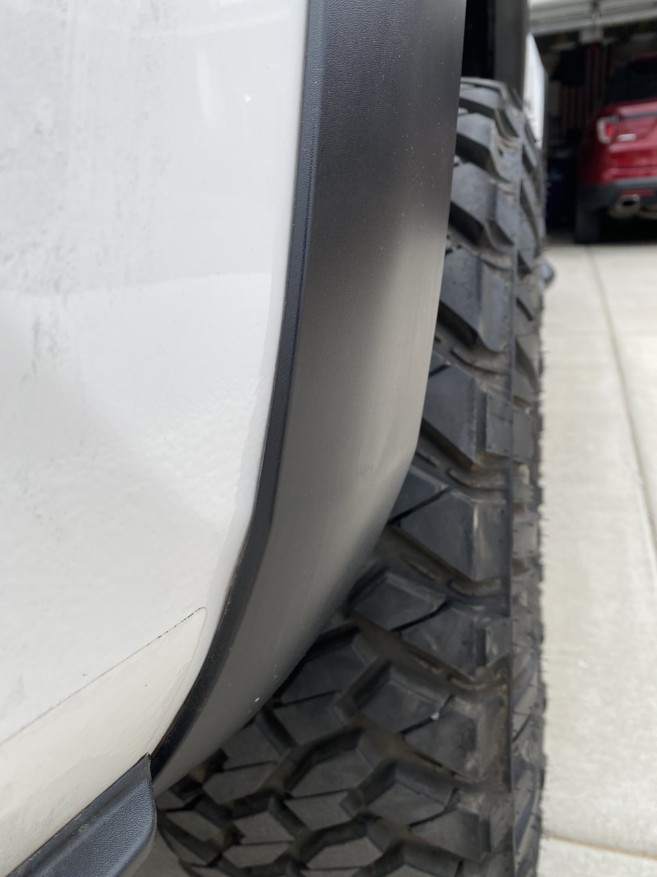

    I have the 4-runner 17 inch “SEMA” wheels with 285/70/R17 and no spacer, not sure this helps but may give you an idea.

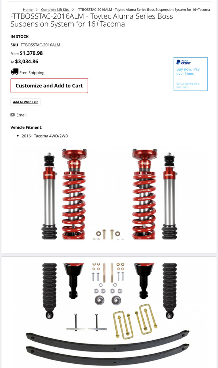

    No CMC, below is the list of the updates/upgrades that the truck has had since stock. I am not an expert but from what I understand the SPC adjustable upper control arms are key to not rubbing. The SPC’s allow for better position in the wheel wells I guess. The lift also came with the diff drop kit and some shims as well as a AAL. 6238CC4F-0CA3-42AD-AB22-DB60CD5CEC0A.jpg
