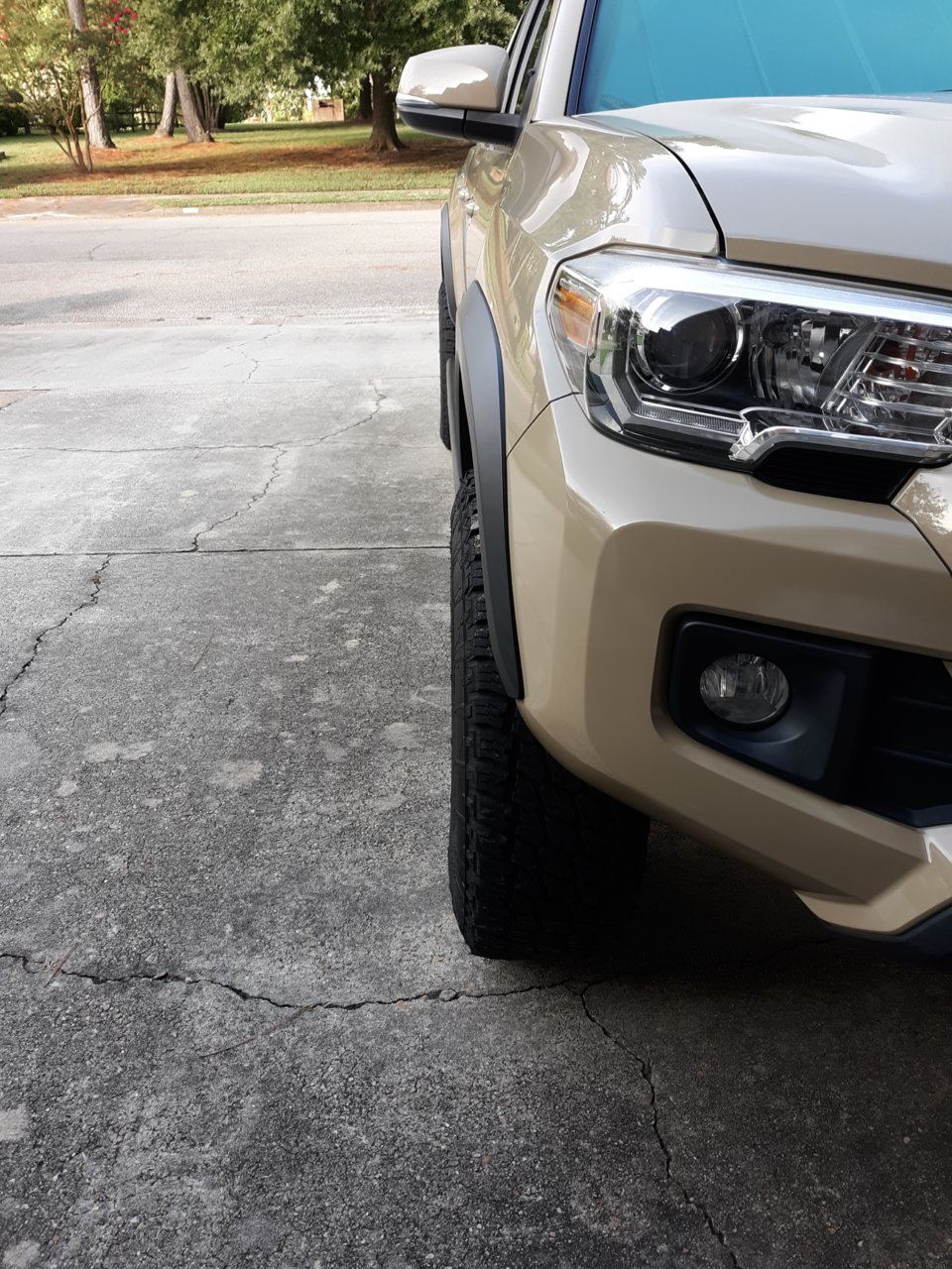

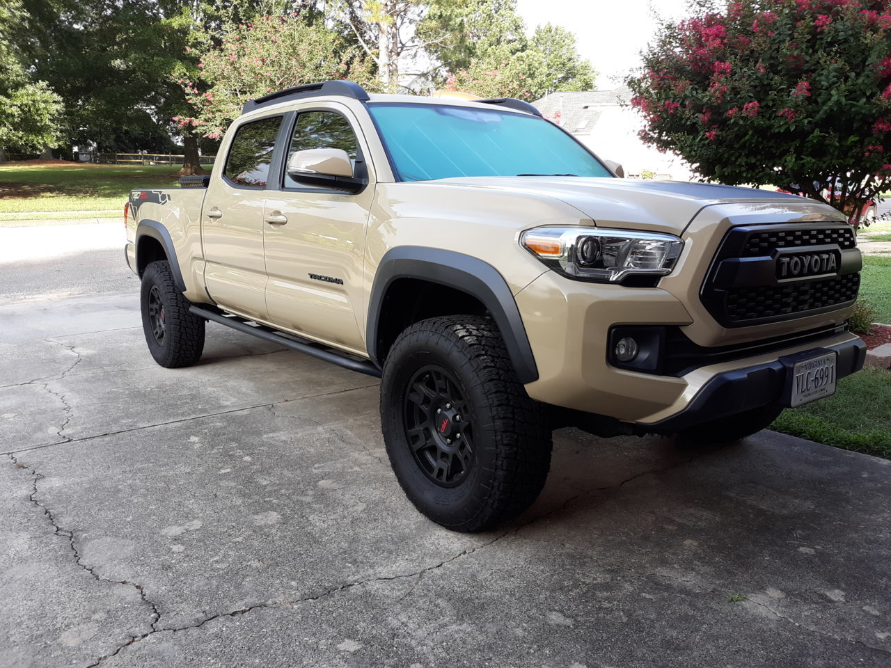

    Heres the poke with a 285 tire. 15964562111088392200310754653666.jpg 15964562717378079041531937419565.jpg

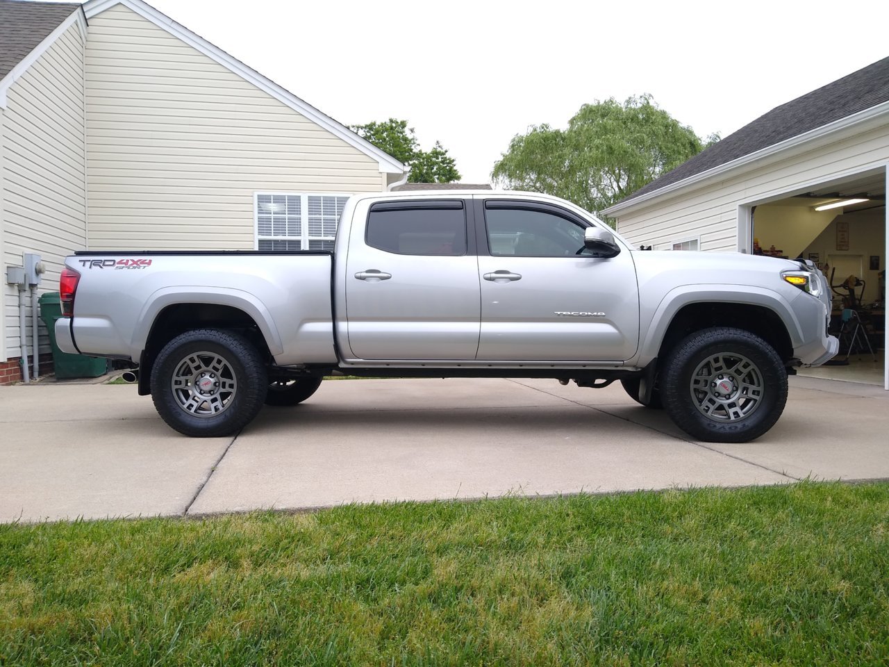

    Bilsteins 5100s on the top setting, 4runner Gray TRD Pro Sema wheels, 285/70/17 Toyo AT3s, Sumo Bump stops, TRD exhaust, ECGS Clamshell bushing, 1/4 shim for the lean and one inch rear block, OEM Pro grill and garnish OEM TRD Skid plate, TRD CAI, Demon Brackets, Rigid Industries Pro fog lights, OEM Trail Rails sidebars, Diode Dynamics LED SL1 high and low beam lights, OEM Roof racks, Clazzio leather heated seats, Remote Start, TRD Pro shift knob, tinted windows, Rockford Fosgate 4 channel amp for the headunit and sub and amp combo, OEM Puddle lights, OEM tailgate lock, OEM bed mat, LED interior lights, OEM blackout kit for letters, JLT catch can, upgraded 27F toyota True Start battery, Vleds led tail light kit with Pro tail lights, OEM Rave4 side mirrors with convex spotters,just to name a few mods.

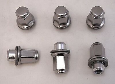

    Quick question,
    I just bought a set of OEM 4runner TRD pro wheels for my 2020 tacoma. Do I need to change the lugs or can I keep and re-use the ones I have? I read somewhere that it might not thread around enough times and should be replaced. Need to make sure..
    Thanks

    If you had steel wheels then yes you need to change the lug nut. If you have a Sport or OR then no you won't need to change them as long as they look like this.
    TPMS sensors also swap over as long as they're not from steel wheels.

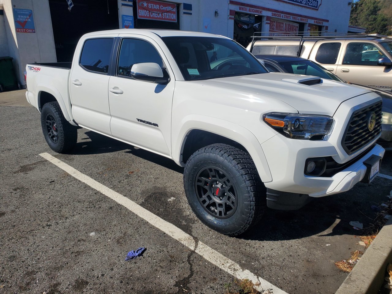

    thanks for the info. Got them mounted. Looking good I must say
