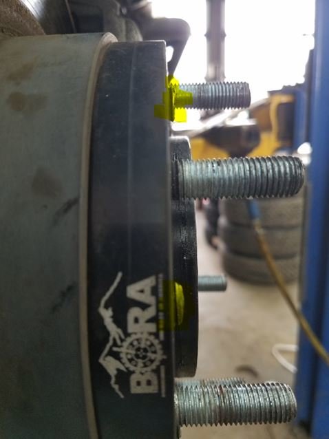

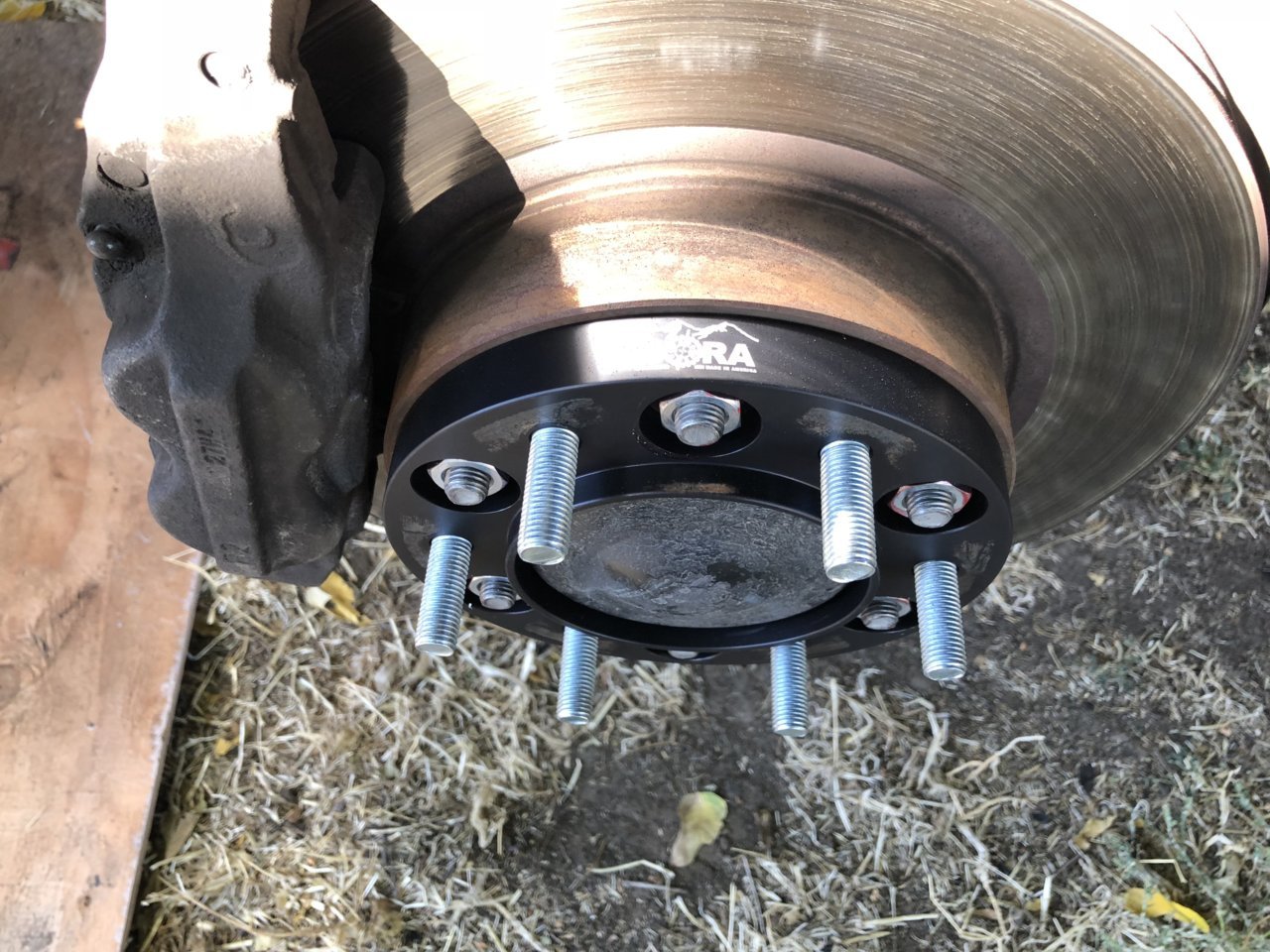

    Is that a 1” Bora spacer?

    3/4”

    Would I need to trim the studs with a 1” spacer?

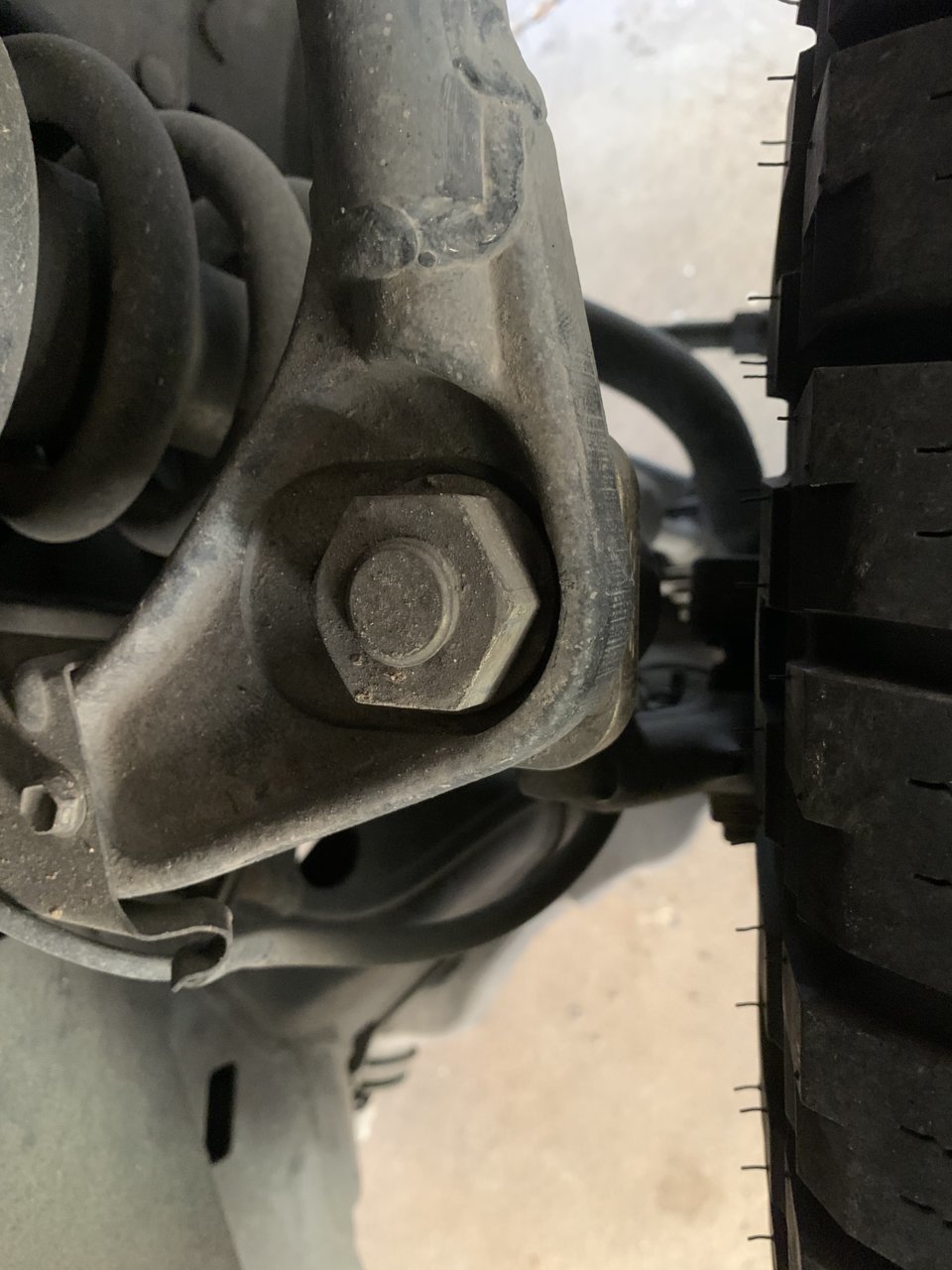

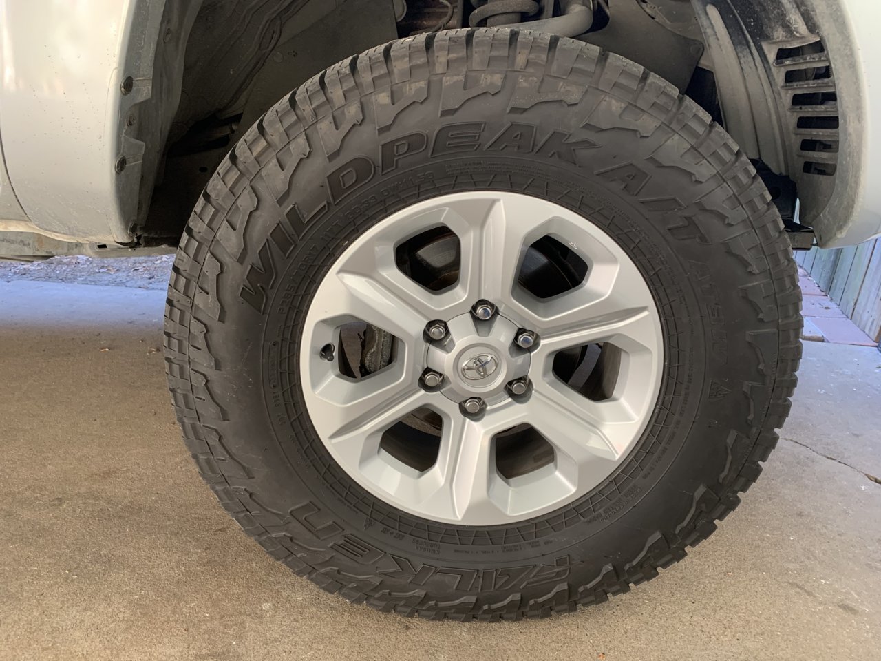

    Here is mine. Current 4runner SR5 wheels. No wheel spacers, no rubbing on the suspension. SPC uppers! 3 inch lift (bilstein) p285/70/17 at3w Tire’s.
