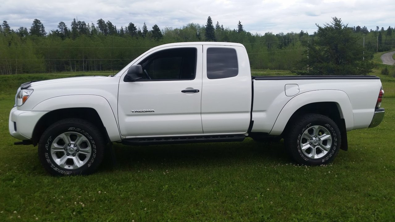

    Fit without issue and they have a little less offset so the wheel sits out just a touch more. I have 265/65R17's mounted and not even close to rubbing.

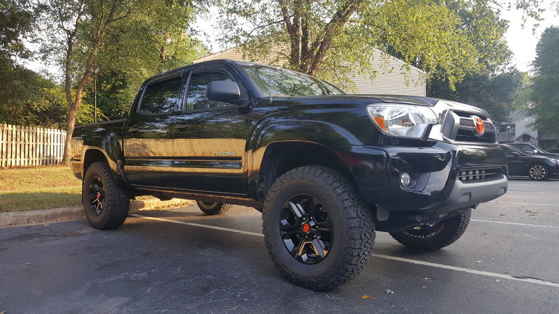

    They will fit no prob. Here's mine with 285/70R17 KO2'S. I do have a leveling kit on the truck
    ChadsPride, Nalex[OP] and Ruggybuggy like this.

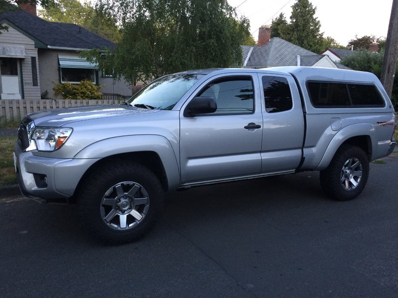

    265/70/17. No rubbing once the mudflaps were removed. image.jpg
    ChadsPride and Nalex[OP] like this.

    Nice! How did you get the black paint to stick? Powder coated?

    Powdercoated.
    You have to remove both front flaps.

    It rubbed at half lock both directions, especially when going over small bumps, like turning into a driveway and going over the small 2" curb. On the factory flaps you can see there is a small bump that sticks out.
    It wasn't hurting anything. Just scuffing the bump. The sound didn't even bother me. The massive scrapes while off roading irritates me because I was never sure if I was scuffing he flaps or bottoming out something important. So I yanked them off. Looks waaaaay nicer.

    It's easy enough to find where it's rubbing, probably on the little nub on the mudflaps. Use a heat gun to soften the plastic and press it inwith the side of a chisel or something a quarter inch and probably wouldn't rub
