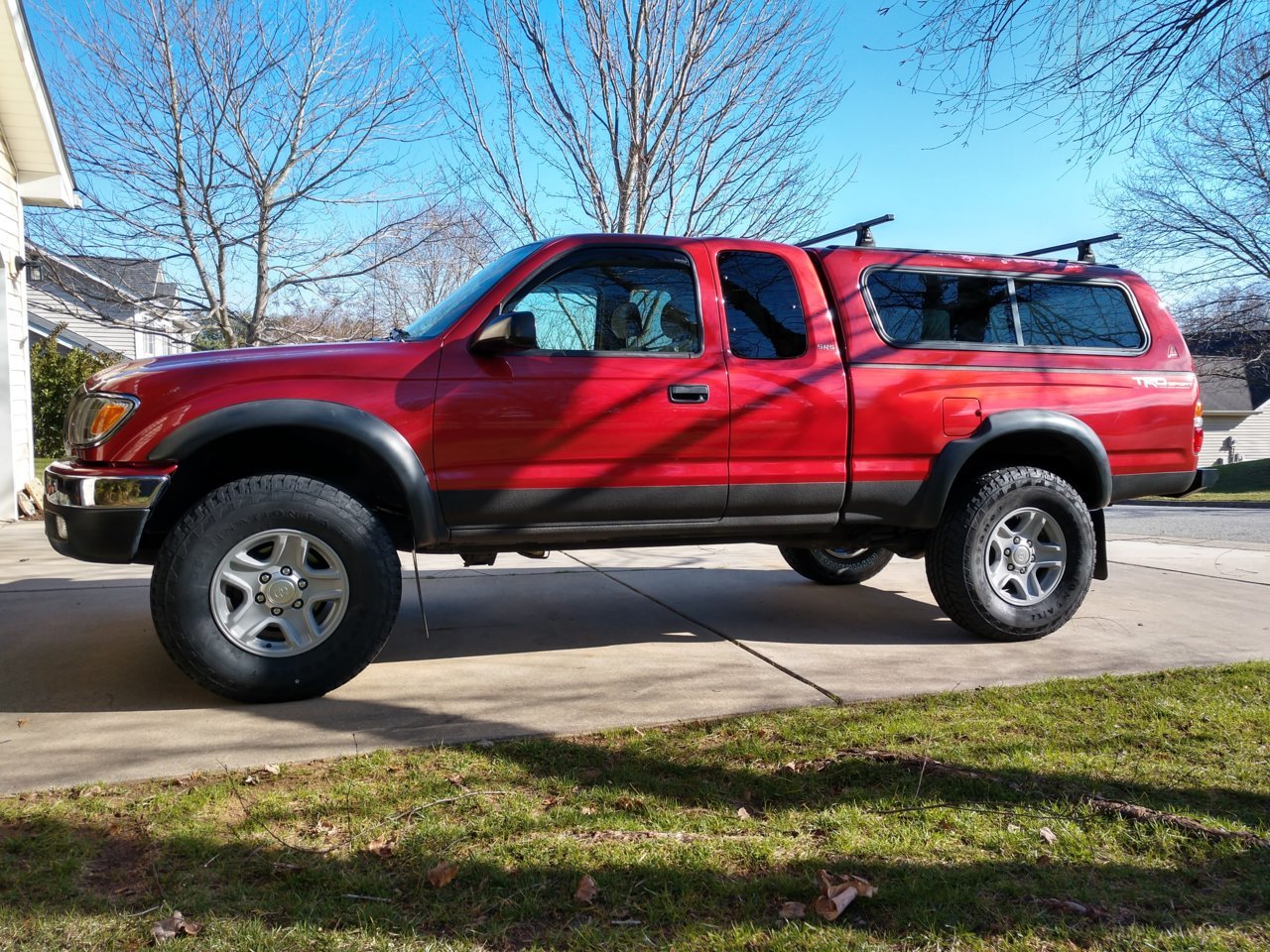

    They clear the same way 16" Tacoma wheels do
    His definitely look good though

    What s the offset on those? Needs to be 0 or negative, correct? Negative pushes the wheel out, right?
    Ive got 03 4x4 and doing the Tundra kit soon.
    Kinda like the look of those. Im still on the snowflakes.

    Looking for 16x8 for mine to replace stock 16x7 (running 285s)

    Yes negative offset pushes the wheel farther out.

    I think you're asking about the 4Runner 5-spoke wheels shown in the first post. Offset on those is 13-17mm as they are 16x7 wheels with 4.5-4.625" backspacing. Note: I always find backspacing easier to understand, so I used .
    As 7" wide wheels, you can't run very wide tires on them - I run 255/85/16's, but narrower tires are generally better for offroad (and pavement, frankly) as long as you don't mind the look of skinnies.
