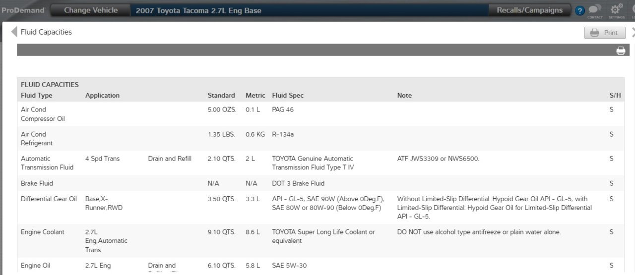

    4 speed.
    You have D then 3 2 1
    5 speeds have D 4 3 2 1. Only V6's had 5 speed autos.

    4 speed and I would recommend changing your transmission fluid when you have the convenience to do so. Ideally next time you do an oil change do the transmission fluid as well.
