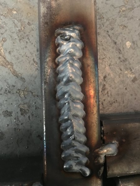

    Went and got the parts for my welder this morning and was practicing a little bit because I haven't welded in 2 years, how's this look? I'm asking you because I know you'll be honest. Lol

    Nope. Just never really done a trail ride. Tore up some hay fields and cow pastures in farm trucks though. (20+ years ago)

    Didn't you miss the seam? Those pieces don't look fused.:p

    Just practicing beads lmao

    Like crap. Looks like your heat is good though. What welder? Mig? With or without gas? Flux core or solid wire if mig? What's your feed rate and heat set on? What thickness metal? Does the welder have a chart on it?
    If mig .......
    Practice technique. Small loops is the easiest for me. Imagine drawing a cursive E over and over again. You have to find a steady consistent speed. Try and be comfortable where you know that you can stand/sit in one spot and move from side to side in a smooth motion.
    Practice pushing and pulling. Tilt the head back to about 45°, pull the trigger and start a puddle. Once you have the puddle then either push it where you want or pull it where you want. It's very important to keep a puddle. This is why moving in a smooth steady motion is so important. If you can control your speed and steadiness then you will be a good welder

    Millermatic 130. Mig w/ gas. Solid wire, feed rate is 40ipm, voltage is on 2 out of 4. Metal that I'm practicing on is .120 wall sq tubing and .120 wall hrew piping.
    I'm also doing this while sitting on my knees crouched down in my garage floor, but I'll definitely give the e thing a shot.
