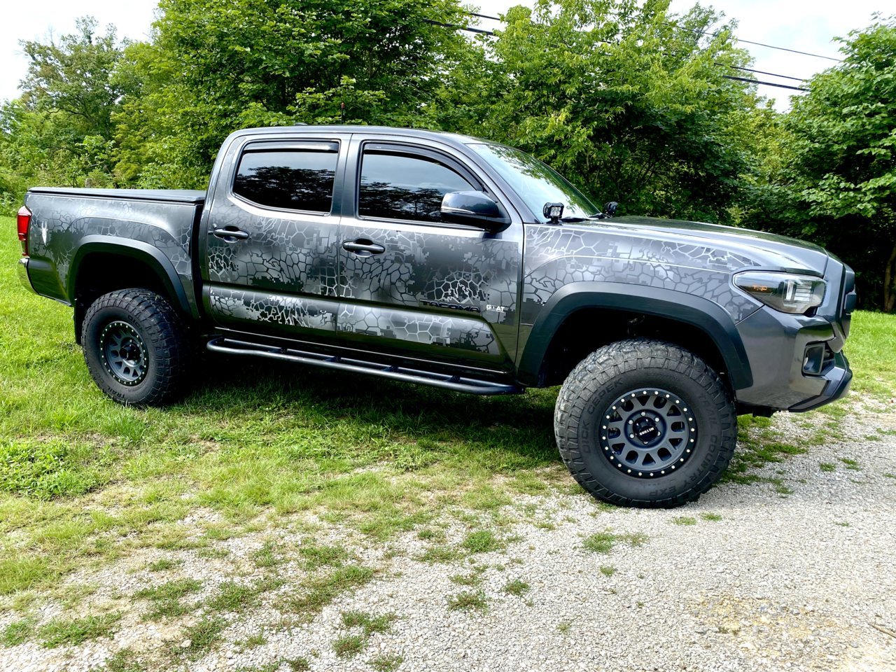

    I'm currently running my cab mount with 285/75/16s. I like the tire size and would like to keep these rubbers. It's the wheel I need to change before Rush and possibly CMC lol

    I don't think the wheel is going to fix that part of rubbing, but maybe it will

    Decreasing backspacing will actually make it rub on the cab mount worse, as youre increasing the length of the pendulum.
    Increasing it will help for the opposite reason, but then you risk uca clearance issues.

    When I went 285/75 I was still on stock wheels, lifted but stock UCAs and 1.25” wheel spacers. I rubbed my cab mount a fair amount. When I bought my methods my rub went away unless I’m really flexed out or land hard up front.

    Good feedback. Increasing is my goal. I'm +25mm stock wheels and 32mm spacer, so I'm at a -7 right now. I'm hoping when I try Stevens 0 offset wheels I'll have less rubbing, but surely I'll be closer to my UCA

    Most everyone on a factory wheel of 25/30 offset is running a 1.25" spacer with 285 tires, and has a CMC.
    I don't understand why you're so against it. Don't ever plan to go to 34/35 tires then...

    I'm not so against it. I just want to try one thing at a time. If I have to cut, I'm fine with it. But it's going to be my last option.
