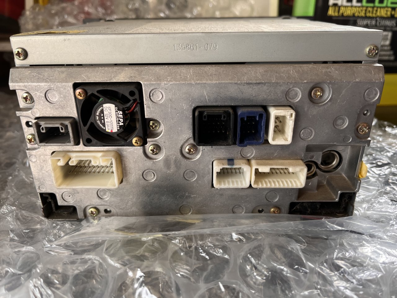

    Anyone know if there is a wiring harness that will adapt a 2004 4Runner with the JBL Synthesis system back up camera plug to a newer scion T10015 head unit?
    I did the scion head unit upgrade, got all the other wiring done so everything works (radio, Bluetooth) but there was nowhere on the new head unit to plug the back up camera wiring.
    So here is the oem (old) head unit back:
    I believe it’s one of top three connectors (black, blue, or white… none of those could plug into the new head unit). Here is the back of the new head unit:
    Just wondering if there is a way to get the backup camera working on the new unit (scion T10015).

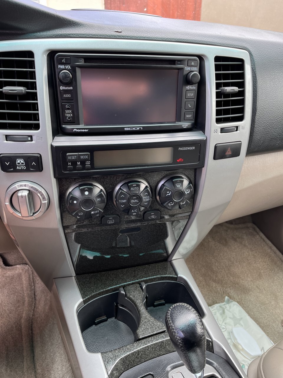

    here’s the installed final product:
    Obviously I’ll have to take it all apart to figure this out.

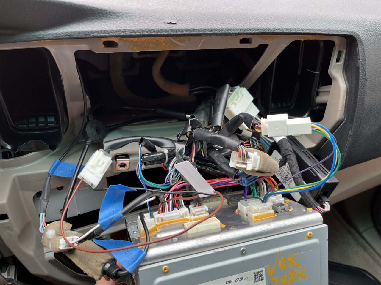

    Got the new custom auto harness house harness installed. Still no backup camera. So I’m waiting for the company to write back their thoughts good news is while I was in there I adjusted the TYTO-01 harness potentiometer and damn it totally changed the quality of the sound. So the sound of the new head unit is dialed in, just got to figure out this damn backup camera!
    here’s the back of the head unit with the new harness, anyone notice anything blatantly wrong with the installation?
    The new backup camera harness is the bottom right of the pic then the black and brown wires trailing off that (for the reverse signal). As you can see i installed the brown wire into pin 2 of the 28 pin connector. Pin clicked in and everything so it should be seated correctly. The other two connectors on this harness i just plugged into the only two remaining connectors that would fit into the new harness female connectors.

    Autoharnesshouse replied to my email and asked if i can verify through the Head Unit settings that its registering when i put the vehicle in reverse. However, i cannot seem to find the head unit setting that shows me this. I googled it for other head units and know what he's looking for... like a system setting screen that shows "reverse - Off" when not in reverse or "reverse - on" when in reverse. Unfortunately, can't find that setting.
    So basically there's no way for him to be sure his wiring is working correctly, or if the head unit for some reason just isn't registering that i've put the car in reverse.
    Any ideas?
