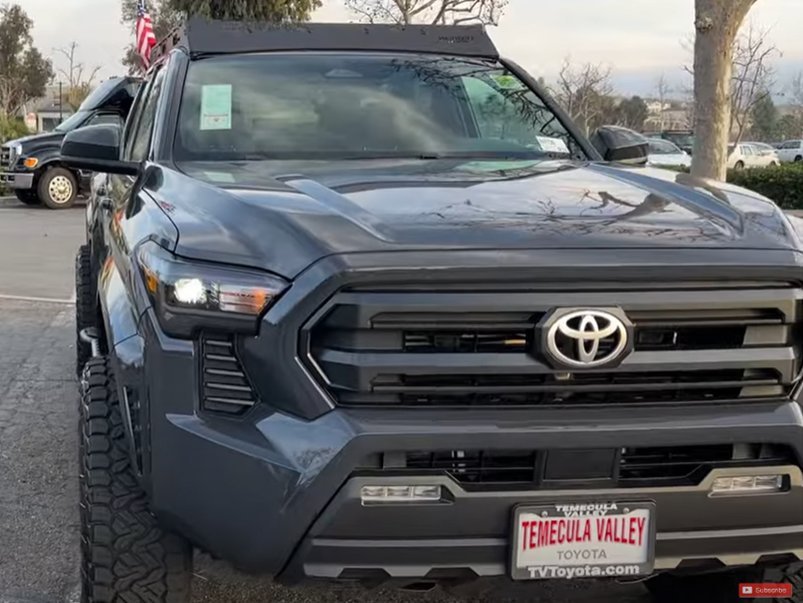

    We were able to measure a few and we found that the Pro and the Trailhunter have wider flares. The +00 will better suited for these models (depending on your taste). I think tall skinny's (255/80R17) might fit well on non Pro/TH with 17x8.5 +00. The 8.5 +00 has a good amount of poke with 285's. See grey truck below.
    If anyone takes delivery on a 4th gen and wants to run 17x8.5 +00 shoot me a PM. I'll hook you up with a big discount on either of our styles in exchange for a little content.
    Here are the trailhunter pics we got when we got our sneak peak
