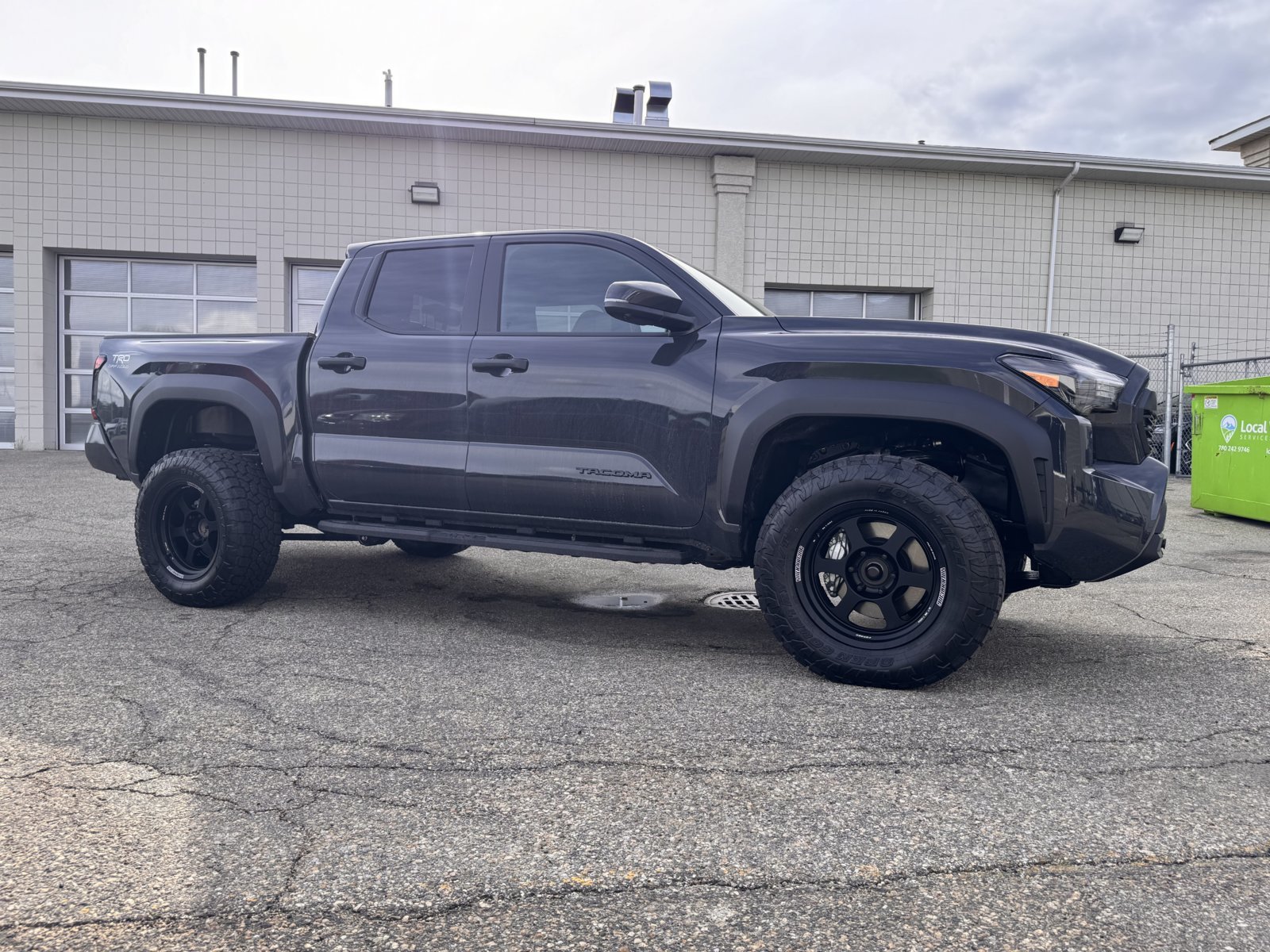

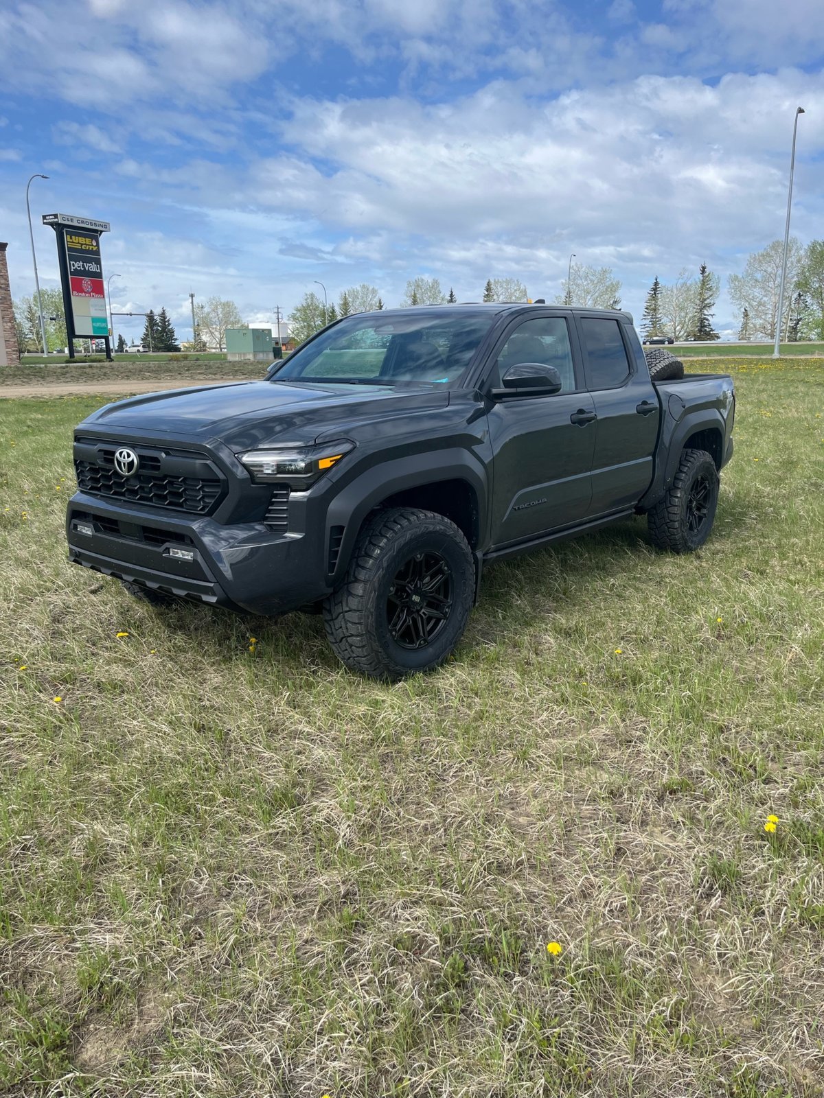

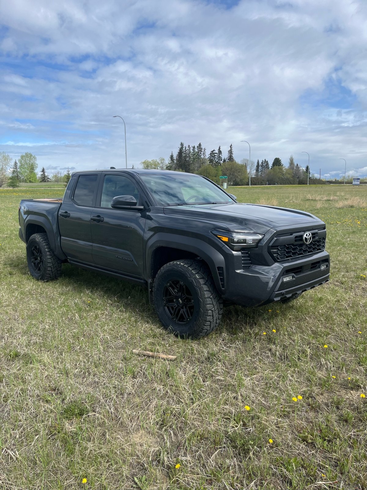

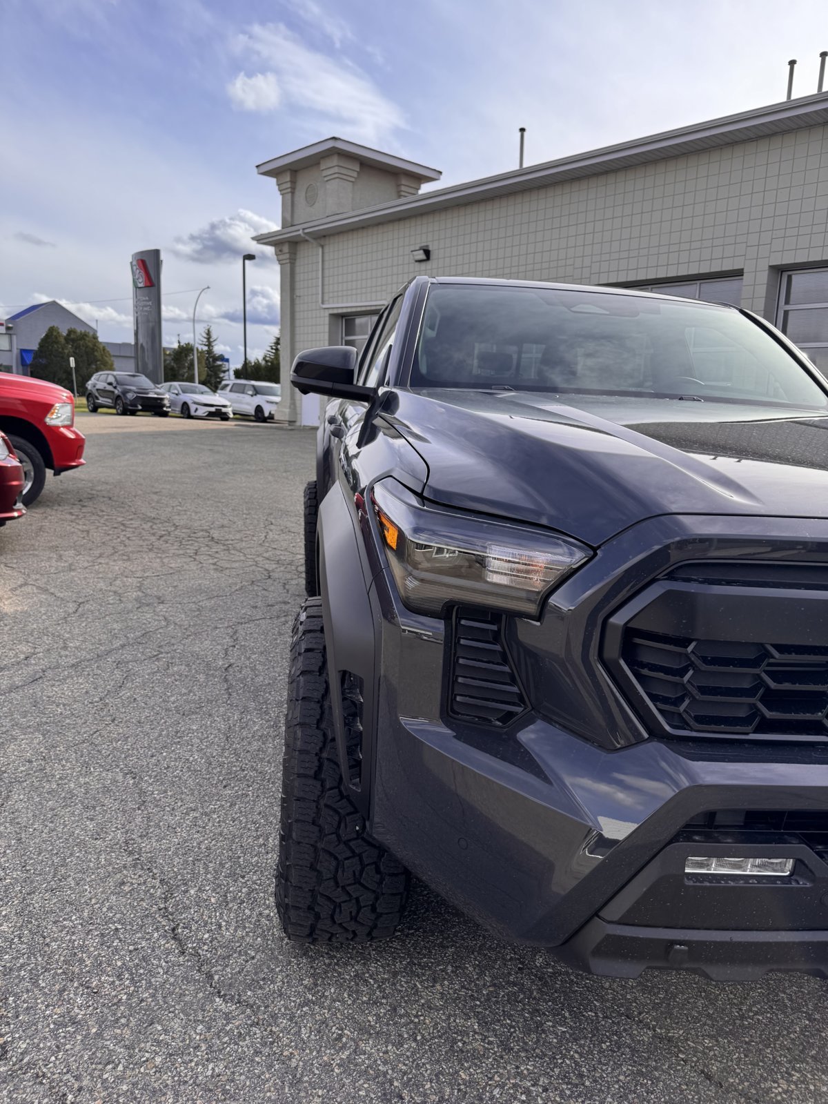

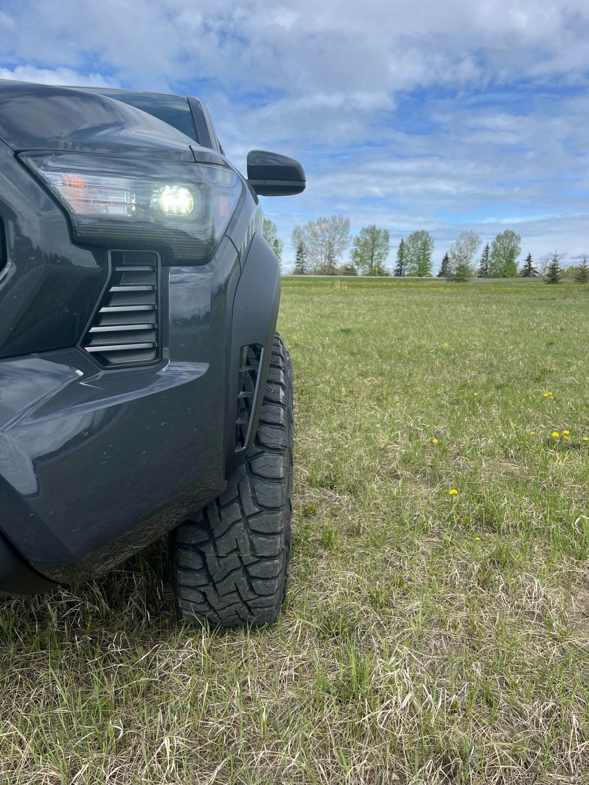

    Here’s another hubcentric option. Fast HD Recon 17x8, +20 offset, 95.1 hub, weighing in at 24.8 lbs. Wrapped them in Toyo Open Country R/T tires 285/70r17. No rub at full steering lock or ripping through a very bumpy field by my place. Very happy with the setup so far and looking forward to getting it dirty on some real trails once work settles down next week.
    Truck is completely stock, I was thinking of levelling it, but after seeing how it sits with the stock wheels and tires in the bed (which is probably around 250lbs) I intend to keep the suspension stock for the time being. I’m sure it will be very capable off road as is.

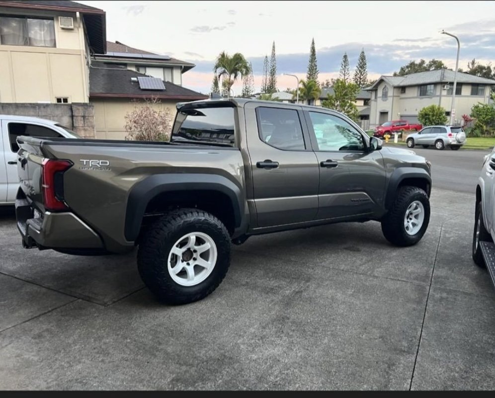

    18x9 +0. Love the poke and had to remove the mud guards. Going to get a 2 inch level kit soon. No hub rings on this right now.

    These trucks are already too wide IMO, I don't understand the massive wheel poke people are going for unless they're simply mall crawling.

    They'll be changing their tune when their paint is destroyed here soon.

    Orange is cool, the Bronze - oh nooo....

    Looks good, liking the poke!
