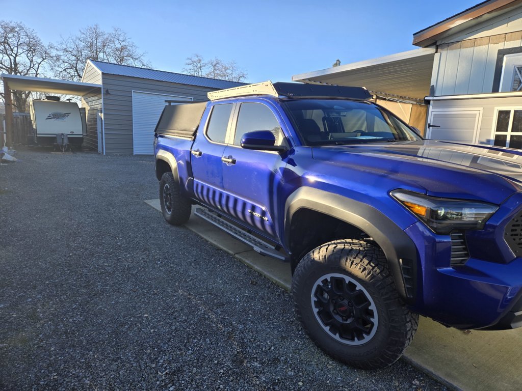

    gemiv19
    gemiv19 Well-Known Member
    Mar 24, 2019
    #287815
    411
    Ted
    Central Point OR
    2024 DCLB TRD OR Blue Crush
    Totally Stock for now
    I started with a leveling kit, ran it for about 6 months. I then installed an Icon Stage 3 lift. I only lifted a total of 2 inches. I have had zero issues with sensors and did not Calibrate anything after the lift.20250125_160302.jpg
    PUMPKINKING and CMillTacoma[OP] like this.

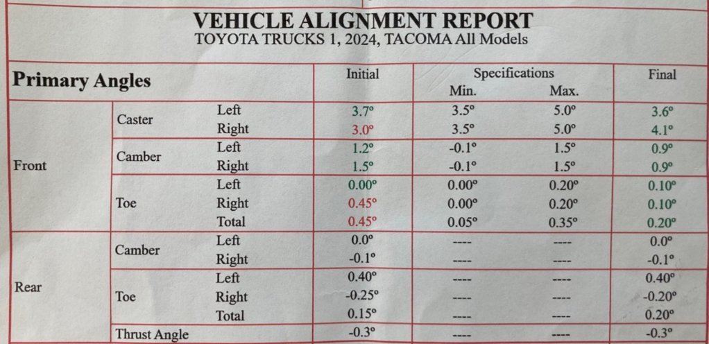

    Decided to get an alignment after installing the Alldogs front leveling springs. I marked the cam bolts prior to installation and used them when tightening everything up. Even still, I had a sense things weren't quite right.
    Here are the results of the alignment. Camber wasn't out as much as I thought, but toe was. Worth the $125 to me.
    Also, note that rear toe is out. Don't think there's a way to adjust that on a solid rear axle, but interesting.
