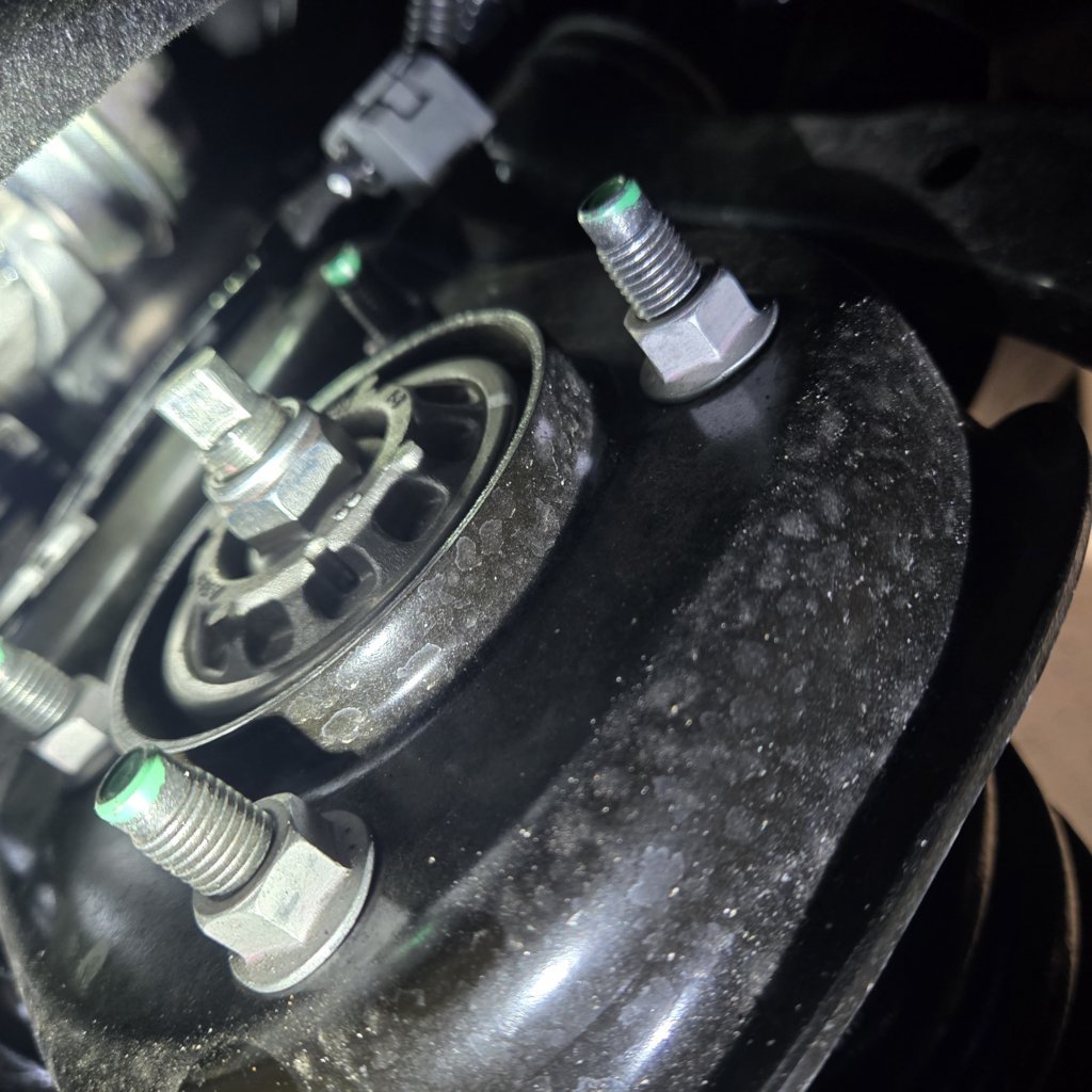

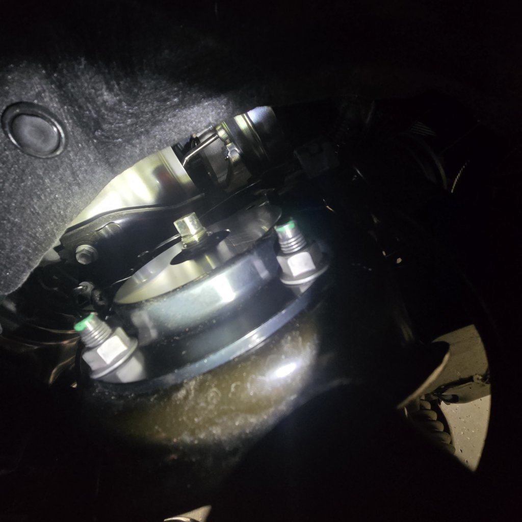

    I installed them on mine. Quick and easy install
    this video from Icon was pretty informative. I know this isnt an issue on the Trailhunter as they have a different setup. Mine is an Off Road Model
    As stated above, cheap insurance

    I didn't see a change on my Off Road I picked up in July the day after it was delivered from the factory. Maybe there is something I can't see, but it looked the same from the top as the one that failed.
    By pressing those components against the steel plate, they have no room to move which is what caused them to break.
    Cheap insurance for me.

    I am an engineer and appreciate the design. The 4 bolts tie it snug against the collar leaving no room for slippage. If there was a gap, like you said it would not work.. I noticed the fit when I installed it.
