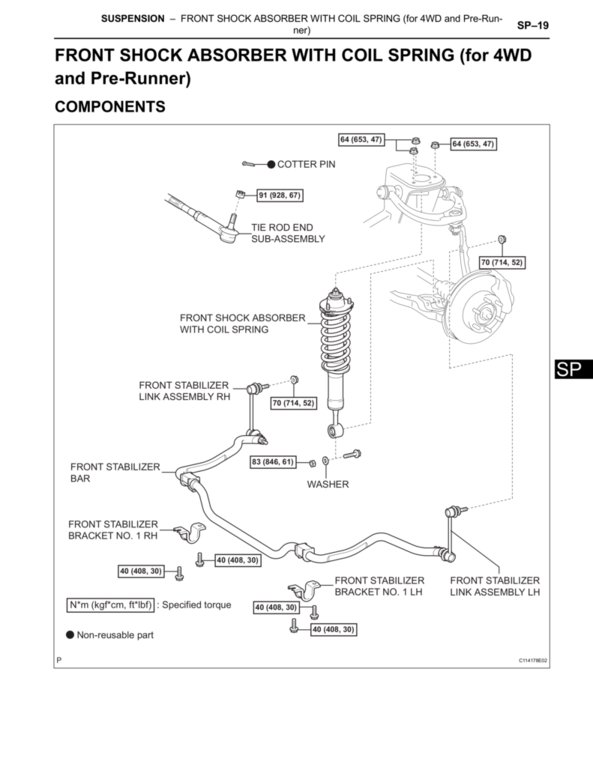

    Its approximately 47ft.lbs, at least that’s what it was on the second and third gens
    Will be tough to get a torque wrench in there though

    icon replied to me yesterday.
    Factory torque spec is 47 ft. lb
