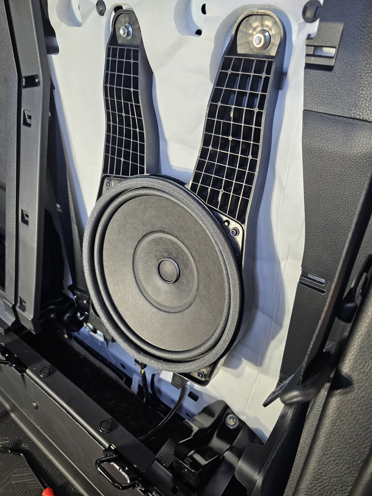

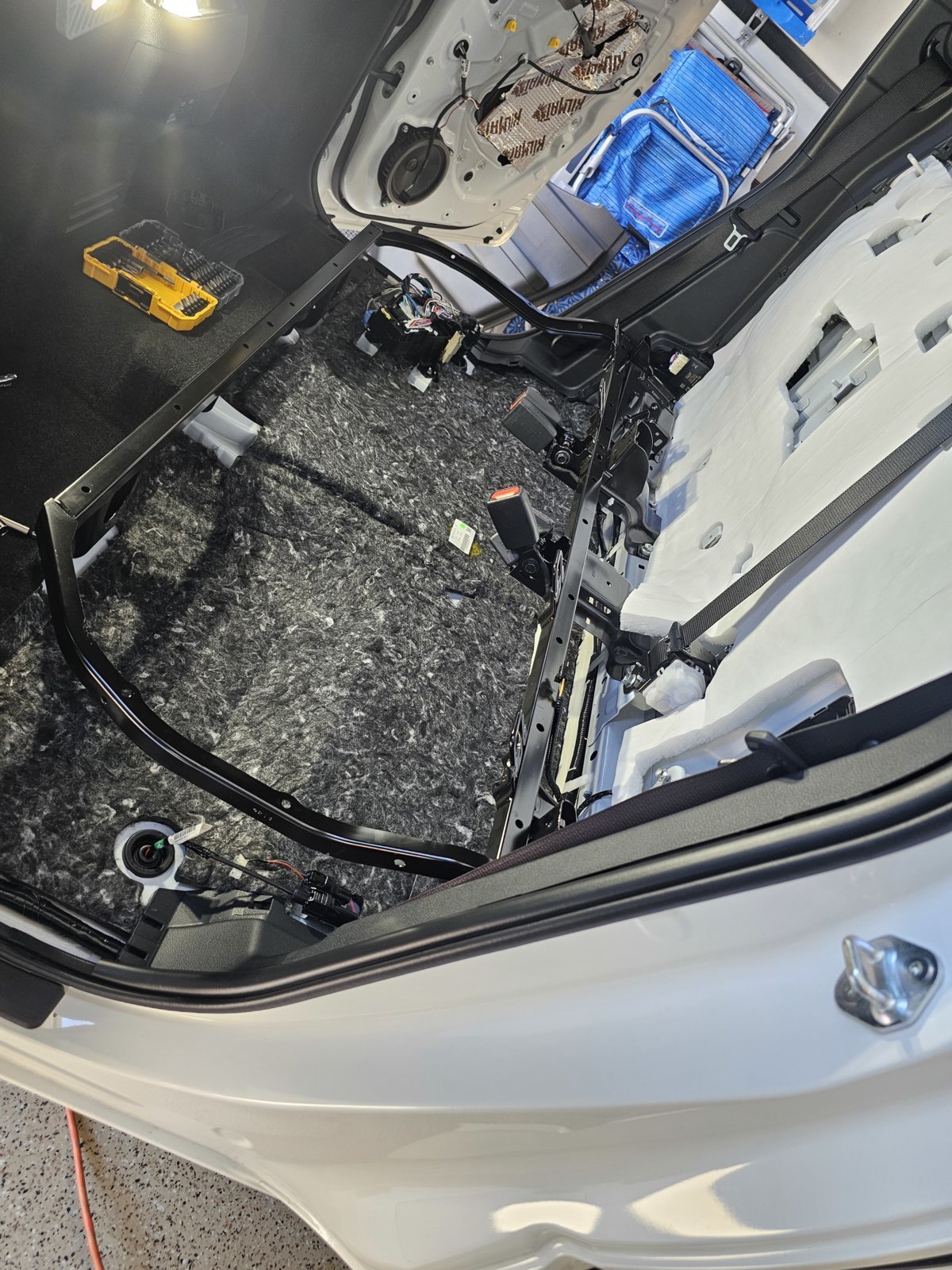

    I am not thrilled with the JBL system, I took the back of the truck part to see what we are working with and installed Kilmat Sound Deadening Mat.

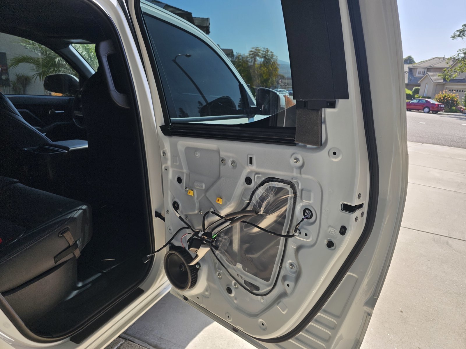

    The hardware in the rear doors is hidden, pop off the covers behind the handle and the window switch assembly to expose the screws. There is one screw that needs to be removed from the backside of the door paneling, attached to the handle.
    The rear seat had four bolts and lifted the seats out. The rest of the interior was basic snap and pull, one of the easiest gens to disassemble and reassemble.
    The rear speaker 6" is lighter than a feather, so it is going to be replaced.
    The 10" sub(par) and the surrounding area have plenty of room to either put in a replacement 10" or a box. And there is plenty of room under the seats for an amp or two TBD.
    I intend to replace the door rear door speakers and sub with the JL C3 series and get the matching components for the front bass and tweeter. I intend to test the sound quality with the stock AMP and heard unit to determine if I am satisfied merely upgrading the speakers or installing a sub box, and amp(s). I am looking to overdo it this time, I have posted pics of the rear doors and subwoofer. I will update as I go along with adding speakers and sound quality.

    How difficult was it to pop the inner door panel off? and, did all of the plastic fasteners survive? I ask this for reasons other than sound systems, although I an planning a similar sound reduction system. I used Kilmat in my Dodge diesel, and it really helped.

    The panel popped off easily after removing the 3 screws, and one inner screw. See pix.
