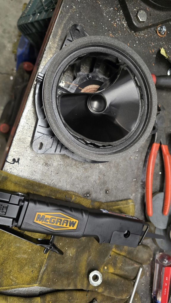

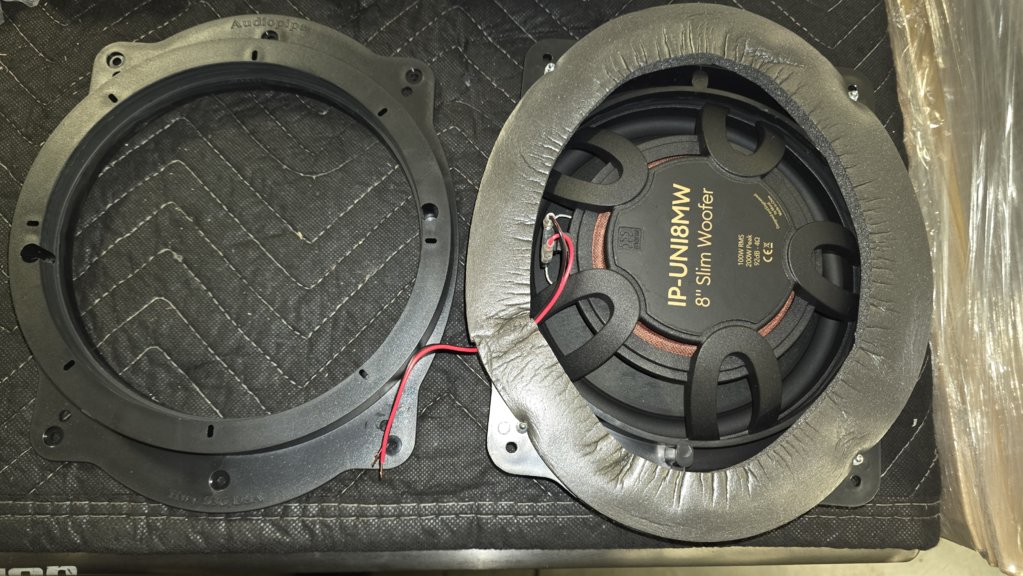

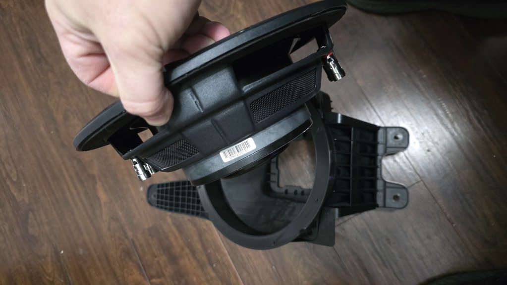

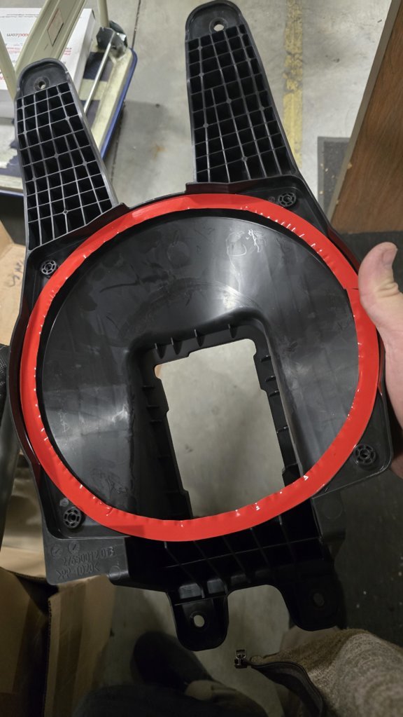

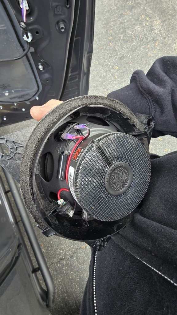

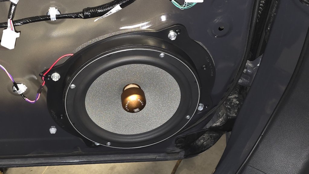

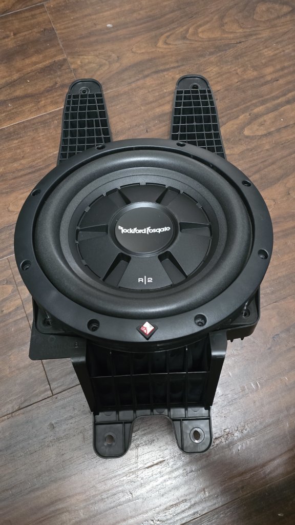

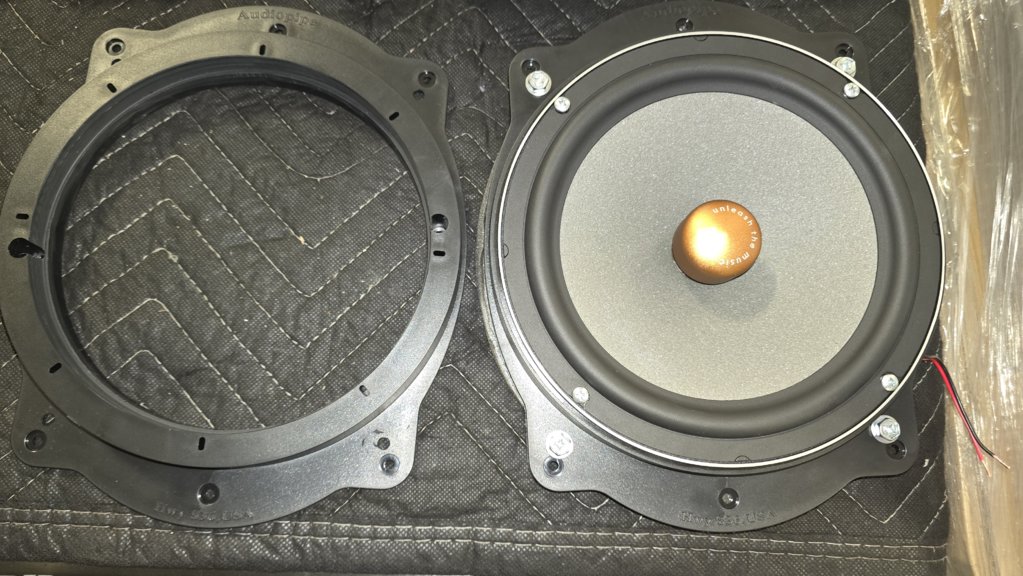

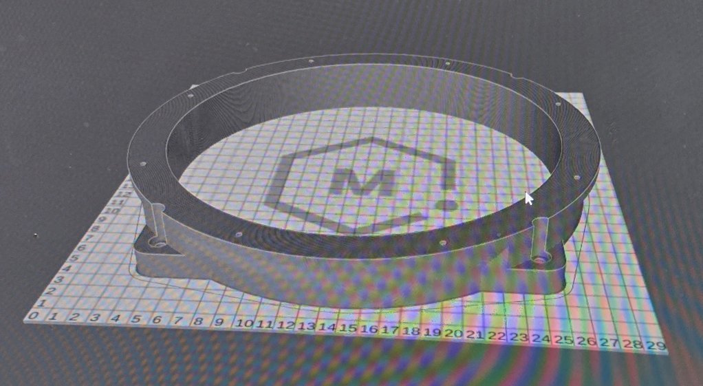

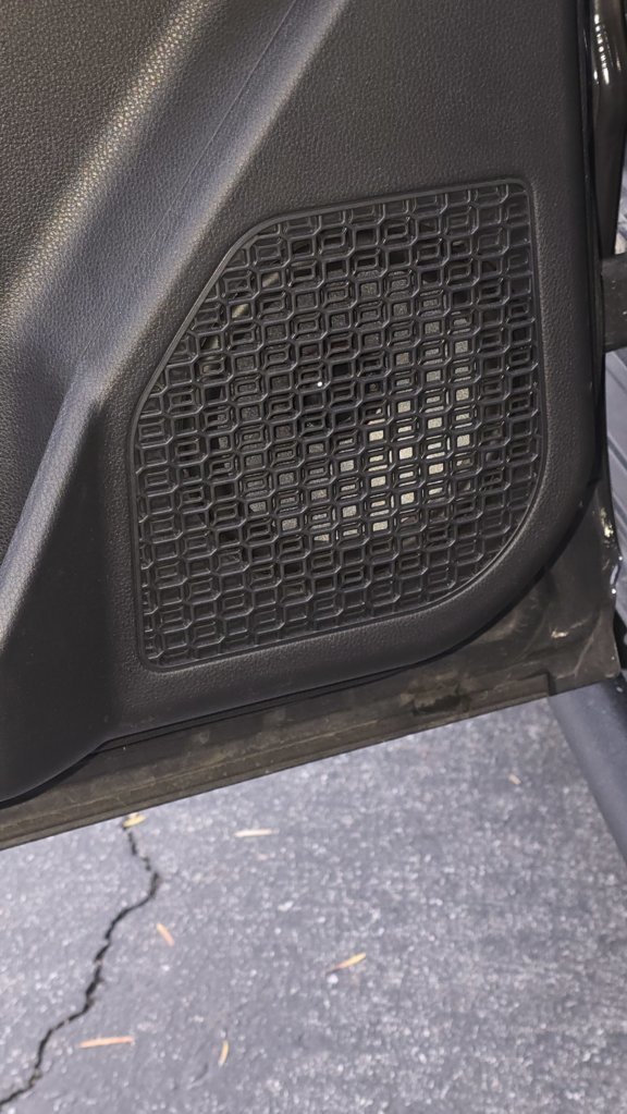

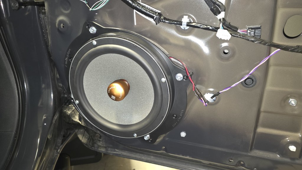

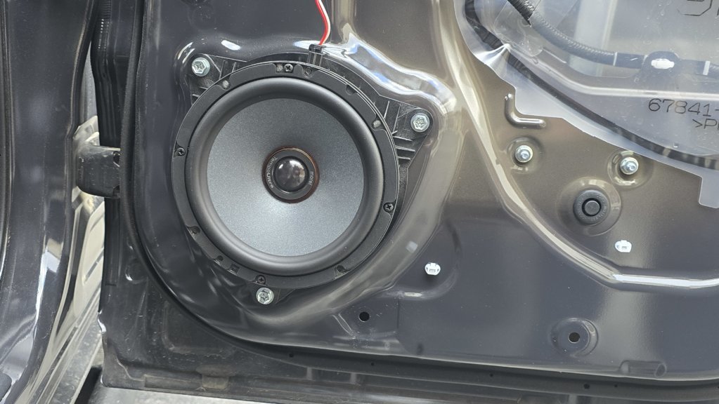

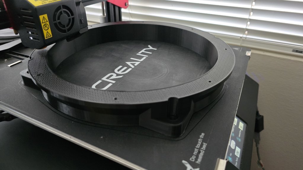

    I recently did some stuff to my 2024 Tacoma JBL system that you guys might be interested in. I'm having fun revisiting my car audio installer days from the late 90's at The Good Guys :)
    I ordered a Helix V Twelve DSP MK2 (75wrms@4ohms X 12 channels) amplifier from the UK, hooked it up with 11 high level inputs coming from the stock JBL amplifier (it took like 350ft of 14ga wire), and initially hooked it up to all the stock speakers. The DSP and crossover functions of this amplifier are unbelievable! I was amazed how well I was able to make this thing sound with all the stock speakers and a few hours of tuning. I could have stopped there, it honestly wasn't terrible at all. It played far louder, cleanly, than any stock speakers I have ever had. Even the removable center channel works great with the Helix amplifier. But, I wanted more. I got a set of Morel 8" 2-way component speakers, and I modified some 6x9 to 8" speaker adapters (using my lathe) for the front doors because the Morel 8" woofer is a non-standard diameter, and the holes in the adapters were just a little off of the stock door holes. The Morel 1" tweeters pressed right into the stock a-pillars, and I just zip tied them in using the little tabs that hold the stock tweeters. I ordered a pair of One Audio WB3.e 3" midranges, they are made to order and are supposed to ship out by tomorrow. The WB3.e midranges will bolt in the dash in place of the stock speakers with some simple adapters I will make. Then it was on to the sub, I didn't want to put a ton of money into this sub experiment, so I went with a $129 low-profile Rockford Fosgate dual 4 ohm sub, and designed and 3d printed my own adapter to mount it to the stock sub bracket, which is unbelievably an infinite baffle setup piped out the back of the cab?!? I want to shake the hand of the designer of the stock sub, that idea was just freakin cool. I really need to dynamat the back wall, but you wouldn't believe the sound coming out of this plastic bracket subwoofer. Back in the day I never thought I would buy a new Toyota truck and be able to bolt-in an 8" 3-way custom component speaker set and a 10" sub, with 11 channels of DSP and active crossovers, without drilling even one hole in the truck, and never taking the stock stereo out of the dash. LOL The sound quality from the stock amplifier is really good, especially considering I am using Spotify wireless on Android Auto. A roll of 3/4" roam-rubber tape from Home Depot worked great for the door speaker adapters, and also to thicken up the seal from the sub bracket to the back wall (a little extra tension stopped it from vibrating). This is still a work in progress, but its been fun so far!

    On Friday I upgraded the rear speakers with some Morel 6.5" Tempo Ultra Interga MKII coax speakers. I cut the center out of the original speakers, and I soldered the leads to the terminals for the voice coil, so it's Plug and Play.

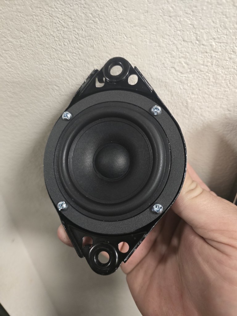

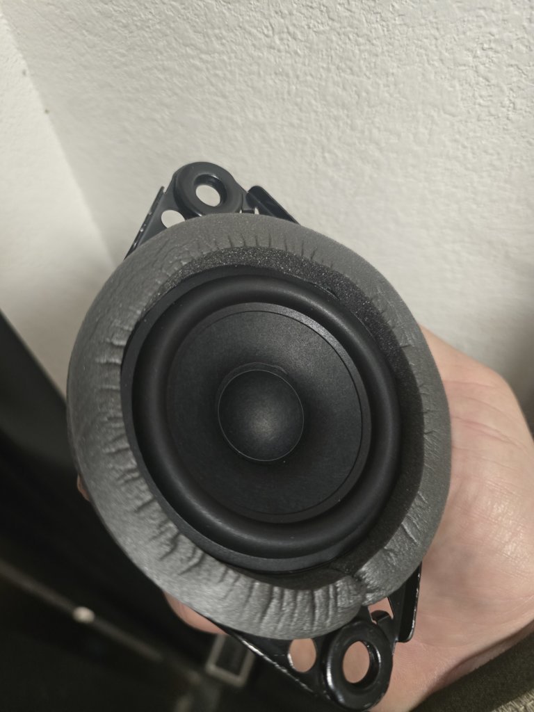

    I added some midrange speakers today. These little 3" mids sound amazing!
    https://www.oneaudiousa.com/product-page/wideband-3
    Like I did with the rear speakers, I cut out the center of the stock midrange speakers, and made it into a PNP mounting bracket for the new WB3.e.
    Anything is possible in car audio with a 10mm socket and a Harbor Freight air body saw.

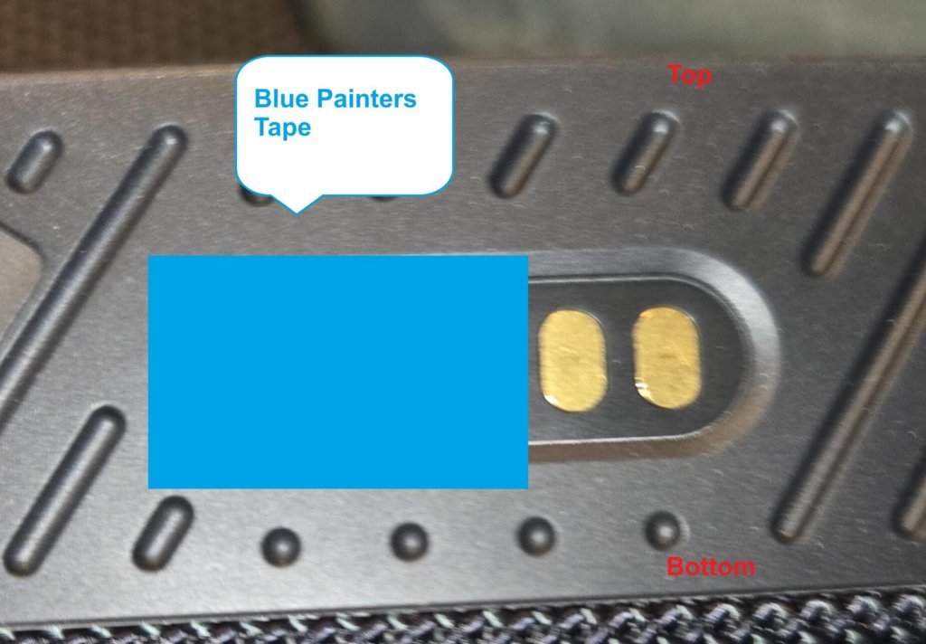

    Anyone know what terminals need to be covered to completely eliminate all sound from the center porta potty?
    My ap4 interface didnt completely shut it down, it still has a whisper of sound to it,
    Would like to leave the charging terminals exposed but put electrical tape on the others....
    Think it was posted once but good luck attempting to locate it, I tried...

    1) The 8" woofer -> did this fit without any major modifications? Did you need to build new brackets? How do they sound? Any pictures in the door?
