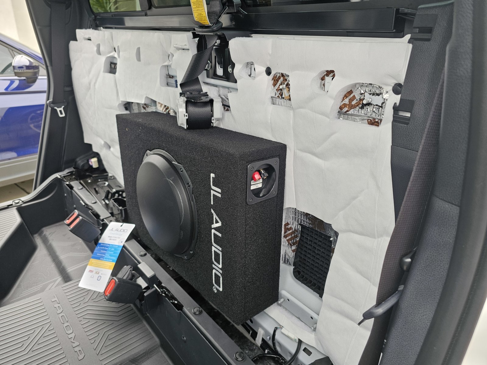

    The JL box CS110LG-TW3 21 x 14 x 4 7/8th is getting delivered today, I am hoping to make it fit, with a little modification if needed to the truck.
    I will take detailed pictures with the measurements of the rear as well to share with the group.

    Bob, your plan is to leave the rear plastics out correct?
    Would imagine you will have to.....

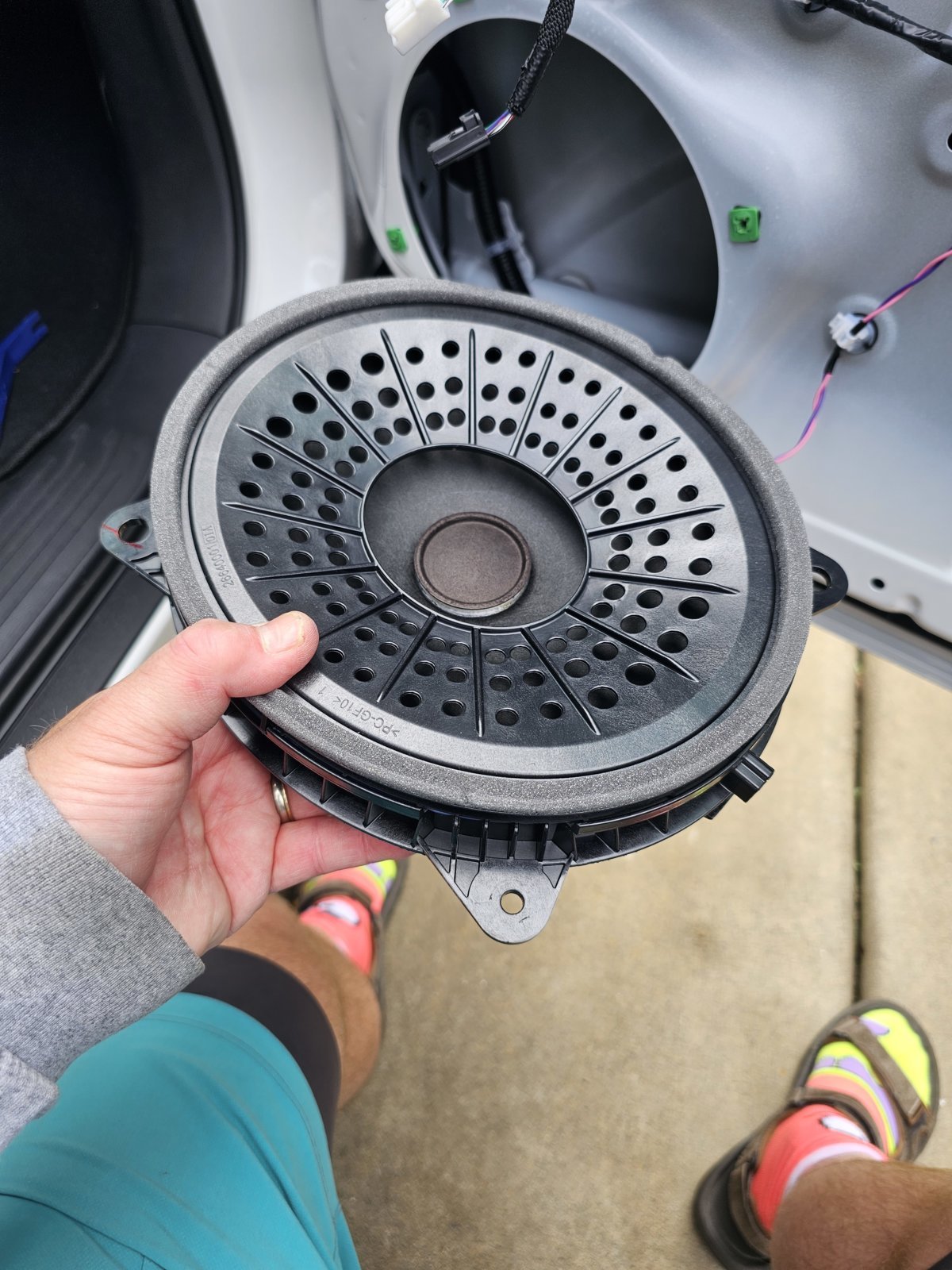

    No joy, not even close. The sub may end up under the seat. 20240425_121358.jpg

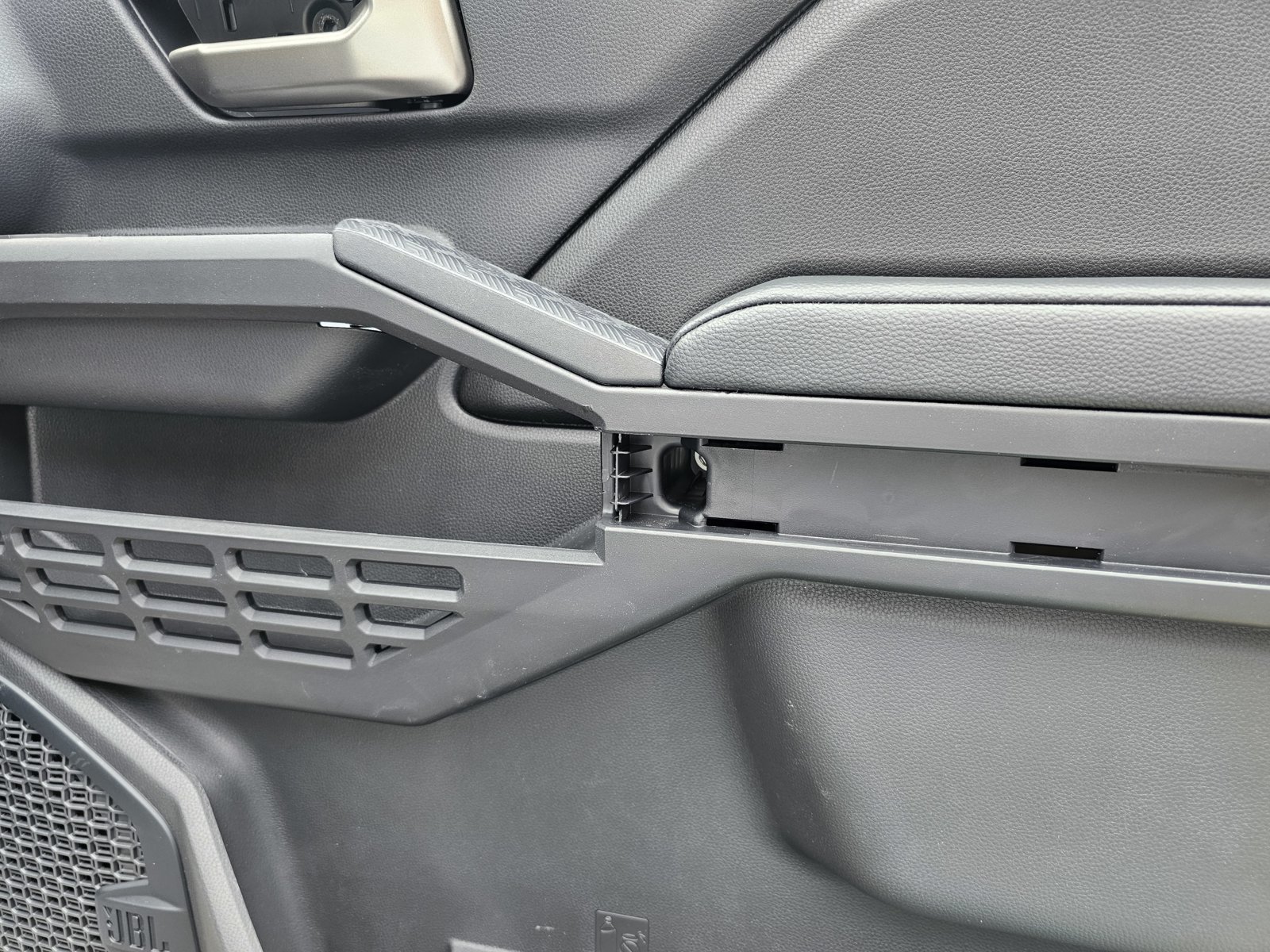

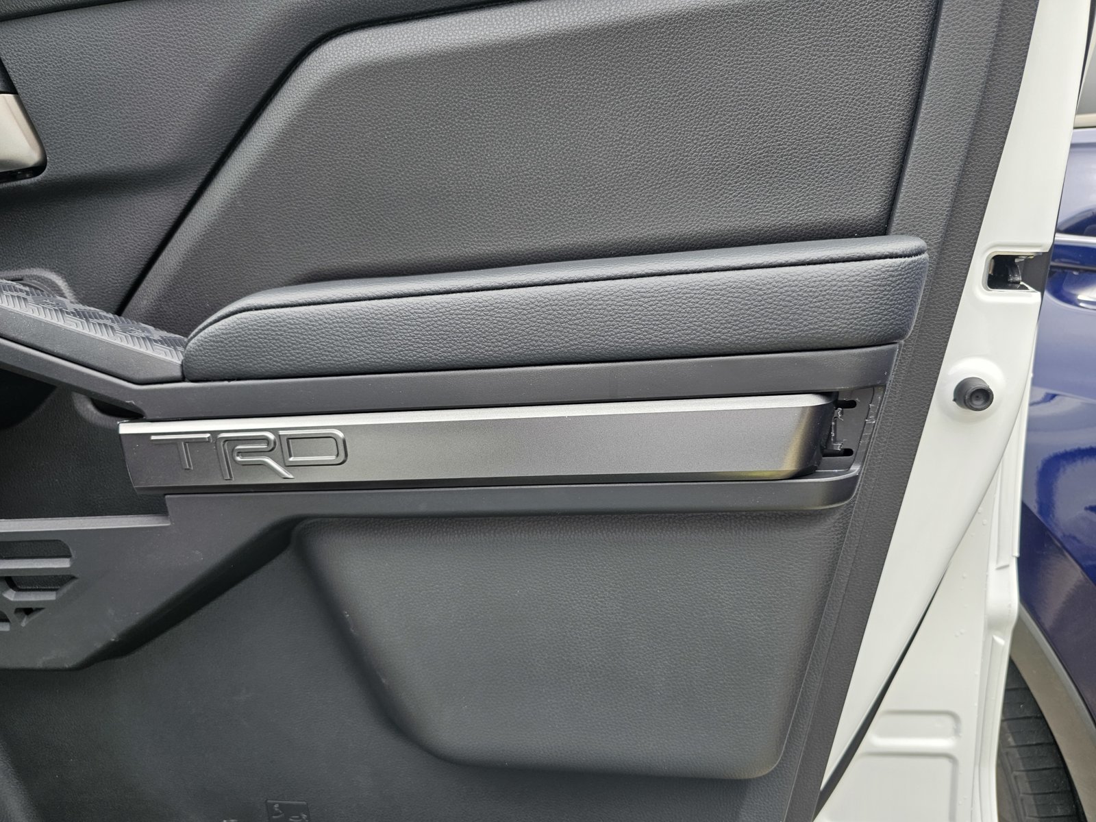

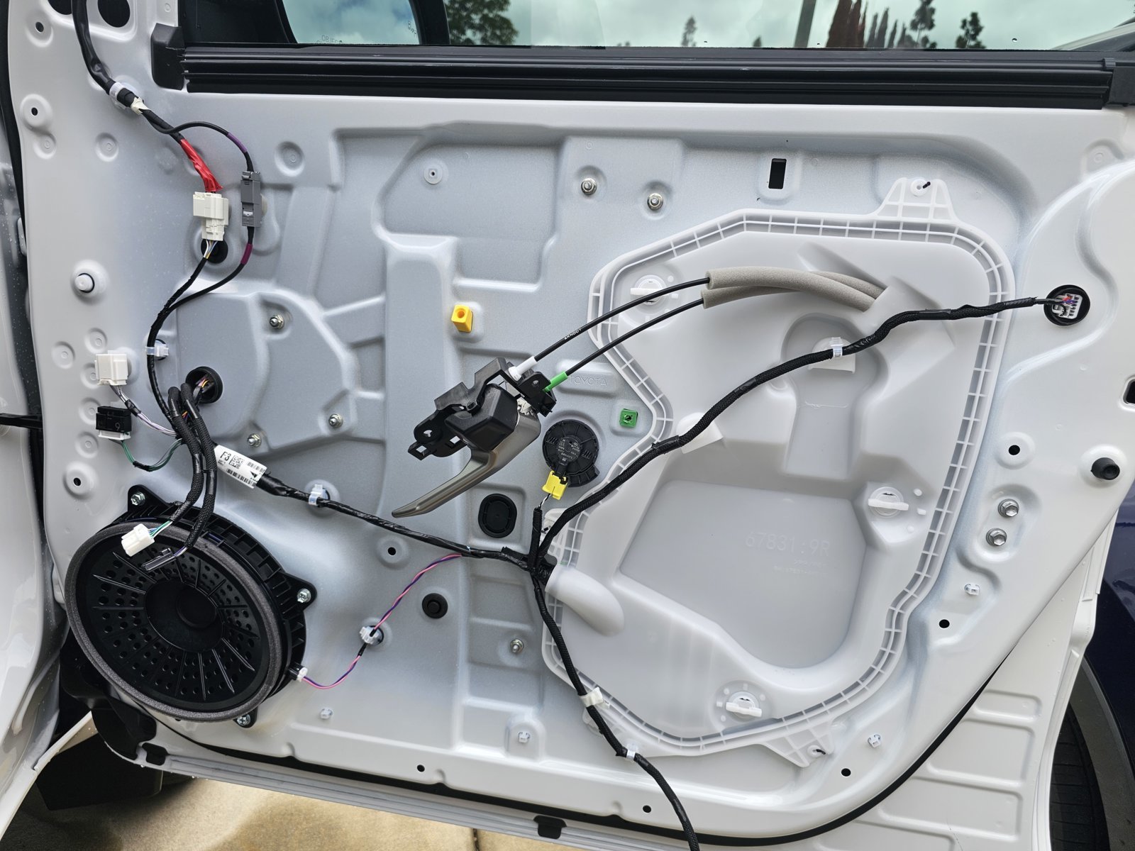

    The front doors were easy to disassemble; once I figured it out. . The final screw was accessed by sliding TRD cover forward, (easy once you know) along with removing the screws from under the door handle and popping out the window control. The matting was easy to install with plenty of room to work with. I received my 6x9 Infinity Kappas and plan to install them this afternoon. Still battling the sub. New pix uploaded to https://photos.app.goo.gl/ngPxb6VVYJSzKWYT9

    I’m surprised they’re truly have 6x9’s in the front doors, but not like I’ve done any systems lately, just seems odd to me

    interesting.... a sliding panel to get to a screw seems excessive. did they hire a dodge engineer for that one?
    the plastic panel on the inside of the door is interesting. i assume it is removable with a little twist of the nobs. did they put any sound deadening on the inner door? either way... that has to be better...

    There was no sounding in any of the doors, I am in the process of matting all four doors, and installing speakers.

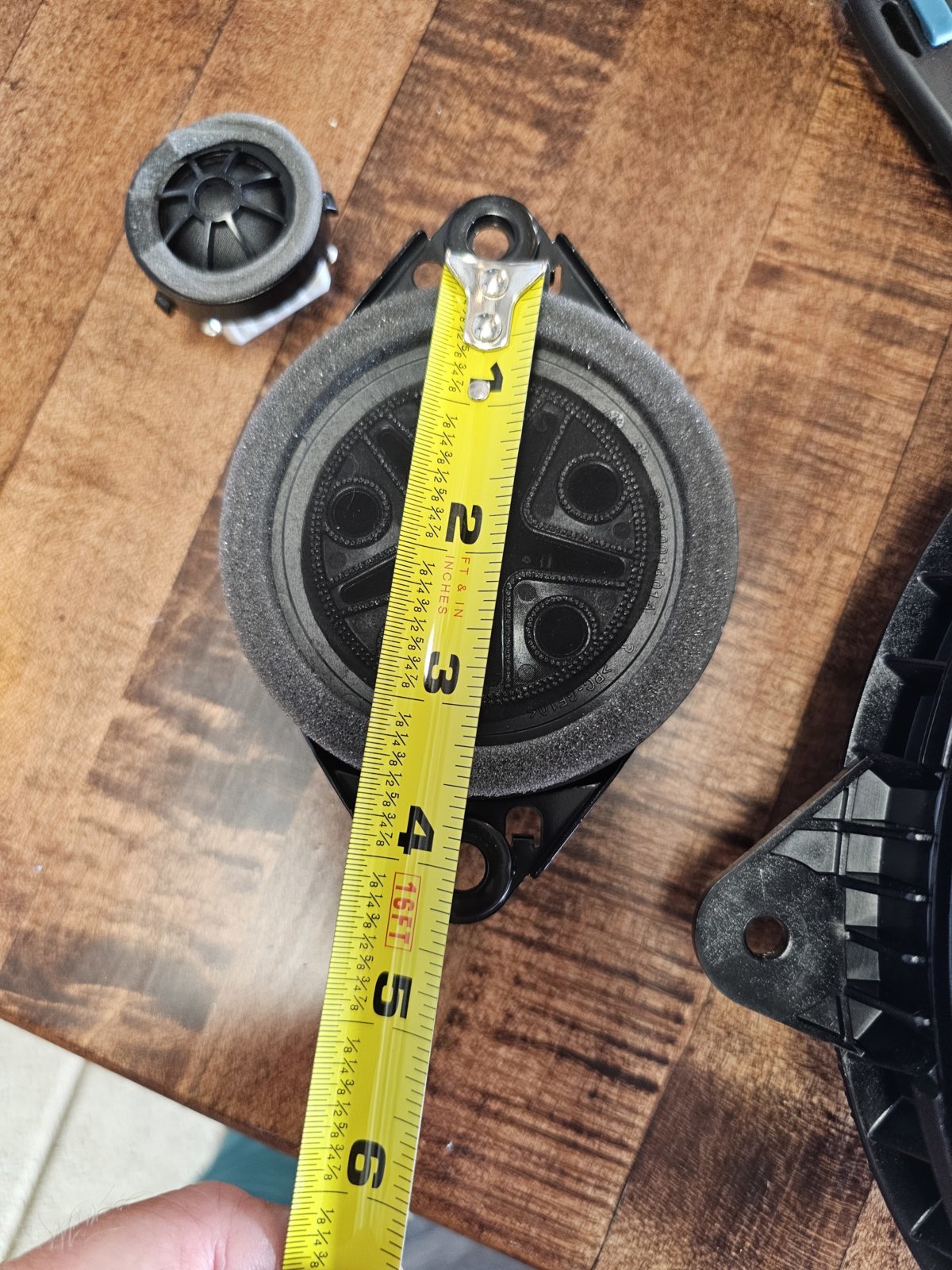

    I found another roadblock, I cannot run speaker wire from/through the front doors to the mids or tweeters in the dash. I am looking for the source input, to put the crossovers near the source and run wires to the mids and tweeters. Any recommendations on where to locate Toyota wiring diagrams?

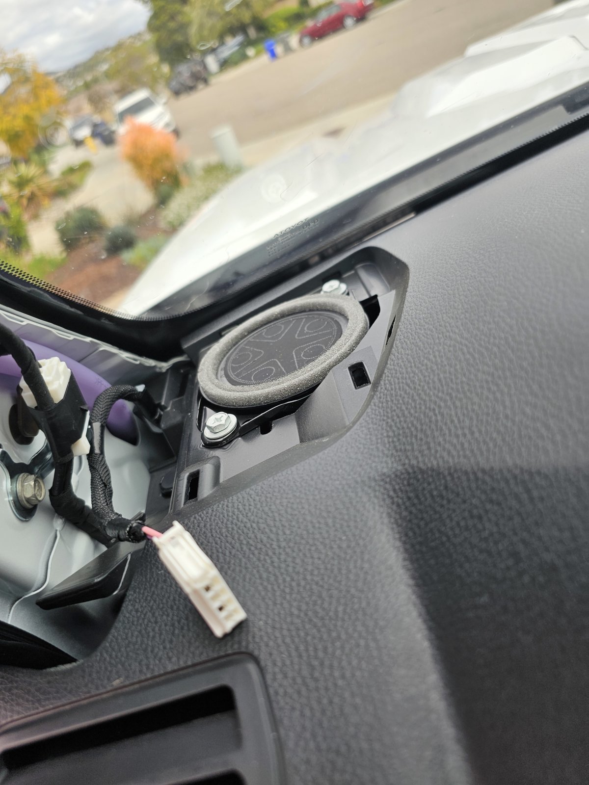

    Youre the man Bob, look at you going to town on this thing....
    Did the grills over the dash speakers come off easily by just popping the with a prying device?
    Obviously you have the pillar plastics off, but dues that grill also easily pops out?

    Mid covers popped right off, the whole truck is practically snap together.
