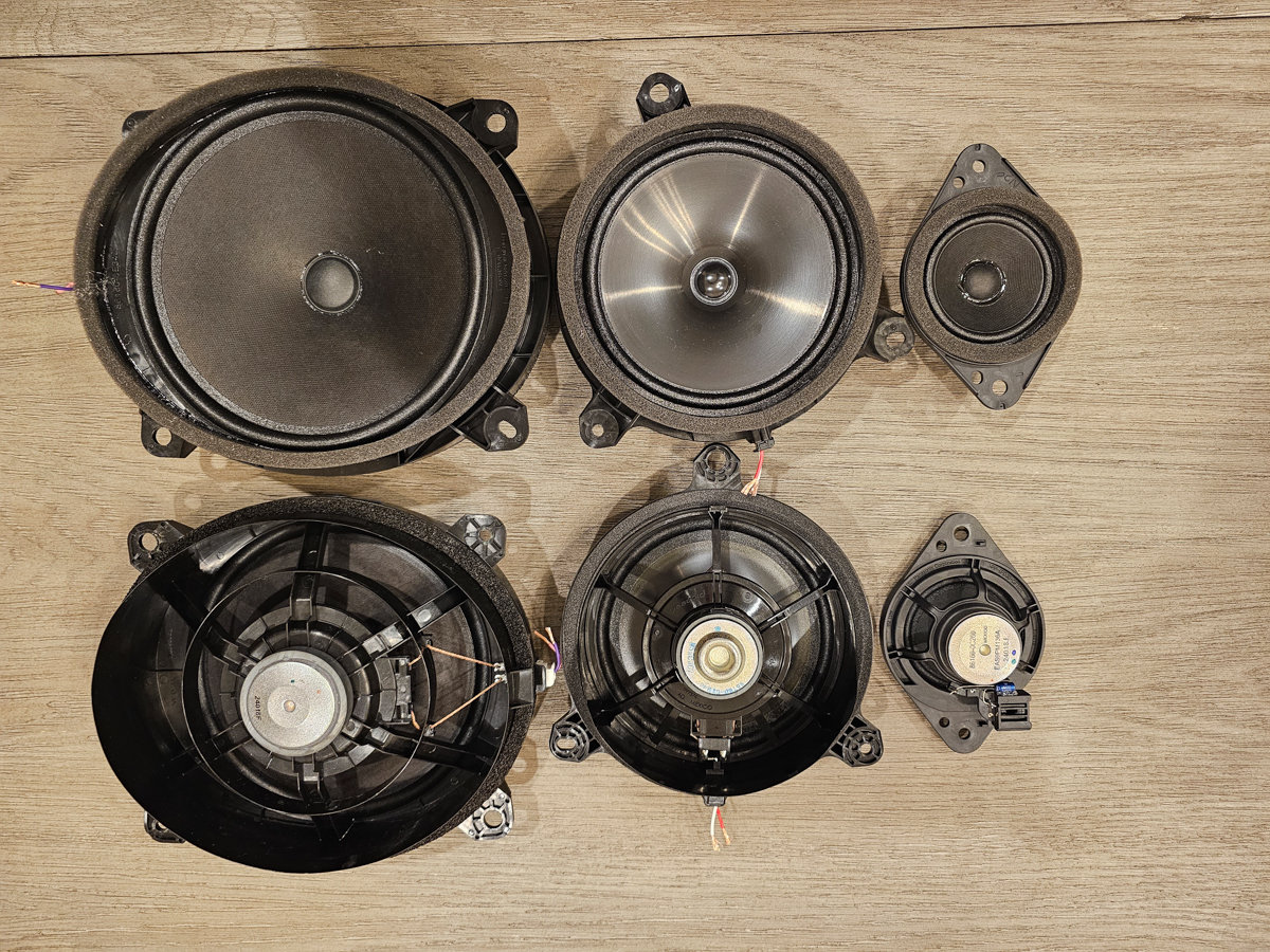

    BACKGROUND
    I bought a basic entry-level 2024 Tacoma TRD Off-Road because I thought the ~$9k upgrade to get the premium stereo, a larger infotainment screen and a few other things I don’t need or want was just too expensive. I don’t do any serious off-roading, I just do dirt-road overlanding for fishing and hunting trips. So, the base model works great for my needs. With the $9k I saved, I’ve opted to re-invest in three areas that mean more to me: a) replace the horrible stock audio system, b) install a roof rack with light bar and c) install a retractable hard tonneau cover with cross bars to carry my 9’ Scadden pontoon boat for fishing. The rest of my narrative focuses on the audio system.
    THE INADEQUATE STOCK SOUND SYSTEM
    The entry-level basic sound system design uses a JBL head and speaker components shared by Toyota and Subaru. The speakers consist of:
    · two 3” dash speakers, paper-coned, total weight each 4.6oz (mfgr'd by Panasonic)
    · two 7” round front door speakers, paper-coned, total weight each 11.6oz (mfgr'd by Panasonic)
    · two 5.5” round rear door speakers, poly-coned, total weight each 6.0oz (mfgr'd by Pioneer)
    [photo of OEM speakers, attached]
    [photo of OEM front door speaker location, attached]
    The speaker frames are molded plastic throughout and all are stamped as made in Mexico. The magnets in the speakers are drastically undersized and as such the voice-coil and cone travel is minimal as well, making the entire system sound thin, nasaly, low-midrange woofy and just plain horrible. They just aren’t designed to move air and make quality sound. To evidence the cheap, flimsy construction of the speakers, look at the total weight of each speaker noted above. I am a long-time musician and audiophile, so sound field clarity and definition is very important to me. That means punchy clear bass, clear vocals/instrument mids and crisp/clear highs with no semblance (think of a nasty hissy spoken “S”).

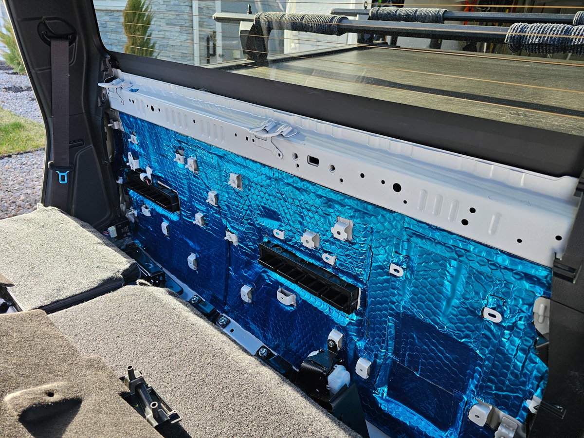

    FIRST THINGS FIRST – INSTALL SOUND DEADENING MATERIAL
    The road noise in the 2024 Tacoma is ear-numbing head-ache inducing horrible – no wonder they opted to design in a noise-cancelling unit. Before my audio upgrade, I took a 1500-mile road trip and found the road noise made my ears tired. I was a multi-million mile flyer during my working years and relate the road-noise in the 2024 Tacoma to be akin to airplane cabin rumble – both can just plain tire you and your ears out over a long-haul.
    To combat the horrible in-cabin road-noise, I installed sound deadening material on all outer metal surfaces that surround the passenger cabin. This included all doors, the back wall between the cabin and the truck bed and some of the floor. I chose Amazon Basic brand deadening material based upon this independent study: https://resonixsoundsolutions.com/best-sound-deadening-material-independent-testing-data/. I crunched the numbers and couldn’t beat the price-to-performance of the Amazon Basics brand.
    Just with the sound deadening material alone, it made the stock sound system perk up and I could hear more clarity and sound-field definition, but the nasaly upper-mids and woofy low-mids and lack of high-end clarity still existed.
    Lesson Learned – sound deadening material is THE FIRST thing you should do in any vehicle to reduce in-cabin road noise.
    [photo of back cabin wall sound deadening material installed attached]

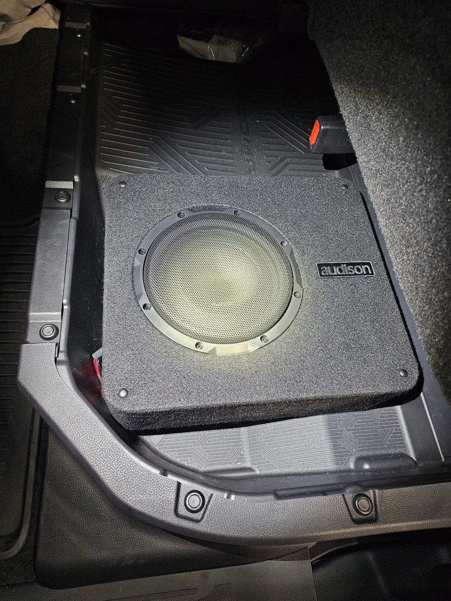

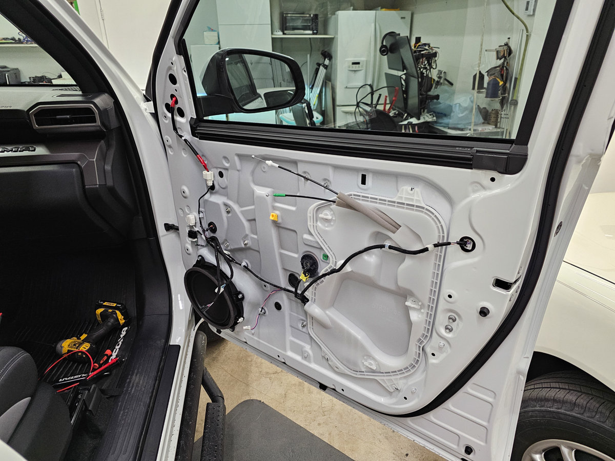

    THE SOUND SYSTEM I INSTALLED
    I opted to invest in a complete sound system over-haul, far exceeding even the best JBL system Toyota can offer. I had a local vehicle audio professional install these components:
    DASH TWEETERS: Audison AP 2 MV mid-high drivers (https://audison.com/product/ap-2-mv/)
    PASSENGER DOORS: Audison AP 8 woofer (https://audison.com/product/ap-8/)
    REAR DOORS: Audison APX 6.5 Coaxial mid-woofer (https://audison.com/product/apx-6-5/)
    SUBWOOFER: APBX 8 Active 8” subwoofer in enclosure, a 10-inch subwoofer wouldn’t fit the space (https://audison.com/product/apbx-8-as2/)

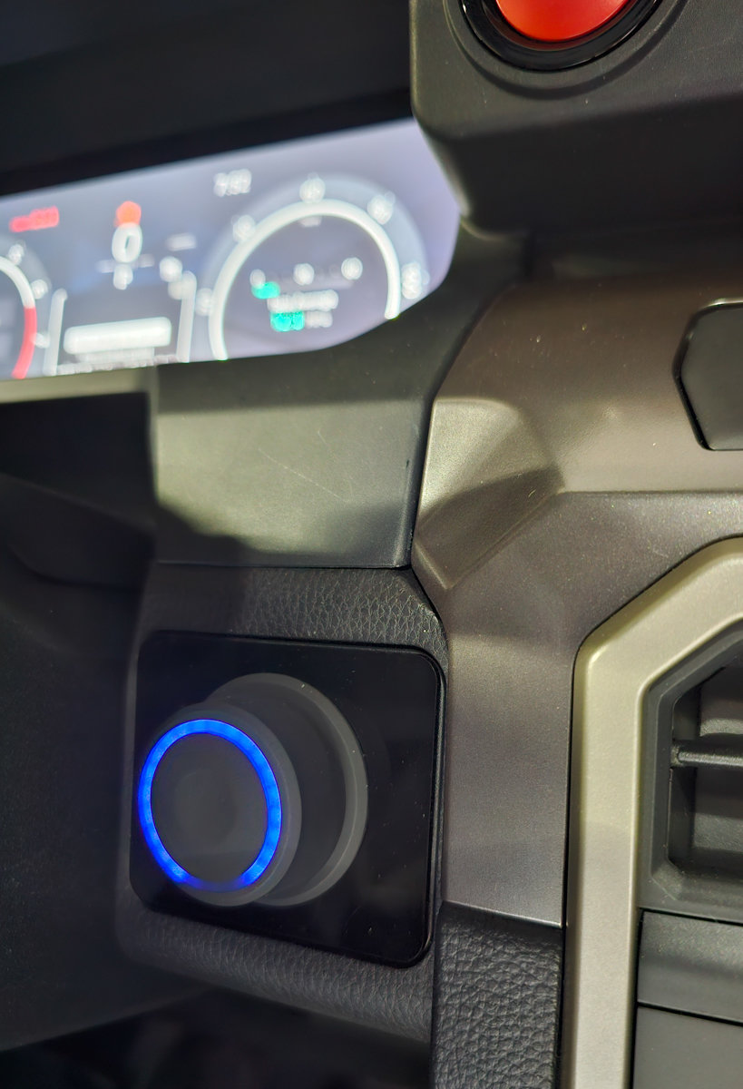

    DIGITAL REMOTE CONTROL: programmable remote sound controller (https://audison.com/product/drc-ac/)
    [photo of circular remote control installed, attached]

    The subwoofer enclosure was installed under the rear driver-side seat. It fit nearly perfectly with only adding a fabricated block underneath to support the enclosure. The downside of installing it in that location is it takes away some under-seat storage. A fair trade-off in my opinion.
    [photo of subwoofer and enclosure, attached]
    The programmable controller was installed in the little unused cubby hole on the dash just to the right of the steering column.
    After the install was completed, we took about 3 hours to completely fine-tune the system by placing a mic at ear level on the driver side and playing pink noise throughout. We used the very comprehensive Audison bitDrive software to tune the system (https://audison.com/bit-drive/) by eliminating phase issues and adjusting each speaker’s output to the Harman sound profile curve (https://dekoniaudio.com/articles/what-is-the-harman-curve/).
