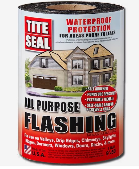

  19. Apr 30, 2024 at 9:56 AM
    #79
    BoBsworld21
    BoBsworld21 [OP] Well-Known Member
    Apr 13, 2024
    #447822
    61
    BoB
    2024 Tacoma Sport 4x4
    I used roof flashing as matting back in the day, once the smell went away it worked just fine.
