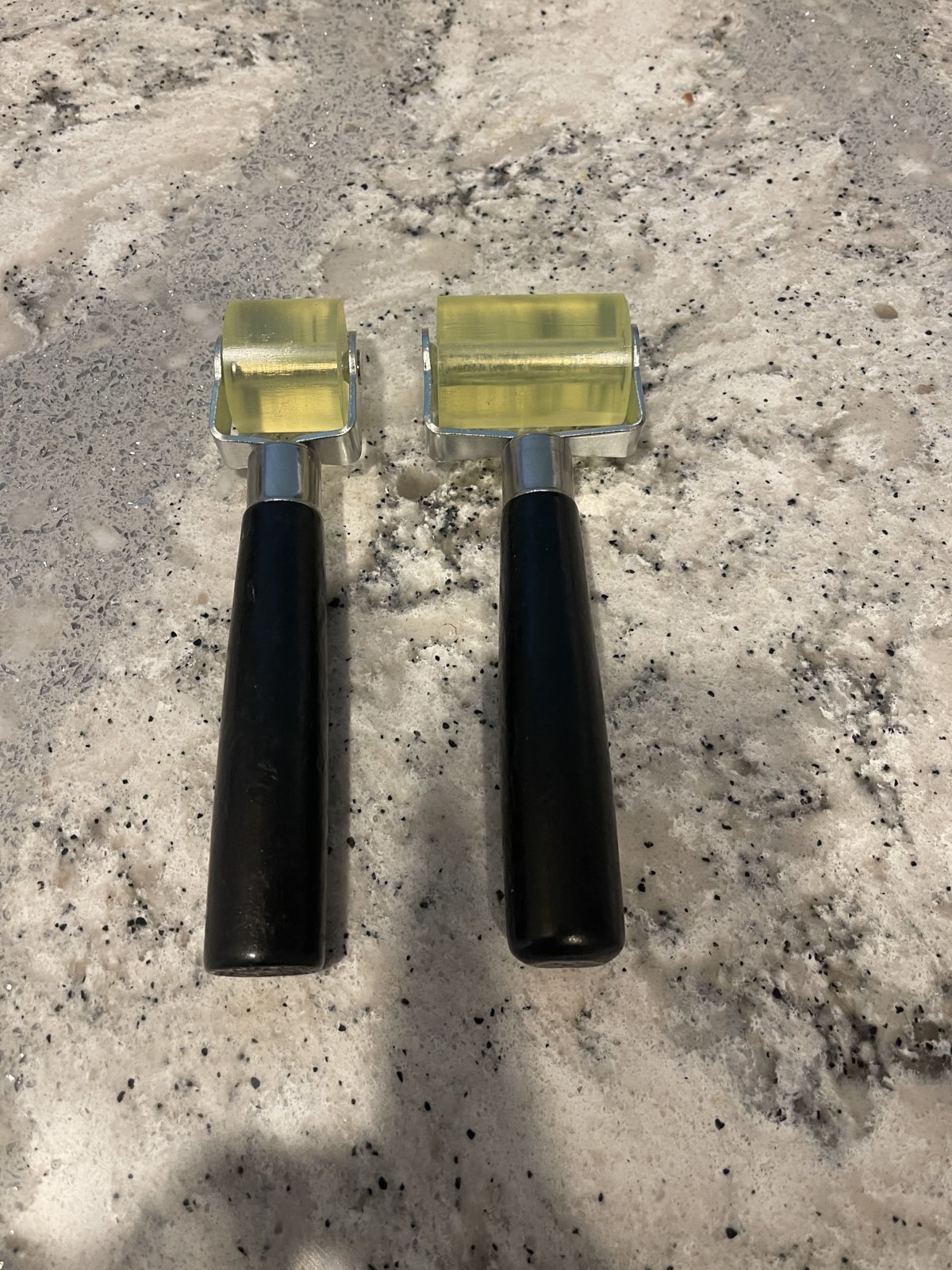

    I paid $4.78 for the pair of rollers with free shipping off of eBay, quality looks great actually.
    Looked today and the same link it’s $8… Go figure.
