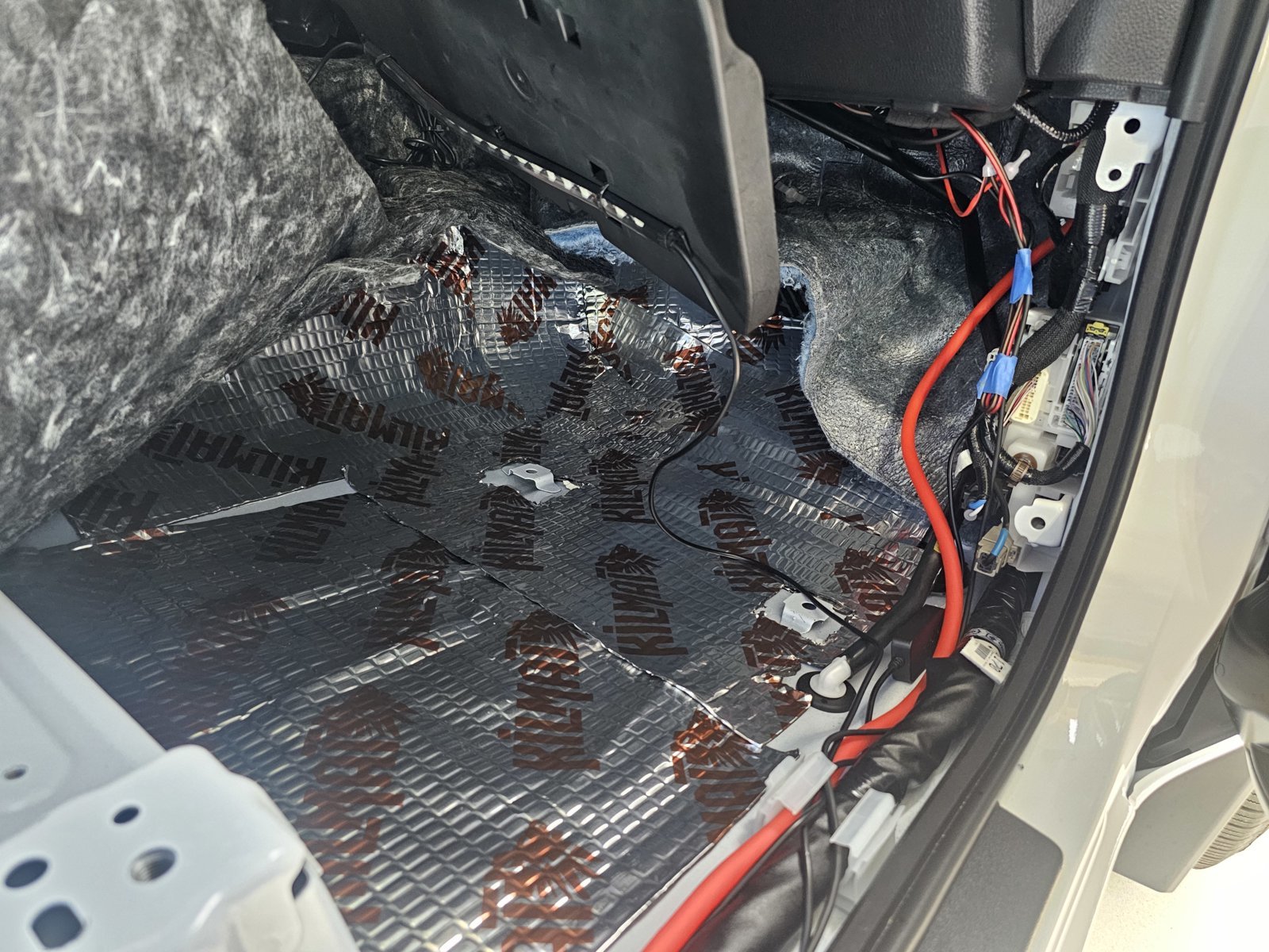

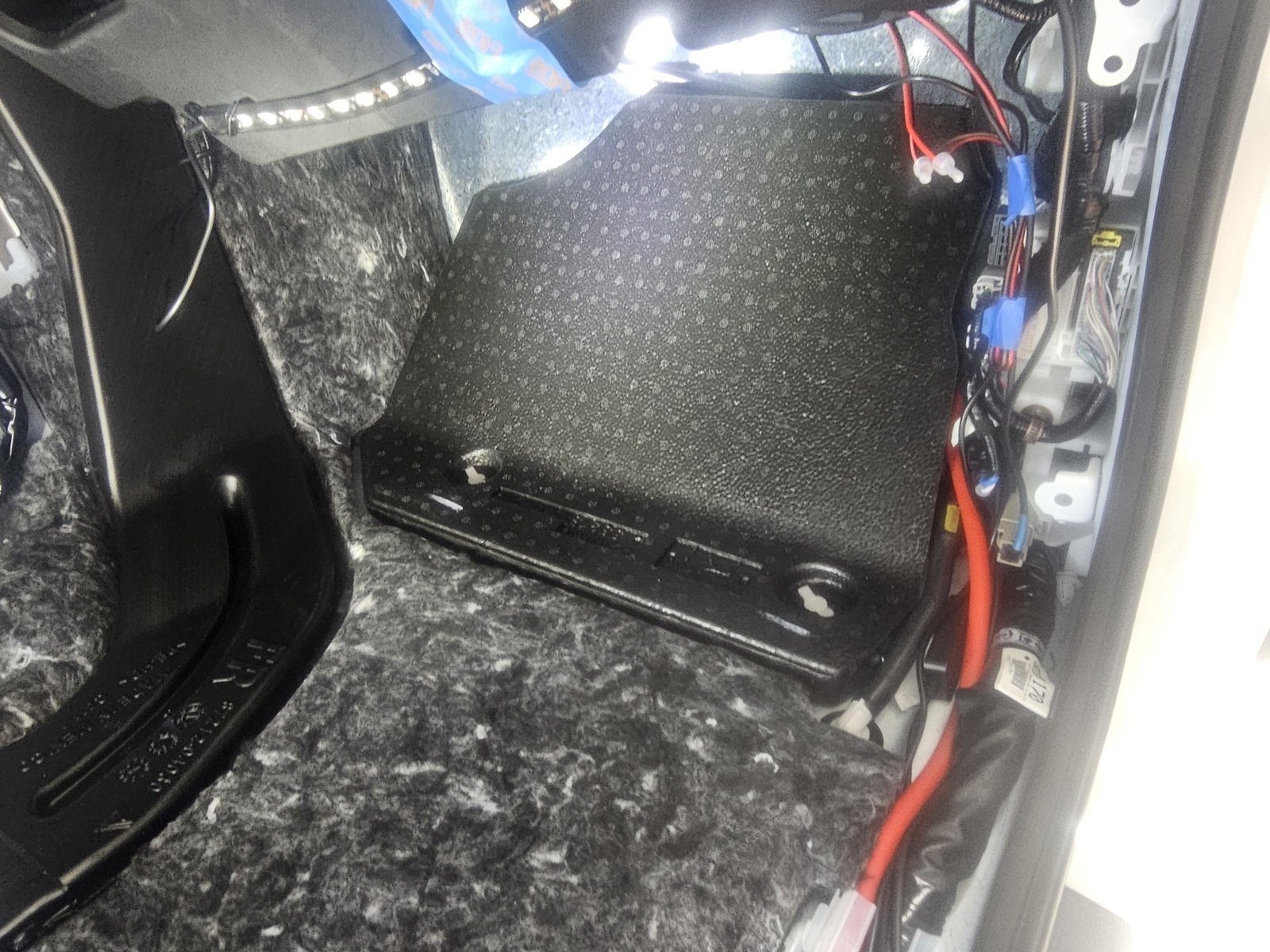

    Passenger floorboard matting is complete. Disassembly and reassembly was not too difficult.

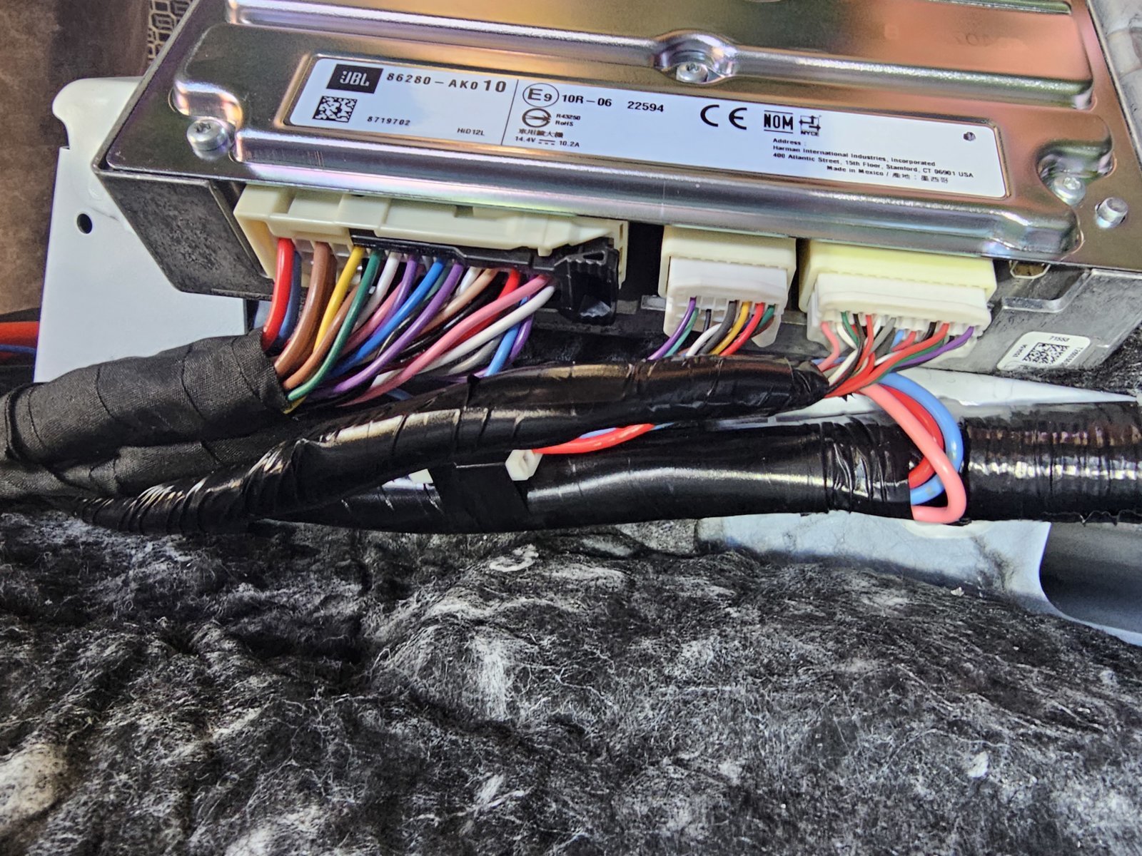

    Bob, where is the factory JBL amplifier located?
  6. May 19, 2024 at 2:05 PM
    #106
    BoBsworld21
    BoBsworld21 [OP] Well-Known Member
    Apr 13, 2024
    #447822
    61
    BoB
    2024 Tacoma Sport 4x4

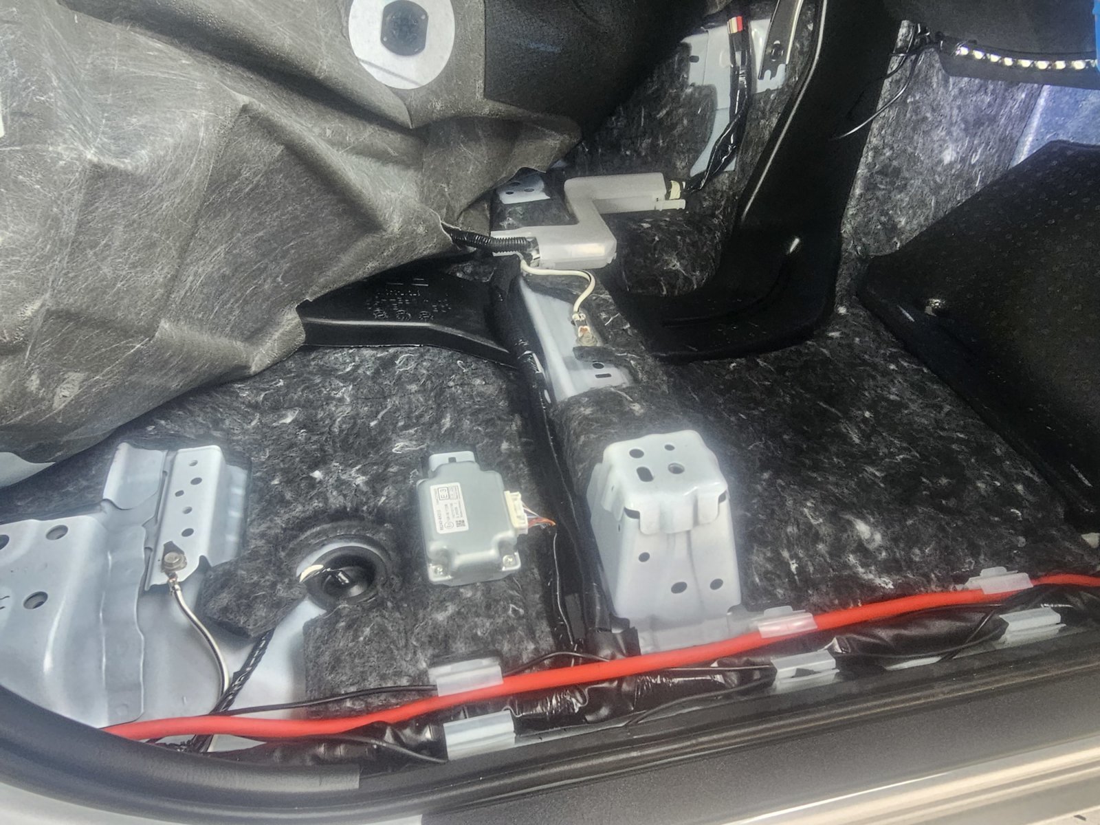

    The JBL is under the driver seat.
    I installed mine behind driver side rear seat, where the original sub was located.
  7. May 19, 2024 at 2:27 PM
    #107
    slater
    slater Well-Known Member
    Apr 16, 2024
    #448066
    2,799
    San Diego
    24 white Tacoma TRD Sport 2wd
    Got it, jbl factory sub is gone & you mounted the Jl audio amp behind the rear paneling at the factory sub location..
