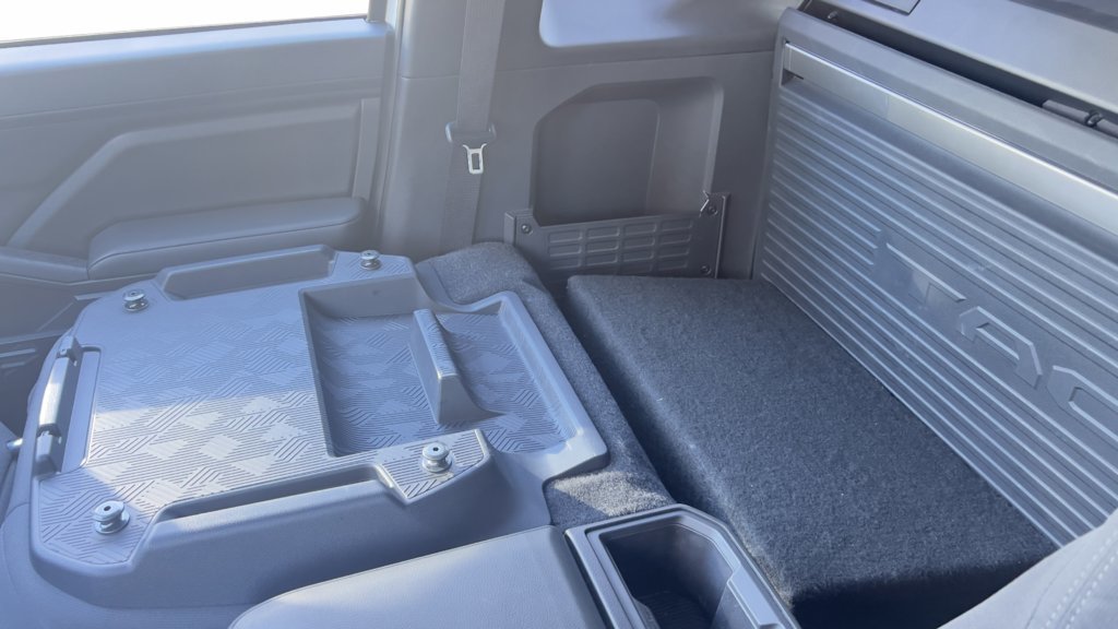

    21 SUPER WHITE TRD OR 4X4 , 24 BCM TRD OR

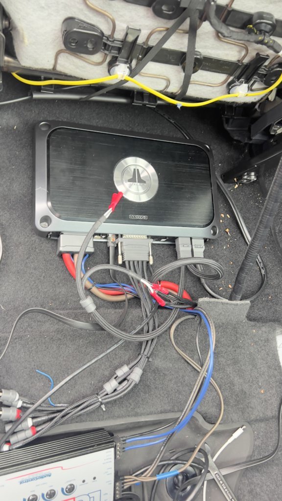

    I used the Infinity crossovers. I installed an JL amp and sub, unfortunately I am still waiting on hooking up the amp to the speakers.

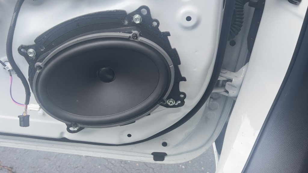

    Just got my truck with JBL yesterday. The only thing I'm not happy with is the speaker or door rattle up front. It's pretty consistent in low end/mid range. Do you think that's from speakers or panels? Did you notice this?
    I adjusted to a slightly more rear balance and dropped the mid and bass slightly and it seemed to help. I wish we had a true equalizer.

    I found this on FB, I am unsure if it is Sound Shaker. It appears to be pressed against the seat. Still looking for a Sub solution.

    Could be the way the speakers are mounted to the door. Perhaps some sound deadening material might help a bit too.

    This is my biggest complaint with the JBL as well after having the truck now for a couple of months. The front door panels vibrate a lot with the music. Only have to grab the door handle and it goes away, so I'm guessing its not anything more than just needing sound deadening material added to the door panel. If the system had some additional adjustments, I'd turn down the bass to the door speakers and turn up the sub a bit more to help with this.
    The pics posted in this thread are very helpful, as I'll look into doing the sound deadening sometime this summer.

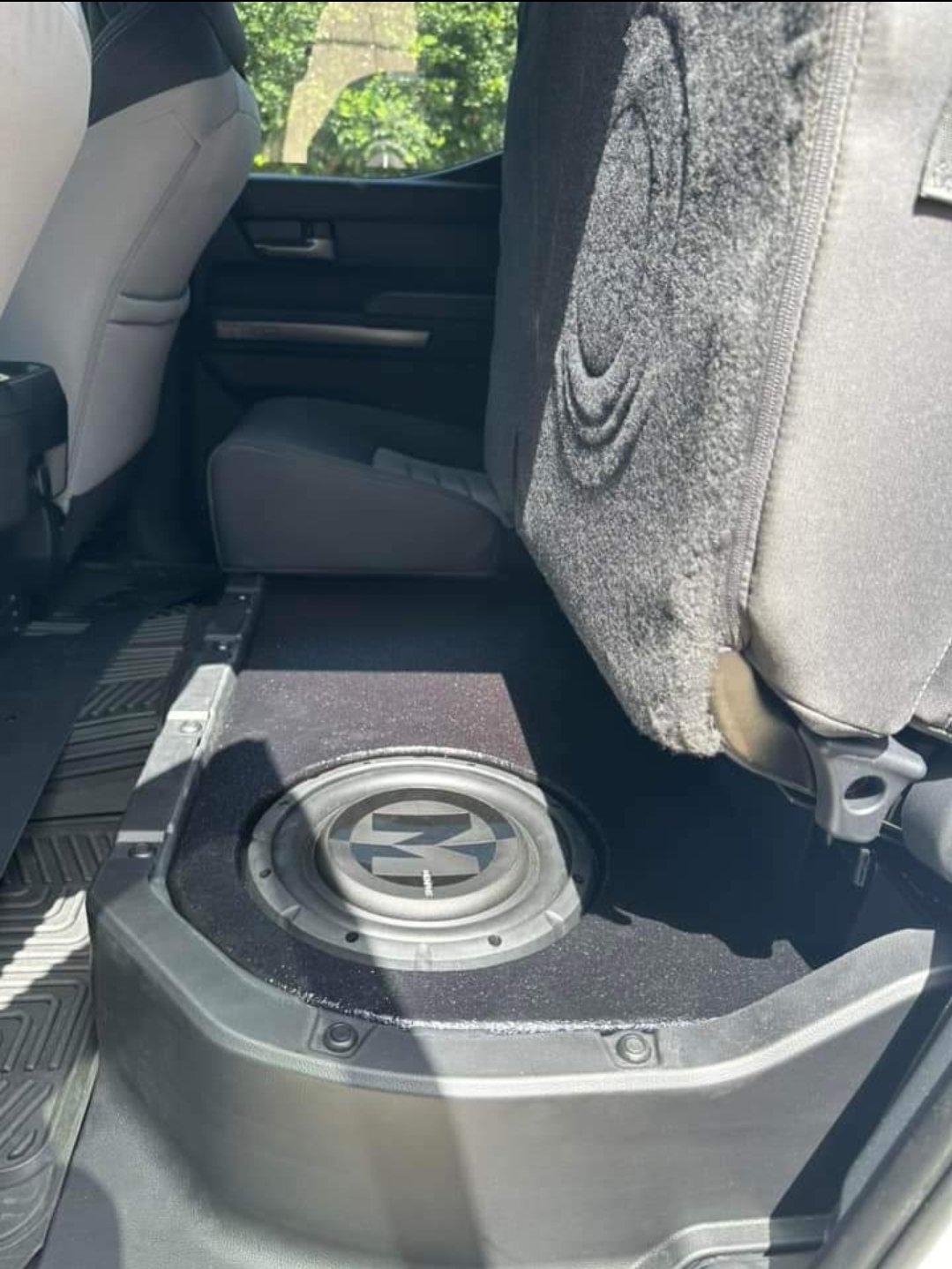

    Well I am looking for a pic of a JL powered sub—(SKU # ACP108LG-W3V3) installed under backseat or even behind backrests if anyone has done this or can recommend how to proceed. thanks

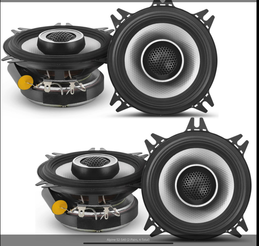

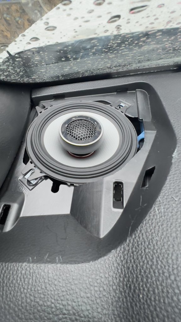

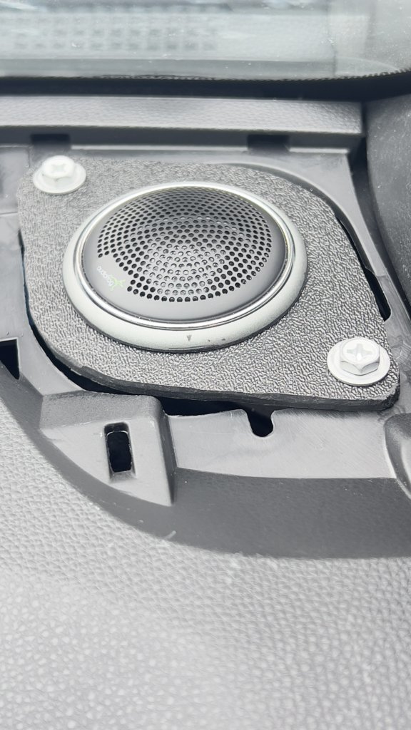

    So I installed a JL Audio VXI 1000/5 amp with Audiofrog GS 690 6x9s in front doors and GB15 tweeters on the dashboard.
    After the fact I tried the 4 inch Alpine type S Coaxials for the lack of other models available locally
    Surprisingly the 4 inch speakers just dropped in place so for all of you 4th gen owners upgrading front speakers I’m very satisfied with the front sound image with the added vocals. I am looking to upgrade to 4 inch Morels possibly 4 inch focal k power components are possibly my next option as a more refined speaker for the dashboard. The sub box is a custom build seating flat behind the passenger seat with a TW3 10 inch. And of course it bumps hard with within the 2 door cabin
