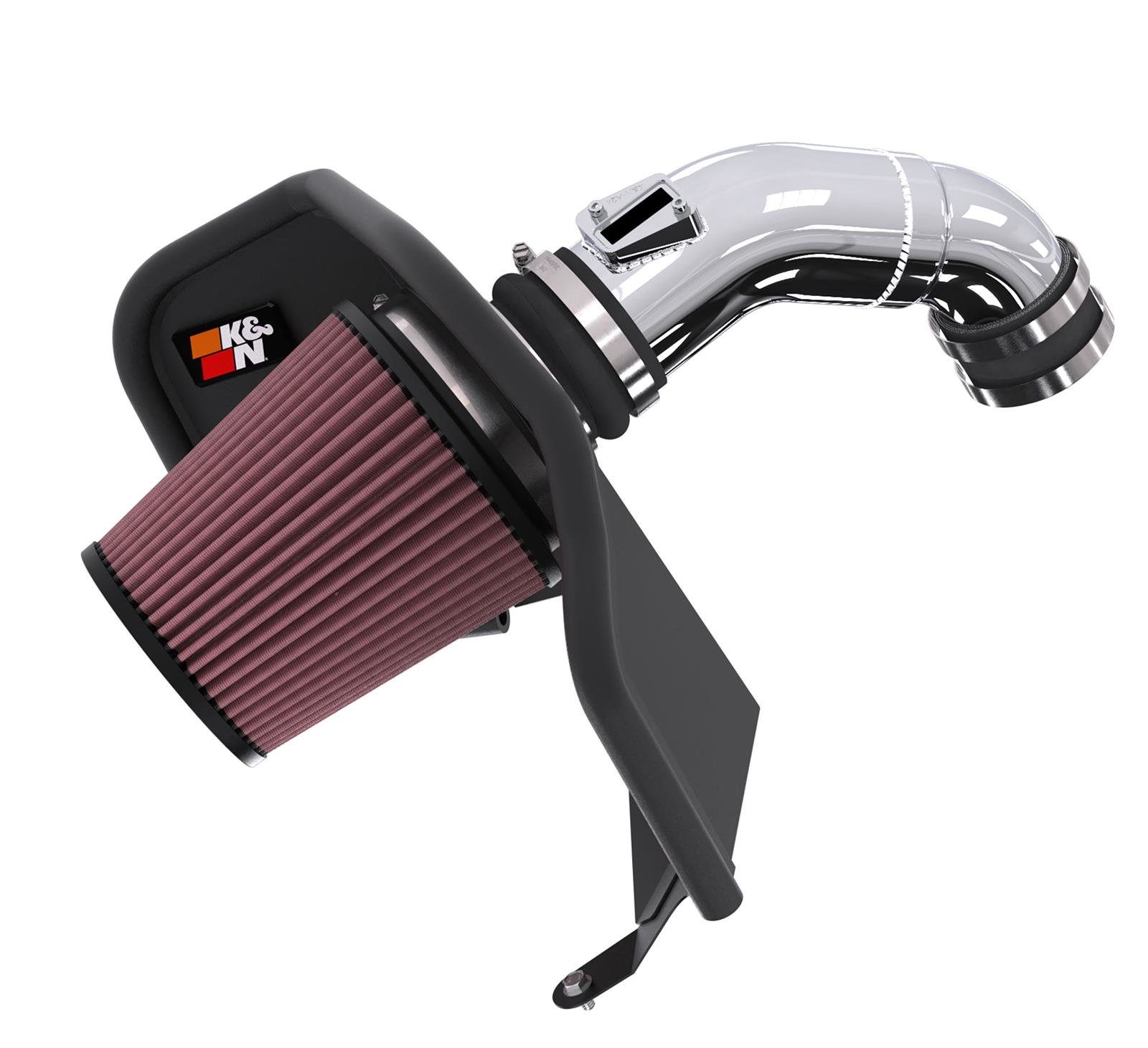

    Looks pretty cool! 15hp and 25 torques

    Even K&N isn't shipping yet
    https://www.knfilters.com/77-9043kp...ter-aluminum-tube-toyota-tacoma-l4-2-4l-turbo
    Install Instructions
    https://kandn.com/instructions/77-9043_inst.pdf
    Interesting that they leave the factory grille intake duct in place. Might not suck in as much hot air if you added more foam / rubber under the hood to isolate the entire filter surround to only pull in from the grille.
    I'll let one of you guys try it out first and report back your findings. :D
    The last time I installed one of these in a 2001 Corolla, it did provide a noticeable increase in pep, but it also placed the intake low into the wheel well. Got stuck at work one afternoon when the roads flooded after a heavy rain. Eventually got brave and followed my fellow sedans through the high water. Sucked water into the intake and flooded the engine. Had I stuck with the stock intake, would have never happened.

    It will suck warmer air vs the factory setup. I’m waiting for STILLEN or may just get the TRD box.

    I believe that's what is referred to as a hot air intake...:p:D

    Cant wait for all the " my turbo has failed" posts from ingesting dirt/dust.....And then the warranty denials from it...

    Yep less HP and less Torque when it’s sucking hot air..why do you think they put cold air intercoolers on turbo engines

    Your are absolutely correct... Nothing cold air about them. You will be sucking hot air from your engine compartment. K&N filters are great for external engine application. Sure, you can use them on standard vehicles, but I wouldn't, imho. If you run the pluming outside - say behind the grill, then go for it. Also, cleaning and re-oiling the filter should be done with care. Too much oil on the filter and you will compromise the mass air sensor. I've seen it happened. Not sure why Toyo would even recommend them for the TRD, just because of the cleaning process.

    And the MAF getting oiled, and that the intake air is already sent through the inter-cooler, and a little dust never hurt anything but I digress...
